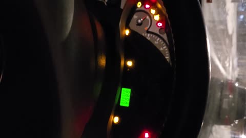

My car had no problems beforehand, there were no check engine lights, strange noises, or smells. All of the electrical components were working as usual. After temperatures dropped it wouldn't start. It only makes the cranking noise as if it's about to start. The dashboard lights are on while it's trying to start. I changed the battery because the old one was badly corroded. The auto parts guy is recommending I change out the negative terminal then check if the starter, or alternator is having any issues. A friend of mine thinks it's an issue with the timing belt.

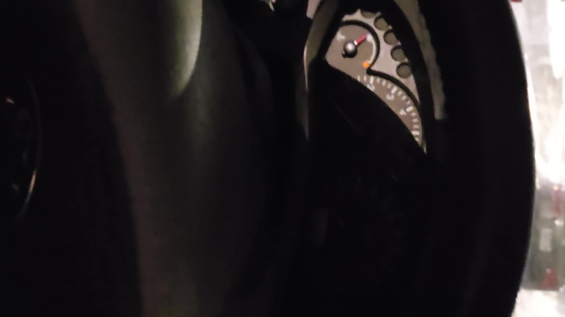

Here's a video of what it sounds like.
Jan 11, 2025 at 9:22 AM
  • 54,503 POSTS
Thanks for the video, yep, the engine sounds like it is hurt. This car has a timing chain so no belt, I would do a compression test to make sure the engine compression is to blame, can I ask if the engine has been overheated? This guide can help confirm the issue:
Please go over this video as well:
https://www.youtube.com/watch?v=lXLJbuAZ4CE&t
Please go over these guides and get back to us. Thanks for the video, it helps.
