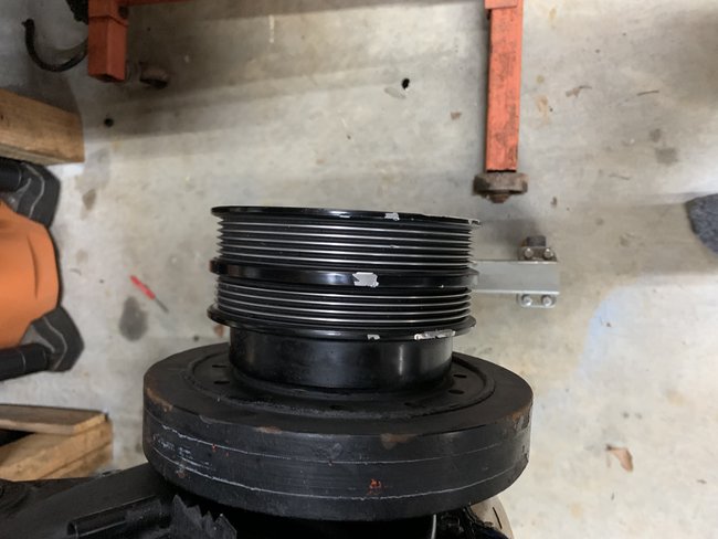

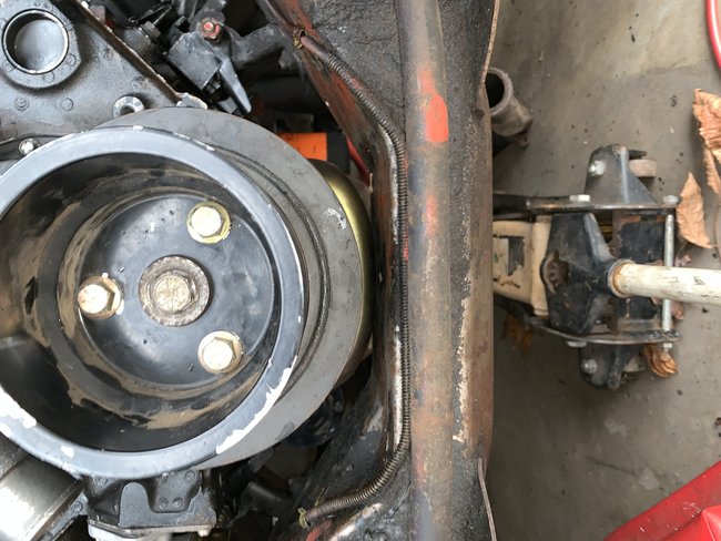

As you can see this engine has a double groove pulley, does that mean it came out of a vehicle with power steering, and if so what all do I need to put power steering on it
Sunday, January 27th, 2019 AT 10:43 AM
No, not at all. You can leave it like this and just not use that part of the pulley.

And if I were to put power steering on it what all do I need to do it, just the pump or?
Sunday, January 27th, 2019 AT 4:14 PM
You need to install the pump, hoses and another steering box.

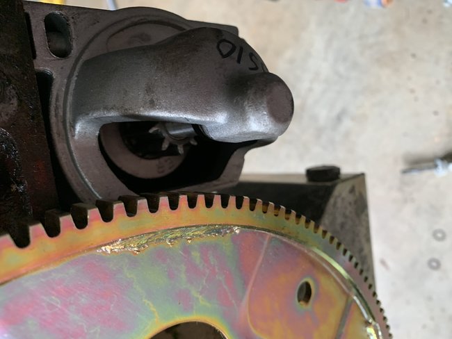

I’m pretty sure I need to buy a bigger flex plate, but was just going to make sure if this one would work or not because I have searched everywhere and I can’t find a perfect fit.
Wednesday, February 6th, 2019 AT 12:38 PM
What about the old one on the old engine?
Wednesday, February 6th, 2019 AT 1:44 PM
DALTON SIGMON
  • 33 POSTS
Too small.
Wednesday, February 6th, 2019 AT 2:40 PM
What year was the donor motor?
Wednesday, February 6th, 2019 AT 2:46 PM
DALTON SIGMON
  • 33 POSTS
Not sure.
Wednesday, February 6th, 2019 AT 3:33 PM
DALTON SIGMON
  • 33 POSTS
I think I found one for it.
Wednesday, February 6th, 2019 AT 3:34 PM
Okay, If you can find out what year it came from, I might be able to help you find one.

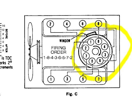

How do I set the park plugs?
Saturday, February 9th, 2019 AT 1:24 PM
DALTON SIGMON
  • 33 POSTS
The wires specifically.
The plugs gt gaped at.035. Use a spark plug gapper.
Wires and the cap setting attached.
Saturday, February 9th, 2019 AT 1:31 PM

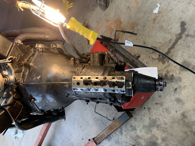

Might be a long shot but I’m putting this 350 turbo transmission on but don’t know anything about the linkages. Is there anything I need to buy new? Not sure what the old transmission was but I know the dipstick doesn’t fit.
Saturday, February 9th, 2019 AT 2:34 PM
You had a powerglide.
You now have the turbo 350.
You need the correct dipstick for that transmission.
Saturday, February 9th, 2019 AT 3:14 PM

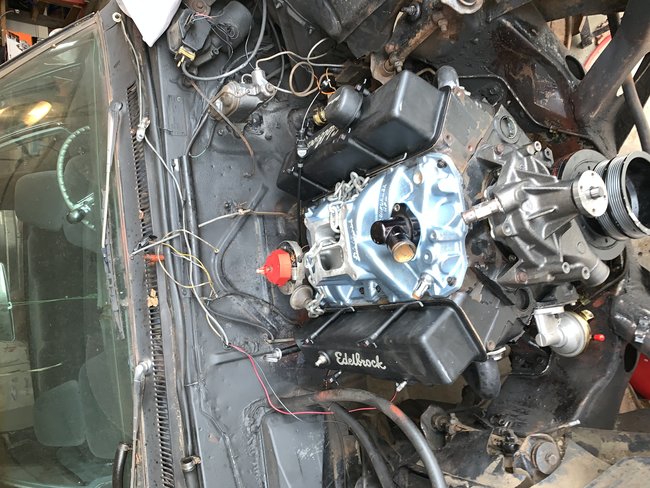

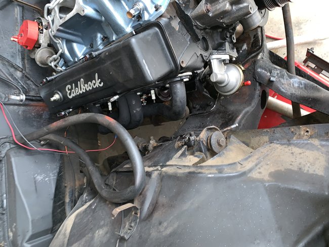

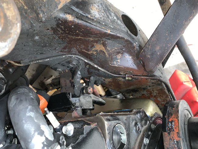

I don’t think it’s just me but it looks as if my engine is sitting too low, what should I do about this?
Thursday, February 28th, 2019 AT 7:39 PM
From your pictures, it all looks good.
Friday, March 1st, 2019 AT 2:19 AM
