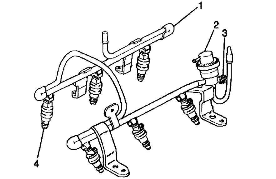

Driving down road and engine shut off. Thought it was out of gas. Put gas in car would not start. Towed home. Next morning car started with no problem but when running at higher RPM engine surges.

1. Fuel pressure. you can check the actual pressure at the valve right by the power steering pump. Check the pressure key on, engine off and while cranking. It is number 3 in the picture below.
2. catalytic converter. it may be clogged. This is a common reason for hard start and not going above certain RPM and speed.
You need a back pressure gauge that goes into where the upstream O2 sensor is located. You start the engine and measure the back pressure. If it is above 1.5 lbs, it is no good.
