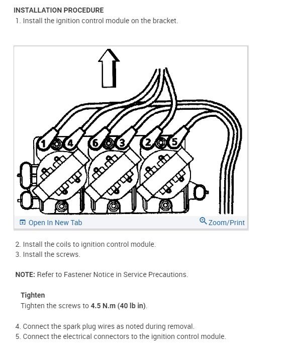

I put it in neutral and it starts right up again.
Tuesday, March 15th, 2022 AT 8:39 PM
MECHANIC
52,796 POSTS
Good morning,

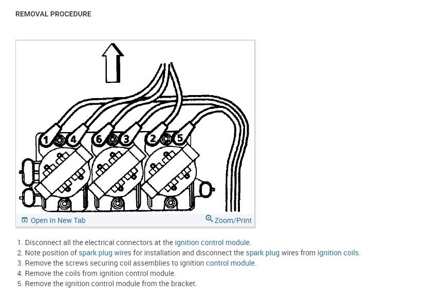

I would suspect the ignition control module. It was a common failure for just this issue.
https://www.2carpros.com/articles/engine-stalls
It is located under the coils. I would also replace the coils while you are there.
