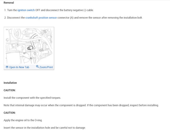

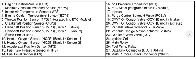

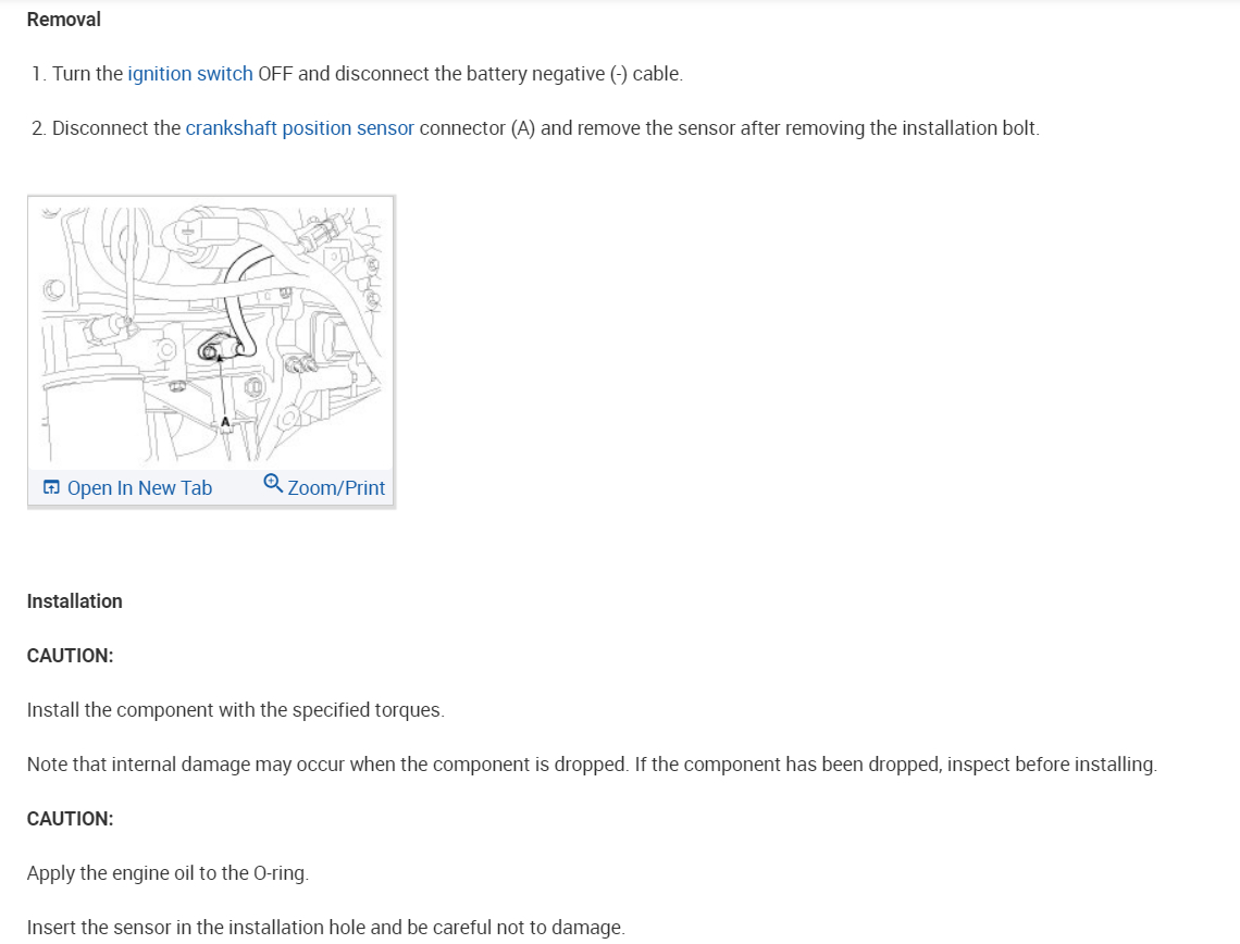

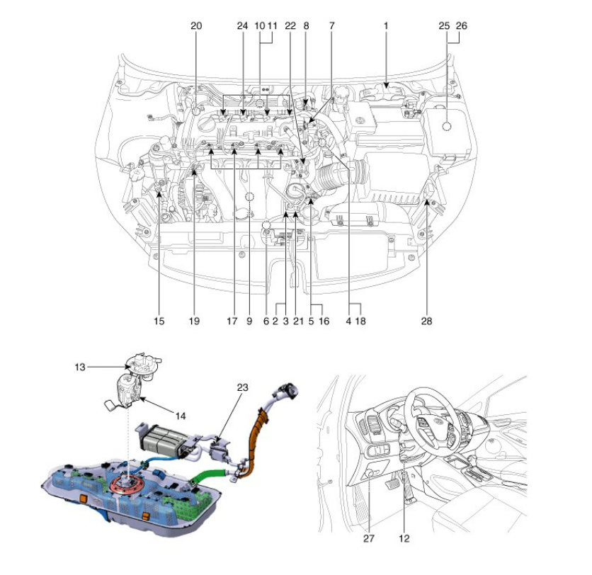

These kinds of problems can be tough to find, but I will guide you in the most popular causes. I have seen the crankshaft position sensor cause this issue, and when it fails it won't leave a trouble code. The sensor failure just tells the computer the engine is not turning anymore and then the computer shuts the fuel off as a normal safety precaution. Check out the diagrams (below). Please let us know what happens.

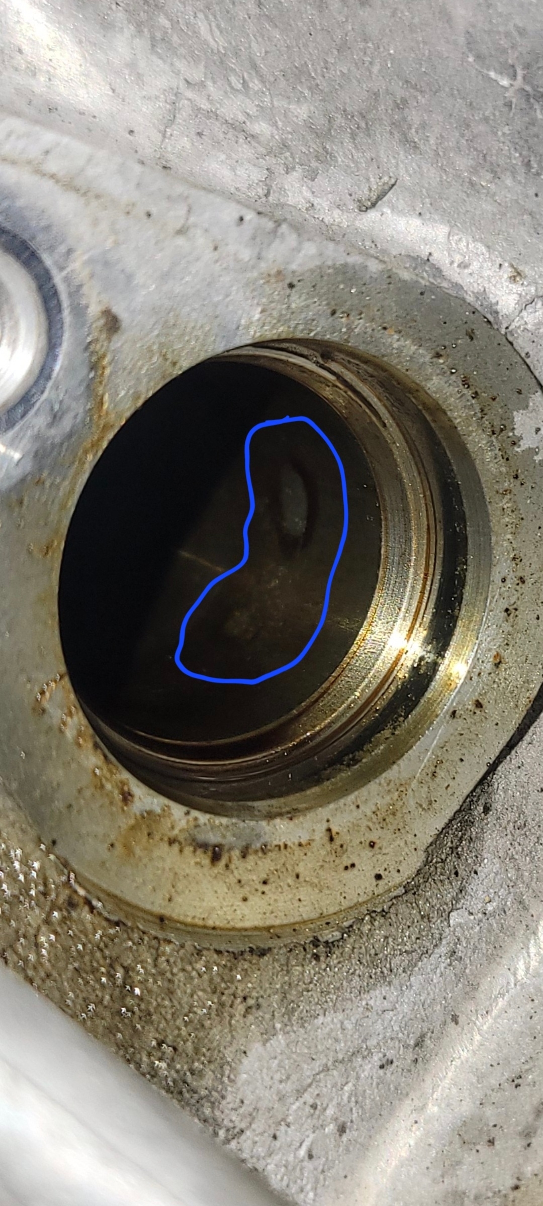

The sensor finally arrived. I found a little time to get it replaced yesterday. The car started and ran to the store fine. The real test will be today when I drive home from work. I'll give it a week and report back if this has resolved the problem. In the meantime, when I took out the old sensor, I noticed these worn spots (see picture) on the metal hole that it goes into. The sensor wasn't loose when I removed it and I didn't see any damage to the sensor or debris in the hole. I'm just including this in case it might be relevant.

The marks are a non issues, let me know what happens.

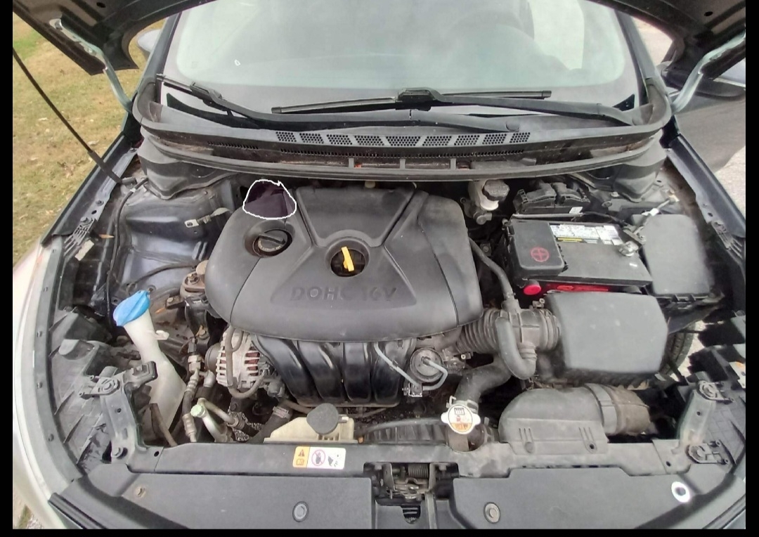

Look, I had this same exact problem 2015 Kia Forte. Just unplug this solenoid/sensor from behind the valve cover. Took a long time to find this out for me. It will make your check engine light come on and put your timing into default mode. I can give more information if you're curious. You do not have to take the cover off, it is just something to unplug right behind the valve cover, spot circled in picture. It took a lot of time and trying to fix random things. Not one single feed had the answer for me. We had to find this with an expert Mechanic in person.

Basically, if I keep that unplugged, my timing is in default. It makes me have a check engine light on instead. When I plug that in, the vehicle starts cutting off again. Apparently, there is a pin that the camshaft likes to rotate and set itself onto. The pin has been sheared off and when the camshaft tries to rotate over to rest on the pin, it shuts the vehicle off due to not properly being able to do so. Once you unplug that sensor, it puts the timing in default mode with no random camshaft movements. This narrows it down to a timing issue/internal engine issue. This is simply a bypass that works and isn't necessarily a repair. In fact, I believe and am suspicious that if I used a higher viscous oil, maybe 5w-30, synthetic, it would actually keep it from cutting off. Since I have this bypass by unplugging that solenoid/sensor, I might quit looking.

In my photo above, I circled where it is. It's exactly that location. No need to even take valve cover off. It is a plug right behind it where I circled. It can't be missed. It's against the back of the cover where I circled and is just as simple as unplugging a sensor. There is no danger in it, as it puts the timing in default mode without using all the fancy timing pulses. I believe what is being unplugged is a valve timing solenoid.

Okay, thanks for the information. Remember my suggestion is here if it begins doing it again. I have a 2015 kia forte with 89,000 miles. It would cut off coasting to a stop and eventually got way worse before I found out I needed to unplug that sensor, that's barely out of sight where I circled in the picture. I wish mine would quit acting up like yours did. Strange how random it is! One thing is for certain for me, with that valve timing sensor/solenoid unplugged, it runs in default mode and absolutely never cuts off for me. This unplugged does force a check engine light because a sensor is literally unplugged, but it runs healthier since it's not putting itself in situations to do a safety cut off.
