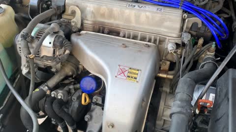

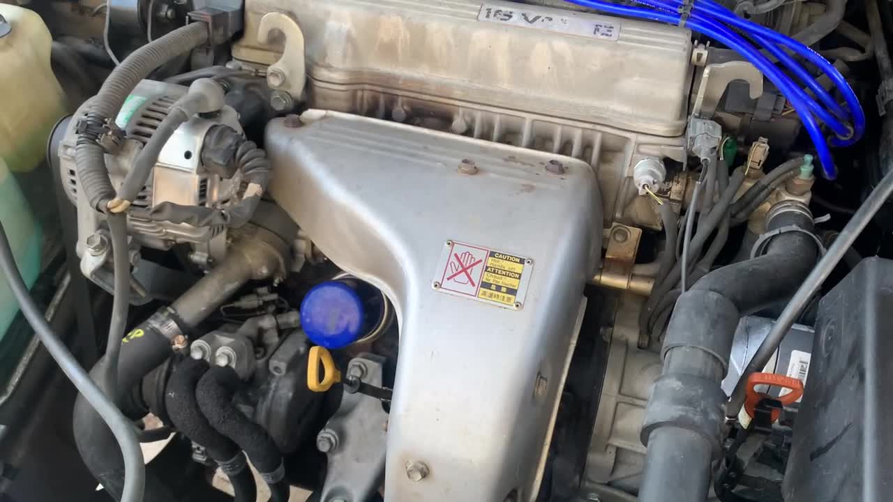

Hello, does anyone have any idea why my engine is sputtering like this? I’ve attached a video for reference. The car has new spark plugs, so I don’t think it would be that. Any and all help is greatly appreciated!

That could be the result of a few things. First, an engine vacuum leak can cause a rough idle. Here is a link that explains how to test for one:
Next, if it is the idle speed changing, that could be related to the idle air control valve. That is what controls the idle speed.
Let me know if it is the idle speed changing so I know how to direct you. Also, I would like you to scan it for codes. You don't need a scan tool on this vehicle. Here is a link that explains how to retrieve codes:

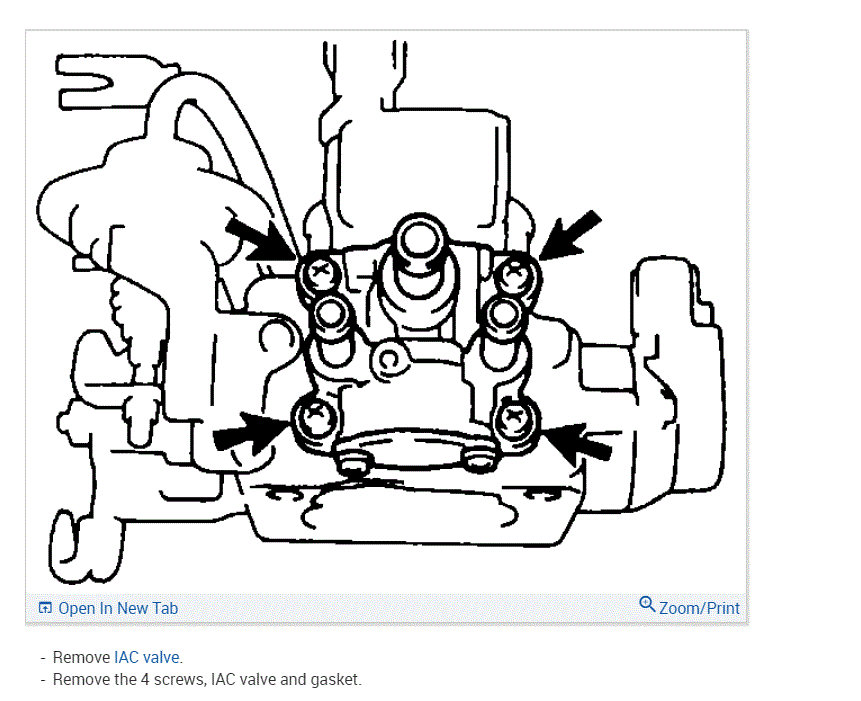

If not, do that. If there are none and it is the RPMs changing, we should at least try to service the idle air control valve (IAC). Here is a link that explains how it's done:
https://www.2carpros.com/articles/idle-air-control-valve-service
Before you remove the IAC, please confirm there are no vacuum leaks. To remove the IAC on this requires the removal of the throttle body, draining the coolant, and so on. I don't want you to go through that unless we are confident it's needed.
Here is a pic of the IAC on your vehicle. Again, it's under the throttle body.
Let me know what you find.
Take care and I'll watch for your response.
See pic below.

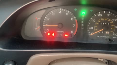

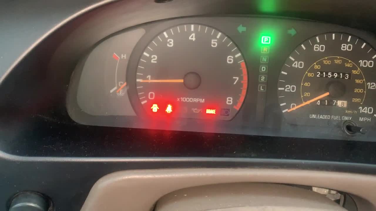

I check it when it’s cold and the ATF level is at the cold mark on the dipstick. I'm reluctant to drive this car until I get this issue fixed because I don’t want to cause any damage. I attached a video of the RPMs…the needle is slightly moving but hovering around 1000 RPMs. Is that considered the idle speed increasing or decreasing? It doesn’t look like it’s really increasing or decreasing to me but maybe it is. What do you think?
Jan 26, 2022 at 4:16 PM
  • CAR REPAIR CONTRIBUTOR
  • 110,193 POSTS
I watched your video. It's moving slightly, but nothing I consider odd. Also, as long as the engine was running when you checked the fluid, that's fine.
