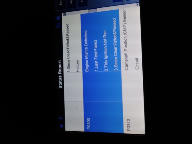

Yesterday my truck started running rough, the engine is sputtering, has lack of power, and my check engine started flashing. I hooked up the OBD2 we have at work and got these codes P1072, P0300, P0340, P0442, P0128. I was hoping it was only a coil pack, but the scanner didn't give me a specific cylinder. Any chance you guys might know what the problem could be?

The 300 is multiple misfires on all cylinders. I would start by checking the fuel pressure. Low fuel pressure is the most common reason for this code.

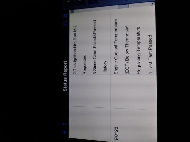

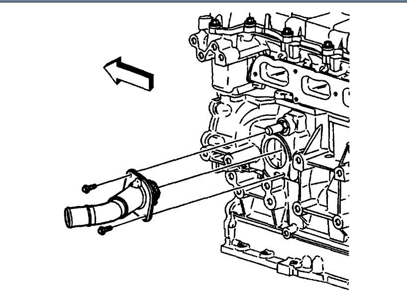

128 is a thermostat. The engine is not running at the desired temperature from the thermostat staying open.

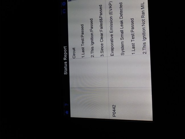

442 Is an evaporative code for the emission system. The purge valve is the most common failure for this.

340 is for cam sensor circuit.
P0340
Descriptor
Probable Causes
Cam Position Sensor (CMP)
Cam Position Sensor (CMP) Foreign Material
Cam Position Sensor (CMP) Improper Installation
Camshaft Reluctor Wheel
Powertrain Control Module (PCM)

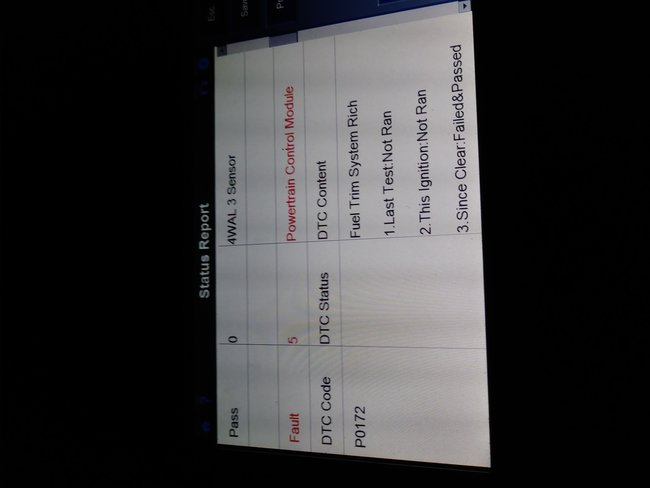

It is 0172. Sorry my mistake.

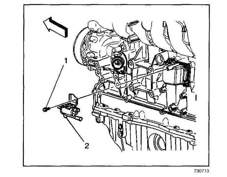

What are the pictures you sent for?
Wednesday, July 31st, 2019 AT 10:42 AM
The pictures are for the thermostat for the 128 code.

The 1072 code was a typo its actually 0172.
Thursday, August 1st, 2019 AT 12:21 AM
Okay, that is from the misfires. That is a rich running code. When the 300 is repaired, that code will go away.
