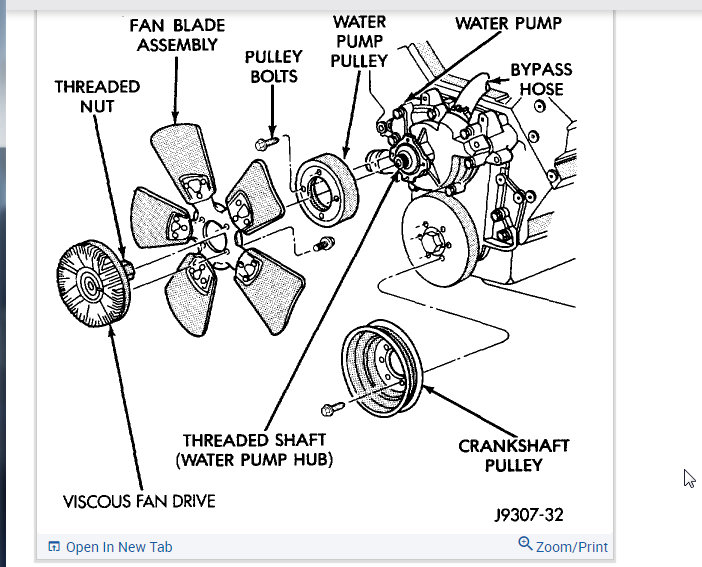

Just purchased an infrared thermometer today, and came to top heater hose 130, head was 160. The heater does put out warm air, when I back flushed it, it got a little better, didn't think of getting temperature of air coming out. It is hotter then body temperature.
I've been thinking the clutch fan, maybe cooling engine down, so it doesn't get hot. Is this possible? I can turn fan went cold, before I start with a little amount of pressure.
Saturday, December 12th, 2020 AT 9:11 PM
Okay. That is great. Can you tell us if the fan is running constantly? You are correct that a fan running all the time will keep the temperature down. It should not turn on until the engine is warm or the A/C is on. Is there a roaring noise when the engine is running? You have what is called a viscous fan clutch which means it should only be engaged when the temperature is high enough so if it is running when the engine is cold then you need to replace it.
Here is a guide that helps with this:
https://www.2carpros.com/articles/fan-clutch-symptoms
Let us know. Thanks
