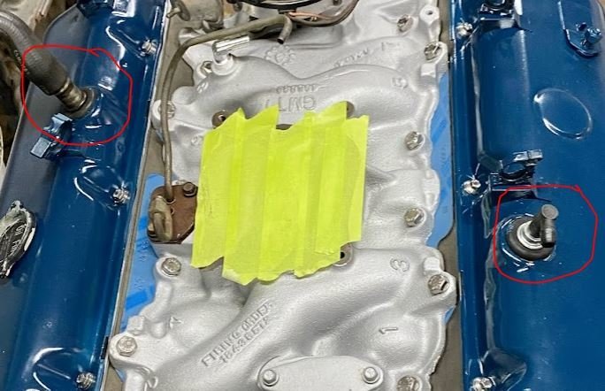

Regarding the emissions air injection tubes for the exhaust manifolds: I can find the tubes online to buy, but I cannot find the extension tubes that connected to the air tubes and went directly inside the manifolds. Do I need those extensions, or just the main air tubes as shown in my earlier pics of the exhaust manifolds? The pics I posted earlier show the extender tubes in question.
Tuesday, May 4th, 2021 AT 12:08 PM
If you are planning on the system working correctly, you will need the extenders.

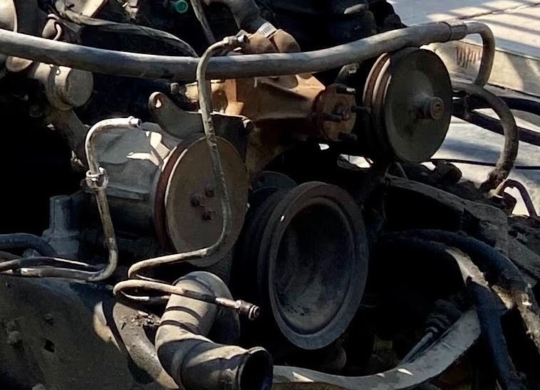

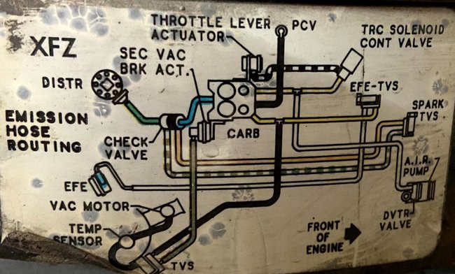

Can you tell me what the small pulley is used for, to the left of the water pump? Is that the 'air compressor' for the exhaust air system? Or something else?
Wednesday, June 2nd, 2021 AT 12:50 PM
That is the air pump.
You will be removing that and not using it since you eliminated the parts in the exhaust manifold.

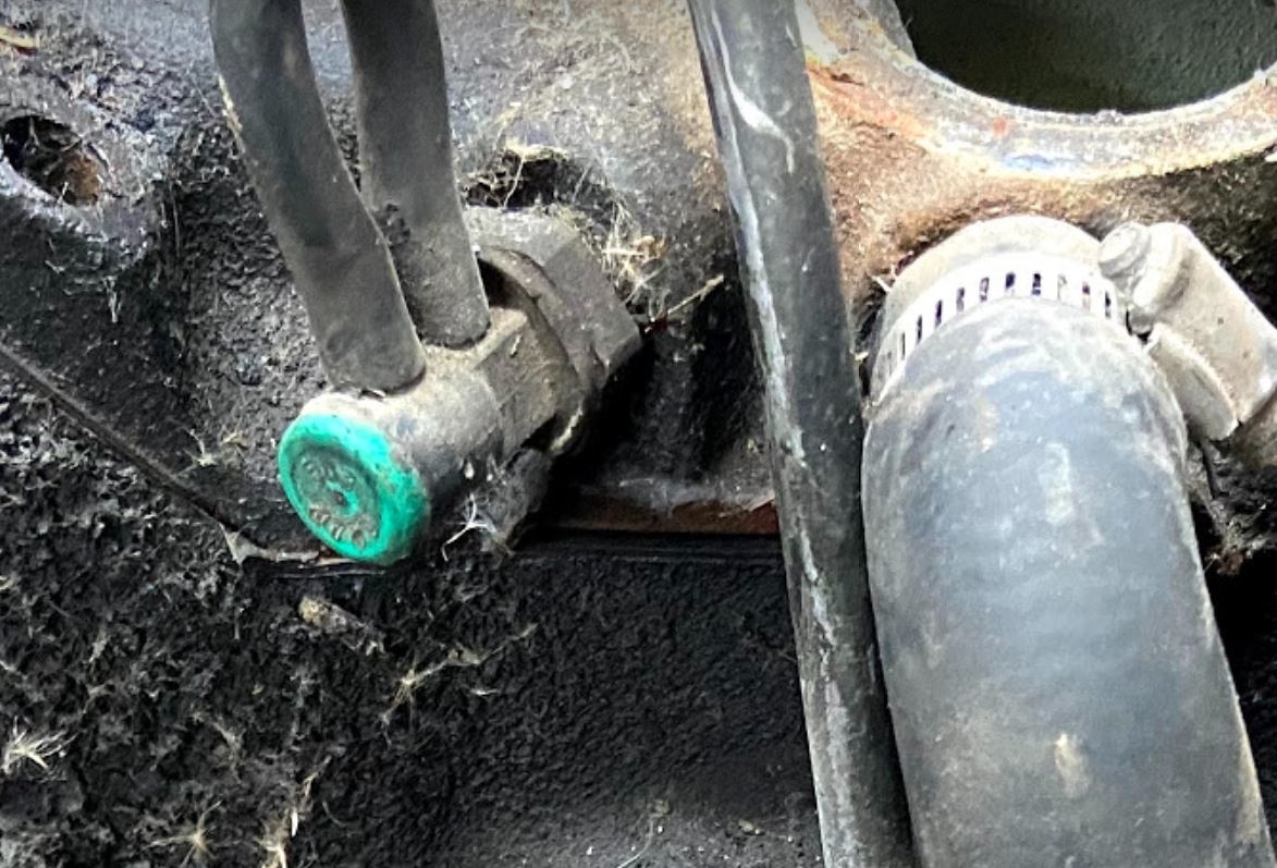

Any idea what this vacuum part is? It's on the intake manifold, right next to the thermostat. Obviously the tubing is wrong, but I'm trying to find out what it is, and if I need to replace it.
Monday, June 14th, 2021 AT 12:13 PM
That is a thermostatic switch. There is a vacuum on one side all the time but will only pass a vacuum when it reaches a certain temperature.
They used it for 2 reasons. It was for the EGR valve if it has one. It also controls the vacuum advance for the distributor if it has one.

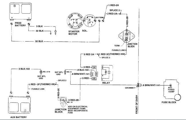

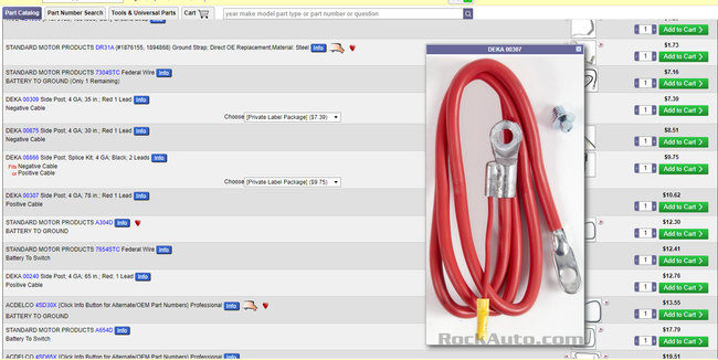

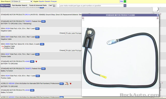

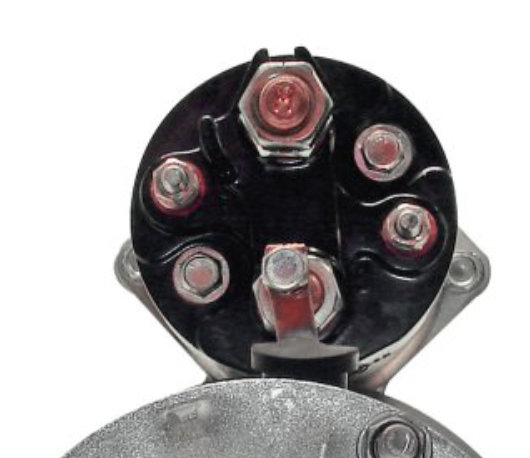

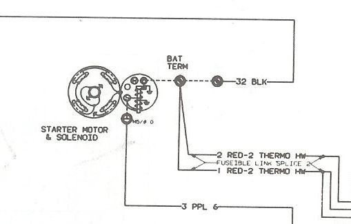

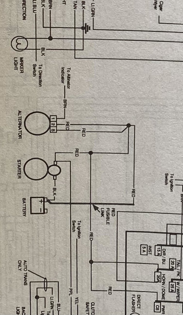

Battery/power/ground cables.I need to replace mine on the truck. Can you give me an idea of what, how many, how long, gauge, etc?
Friday, July 2nd, 2021 AT 9:23 AM
Okay, I attached the battery cables below for you. It lists the length, gauge and it has the ends already installed.
You have 2 cables. You can get them at a parts store if you do not want to get them from a parts store.
+1
Friday, July 2nd, 2021 AT 1:14 PM

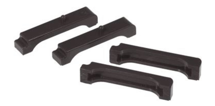

The radiator we pulled out was a 4-row core; LMC says I need a 1-row core. Should I replace what I had, or get the cheaper, less-core, unit? Any pros/cons?
Thursday, July 8th, 2021 AT 4:40 PM
Leave that one in there. It gives extra cooling to the system. No harm in added cores at all.

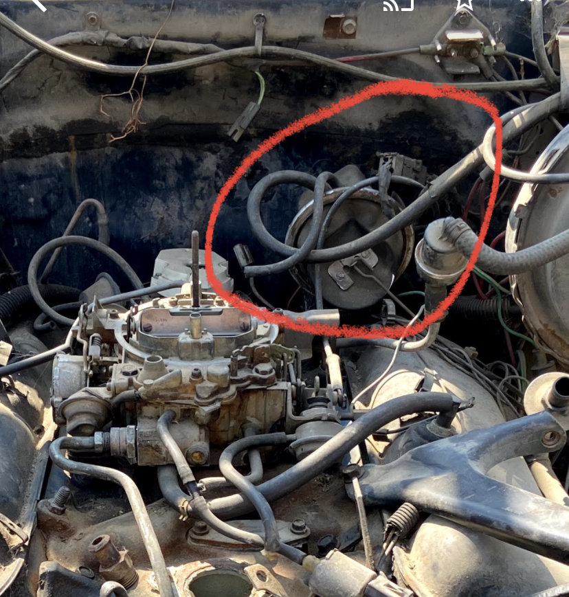

Can you tell me what this part is? It seems like some sort of vacuum thing..?
Thursday, July 22nd, 2021 AT 6:14 PM
It is for the cruise comtrol. Vacuum is applied and it pulls on the throttle to adjust vehicle speed.
