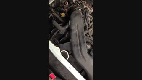

When I press on the acceleration it sputters a lot. Almost like it is going to stall, but not quite.
Really bad when just starting out, or going up hill. Seems alright once I hit about fifty mph (eighty kph).
I have included a video.

Nice work on the video it the only way to go. It looks like the engine needs a set of spark plugs to start off. Here is a guide to help you with that:
https://www.2carpros.com/articles/how-to-change-spark-plugs
If the plugs are new already the next please I would go is the fuel pressure. Here is a guide to help you with that as well:
Lastly, I would check the exhaust to see if it is plugged not allowing the exhaust to exit the engine. Here is a guide to help you confirm:
Please run down these guides and report back
