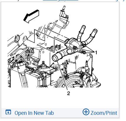

If the engine overheats in the first 15 minutes of driving, then I would suspect the thermostat. Here is the location so you can check it out. Check out the images (below). Please let us know what happens.

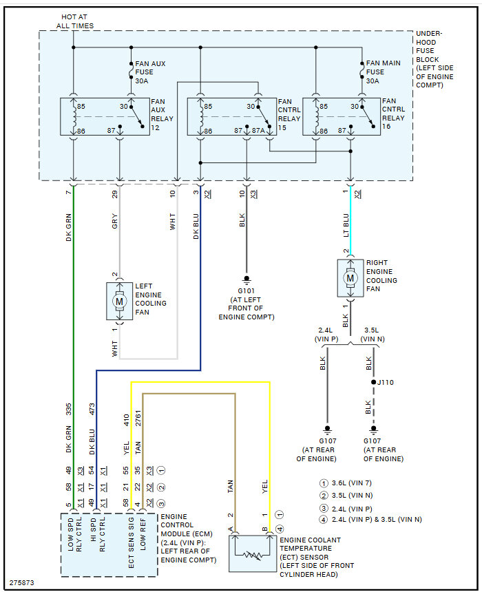

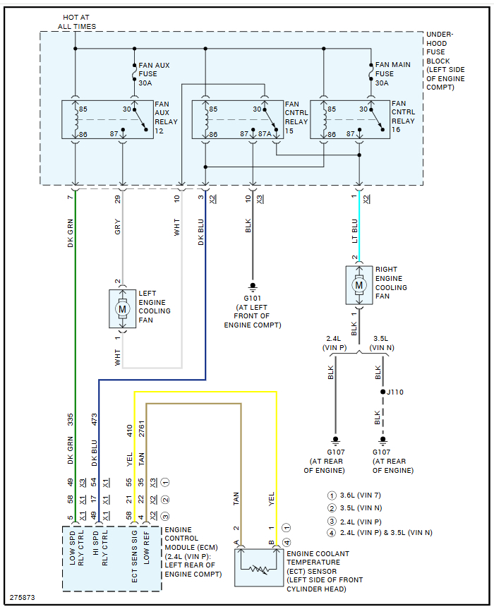

Here is the wiring diagrams for the radiator cooling fans, I would swap the relays out one at a time to see if that is the problem. Check out the images (below). Please let us know what happens.

Gotcha, Remove the electrical connector from the right fan motor and check the black wire. Let me know.
Wednesday, April 30th, 2025 AT 11:04 AM
CHARLIE SANDOVAL
  • 8 POSTS
No ground to the Right fan connector, had ground to the left fan connector.
