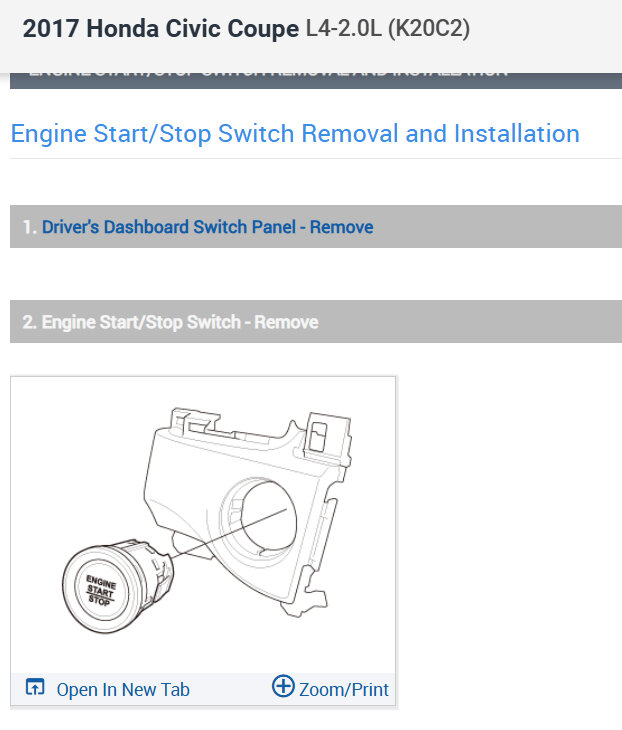

Unable to start a vehicle on push button start. It is showing green color key symbol on display. Key batteries have recently changed so there is no issue with it. Also, the car battery is 2 years old, and voltage is correct. I want to know what would be an approximate max. cost in any scenario.

Can I ask if the security light is flashing? If not, I have seen the push button itself go bad. I assume you tried both remotes? Also, I have seen a hard system reboot fix this kind of issue, this guide can show you how:
https://www.2carpros.com/articles/step-by-step-guide-performing-a-hard-system-reboot-for-your-vehicles-electronics-systems
It also can be the starter motor or a bad gear range sensor. please go over this video to help as well:
https://www.youtube.com/watch?v=6YRW8fyNudY
Here is how to change out the push button in case you need it, as far as cost goes it can range from $200.00 to $800.00 depending on the issue but I can help narrow it down with more information. The start switch button looks pretty easy. Check out the images (below). Please upload pictures or videos in your response of any problems so we can see what to help you with.
