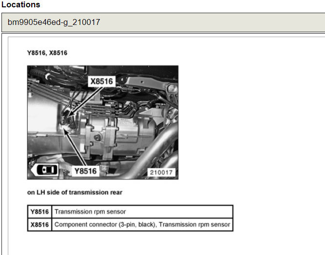

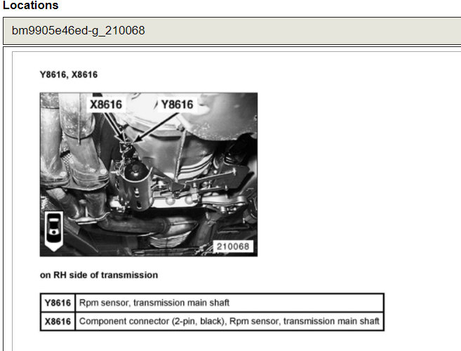

These codes can be caused by a shaft speed sensor that is out of range. Here are the sensors locations. I would try the sensors first

LIAM MCCAULEY
Is this for the manual gearbox?

Thanks for the reply! Yes I am sure it is u0303, but like you said it is not four wheel drive. Possibly maybe the code reader I am using? It is more of an engine misfire so it sounds as though it could be p0303.

KEN L
  • MASTER CERTIFIED MECHANIC
  • 55,522 POSTS
My bad, I did not see the transmission type. I would go with what Steve W. Has suggested.
