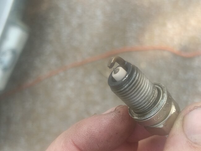

My evidence of no spark is based on 2 information sources 1) a consistent p0304 fault code,
2) this picture
https://photos.app.goo.gl/cRMDu1by9Ges15Pk6
The engine has run quite a bit. I have pulled the #4 plug more than once but 2 mornings ago when I checked the compression I believed it had been firing the night before when I drove it. this picture shows the plug has never fired.
It is without any ignition signs.
That cylinder tested 145lbs of compression. The injectors are new, pulling no 0204 code and I can listen to it clicking with a Stethoscope.

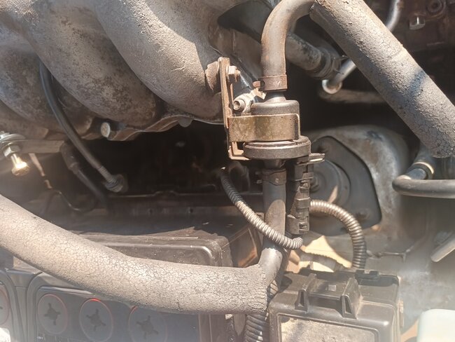

I have not checked the EGR valve being a fuel injected car I see nothing like that near the intake. There is a vac hose at the top of the intake manifold running to a device mounted to the wall of the engine compartment below the battery in front of the fuel filter. I presume this is the EGR?

The device I described has a broken rubber mount so it floating around. I will ensure it is plugged in.
Friday, May 26th, 2023 AT 5:18 AM
CONECASTER
  • 17 POSTS
Is this the EGR.
You can see it's plugged in I pulled it up and held it against the manifold to shoot it.

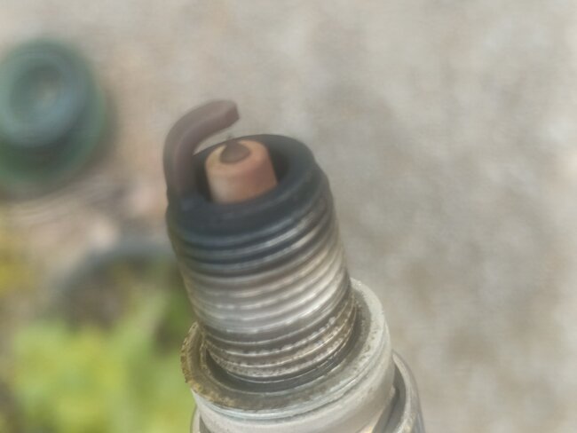

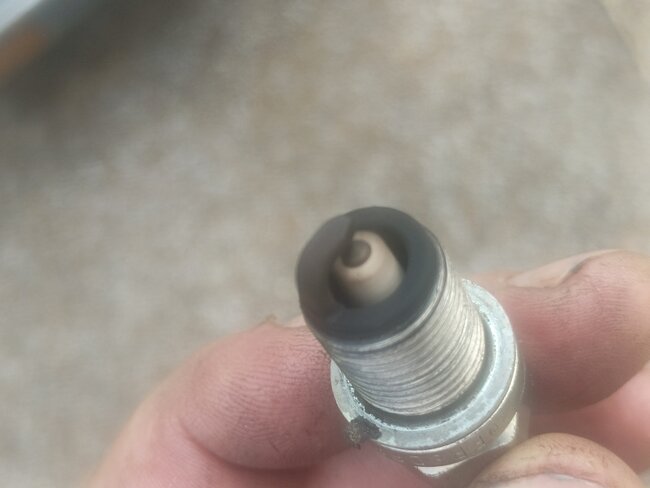

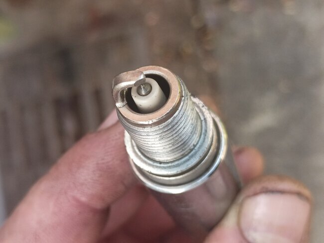

Here are the plugs in order 1 through 4.
#1
Friday, May 26th, 2023 AT 5:29 AM
CONECASTER
  • 17 POSTS
#2
CONECASTER
  • 17 POSTS
#3
Friday, May 26th, 2023 AT 5:30 AM
CONECASTER
  • 17 POSTS
#4
CONECASTER
  • 17 POSTS
As you can see # 3 is the most healthy, #2 is not firing all the time and in fact has not fired since I tested the compression. Before that it was firing and running relatively well, right now I could not bank it up my driveway.

The issues were:
1. Continuity between the 2 coil trigger wires.
2. Moved the working 2 coil to 4 and put in an old coil, number 3 started firing.
3. The spark plug was no good. Cleaned up an old ngr from old head and it came to life. Bosch iridium plug no good.
