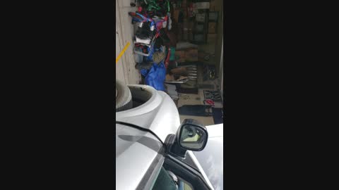

While driving, the engine started making a fast noise, followed by losing power to the point it wouldn't go over about 40 mph, and then started smoking. After getting it home, I opened the hood and noticed there was some smoke still coming from the air box. I took off the lid and found that oil was getting into the filter. I looked under the vehicle and found about 1/2 quart of oil on my driveway. To verify the smoke, I disconnected the air line that goes from the engine to the airbox and it emitted white smoke.

Can you upload a video of the noise and the smoke? I want to hear the noise so I can help you. These guides can help us fix it

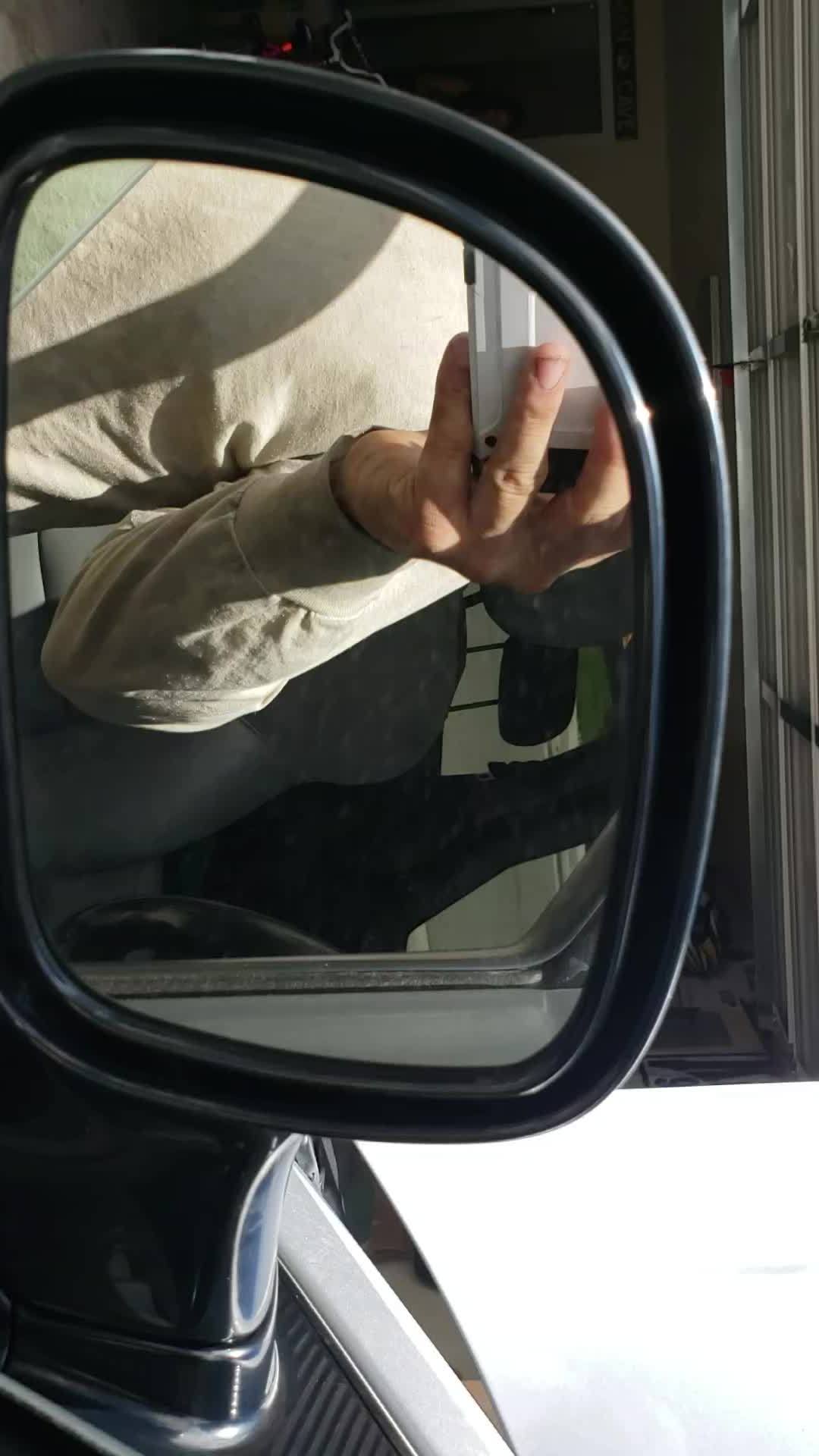

I added a video. Not seeing it here.
Tuesday, May 21st, 2019 AT 12:40 PM
MIZZOURAH78
It successfully loaded. Can you see it?
Tuesday, May 21st, 2019 AT 12:43 PM
Got it.
This sounds like a broken piston in the engine. That would explain both the noise and smoking.
I would suggest replacing the engine with a used engine.
Tuesday, May 21st, 2019 AT 1:00 PM
