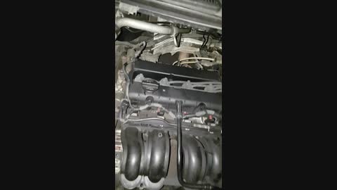

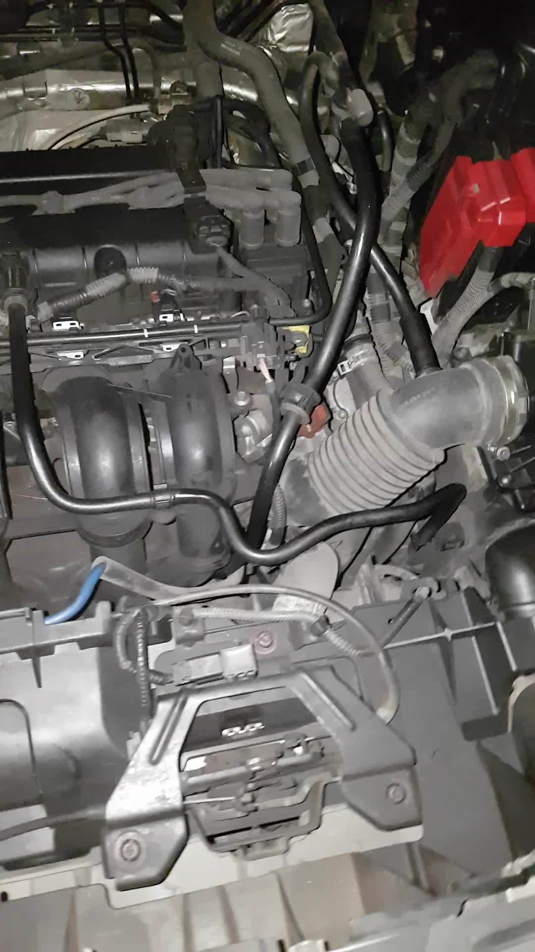

HUDARSONO
  • 9 POSTS
Hi Ken, I have attached the video. The AC was on when the video start, then on 0:11 the AC switched off, then switched on again on 0:23.
I can see the AC clutch turned off and on according to the switch.

Thanks for the video. When the AC fan is on full does the air in the vents stay cold? A compressor will cycle like that when the system is cold enough which will be normal.
Run this test and let me know.
+1
