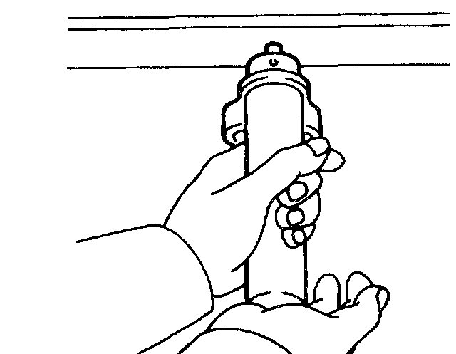

Hold the tensioner with both hands and push the push rod strongly as shown to check that it doesn't move. If the push rod moves, replace the tensioner.
NOTICE: Never hold the tensioner push rod facing downward.
Measure the protrusion of the push rod from the housing end.
Protrusion: 10.5 -11.5 mm (0.413 - 0.453 inch)
If the protrusion is not as specified, replace the tensioner.

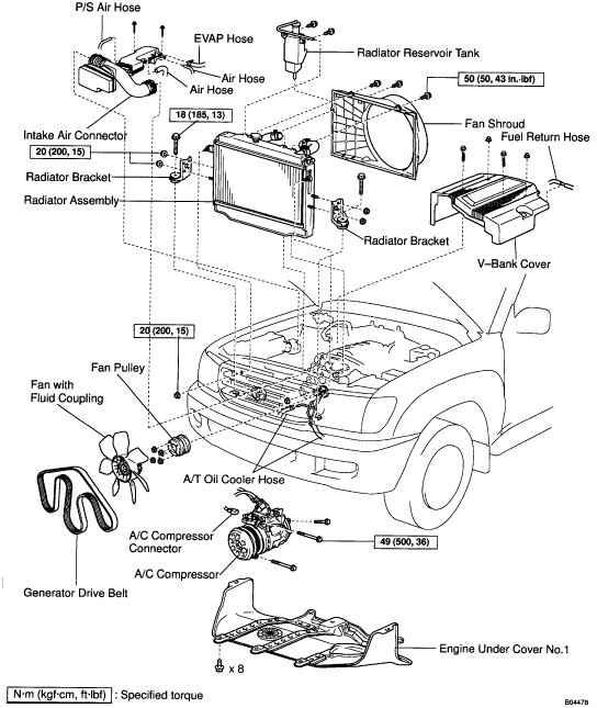

REMOVE OIL PAN PROTECTOR.
REMOVE ENGINE UNDER COVER.
DRAIN ENGINE COOLANT.
REMOVE BATTERY CLAMP COVER.
REMOVE INTAKE AIR CONNECTOR.
REMOVE V-BANK COVER.
Remove the fuel return hose from the V-bank cover.
Remove the 2 bolt, 2 cap nuts and V-bank cover.
REMOVE AIR CLEANER AND INTAKE AIR CONNECTOR ASSEMBLY.
REMOVE DRIVE BELT, FAN, FLUID COUPLING AND FAN PULLEY.
Loosen the 4 nuts holding the fluid coupling to the fan bracket.
Remove the generator drive belt.
Remove the 4 nuts, the fan, fluid coupling assembly and fan pulley.
REMOVE RADIATOR ASSEMBLY.
REMOVE DRIVE BELT IDLER PULLEY. Remove the pulley bolt, cover plate and idler pulley.

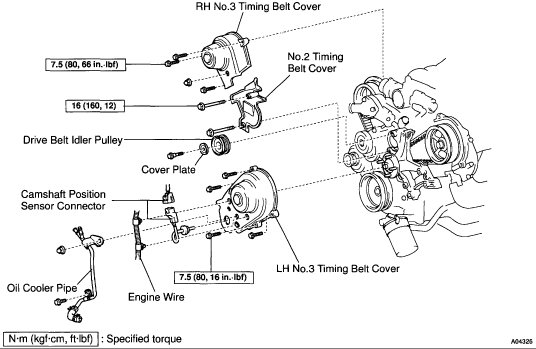

REMOVE RH NO.3 TIMING BELT COVER. Remove the 3 bolts, nut RH No.3 timing belt cover.
REMOVE LH NO.3 TIMING BELT COVER.
Disconnect the engine wire from the 2 wire clamps.
Remove the 4 bolts and nut.
Disconnect the camshaft position sensor wire from the wire clamp on the LH No.3 timing belt cover.
Disconnect the sensor connector from the connector bracket.
Disconnect the sensor connector.
Remove the wire grommet from the LH No.3 timing belt cover.
Remove the LH No.3 timing belt cover.
Remove the oil cooler pipe and 2 bolts.
REMOVE NO.2 TIMING BELT COVER.
Remove the 2 bolts and No.2 timing belt cover.
DISCONNECT A/C COMPRESSOR FROM ENGINE.
REMOVE FAN BRACKET.
Remove the 2 bolts, 2 nuts and fan bracket.

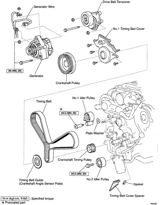

REMOVE NO.1 TIMING BELT COVER. Remove the 4 bolts, timing belt cover.
REMOVE TIMING BELT GUIDE.
REMOVE TIMING BELT COVER SPACER.
REMOVE TIMING BELT.
HINT: If re-using the belt and the installation mark has disappeared from it, place a new installation mark on the timing belt to the match the dot mark of the crankshaft timing pulley.
REMOVE NO.1 IDLER PULLEY AND NO.2 IDLER PULLEY.
Using a 10 mm hexagon wrench, remove the bolt, No.1 idler pulley and plate washer.
Remove the bolt and No.2 idler pulley.
REMOVE CRANKSHAFT TIMING PULLEY.
Using SST, remove the timing pulley.
SST 09950 - 50010 (09951 - 05010, 09952 - 05010, 09953 - 05010, 09953 - 05020, 09954 - 05010)
NOTICE: Do not turn the timing pulley.

INSTALL CRANKSHAFT TIMING PULLEY.
Align the timing pulley set key with the key groove of the pulley.
Using Special Service Tool (SST) and a hammer, tap in the timing pulley, facing the flange side inward. SST 09223 - 46011
INSTALL NO.1 IDLER PULLEY AND NO.2 IDLER PULLEY.
Apply adhesive 2 or 3 threads of the pivot bolt. Adhesive: Part No. 08833 - 00080, THREE BOND 1344, LOCTITE 242 or equivalent
Using a 10 mm hexagon wrench, install the plate washer and No.1 idler pulley with the pivot bolt.
Torque: 34.5 Nm (25 ft. lbs.)
Install the No.2 idler pulley with the bolt.
Check that the No.1 and No.2 idler pulley moves smoothly.
TEMPORARILY INSTALL TIMING BELT.
NOTICE: The engine should be cold.
Remove any oil or water on the crankshaft pulley, oil pump pulley, water pump pulley, No.1 idler pulley and No.2 idler pulley, and keep them clean.
NOTICE: Only wipe the pulleys; do not use any cleansing agent.
Align the installation mark on the timing belt with the timing mark of the crankshaft timing pulley.
Install the timing belt on the crankshaft timing pulley, No.1 idler pulley and No.2 idler pulley.
INSTALL TIMING BELT COVER SPACER.
Install the gasket to the cover spacer.
Install the cover spacer.
INSTALL TIMING BELT GUIDE. Install the belt guide, facing the cup side outward.
INSTALL NO.1 TIMING BELT COVER. Install the timing belt cover with the 4 bolts.
INSTALL CRANKSHAFT PULLEY.
Align the pulley set key with the key groove of the crankshaft pulley.
Using SST and a hammer, tap in the crankshaft pulley. SST 09223 - 46011
INSTALL DRIVE BELT TENSIONER. Install the belt tensioner with the bolt and 2 nuts.
Torque: 16 Nm (12 ft. lbs.)
HINT: Use a bolt 106 mm (4.18 inch) in length.
INSTALL GENERATOR.
CHECK CRANKSHAFT PULLEY POSITION. Check that the timing mark of the crankshaft pulley is aligned with the centers of the crankshaft pulley and the idler pulley bolt.

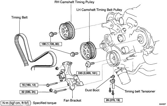

INSTALL RH, LH CAMSHAFT TIMING PULLEYS.
Align the camshaft knock pin with the knock pin grove of the timing pulley, and slide on the timing pulley.
Using SST, install the pulley bolt. SST 09960 - 10010 (09962 - 01000, 09963 - 01000)
Torque: 108 Nm (80 ft. lbs.)
CONNECT TIMING BELT TO LH CAMSHAFT TIMING PULLEY.
Remove any oil or water on the LH camshaft timing pulley, and keep it clean.
Turn the LH camshaft timing pulley. Align the installation mark on the timing belt with the timing mark of the camshaft timing pulley, and hang the timing belt on the LH camshaft timing pulley.
Turn the LH camshaft timing pulley counterclockwise until there is tension between the crankshaft timing pulley and LH camshaft timing pulley.
CONNECT TIMING BELT TO RH CAMSHAFT TIMING PULLEY.
Remove any oil or water on the RH camshaft timing pulley and water pump pulley, and keep them clean.
Turn the RH camshaft timing pulley. Align the installation mark on the timing belt with the timing mark of the camshaft timing pulley, and hang the timing belt on the RH camshaft timing pulley.
SET TIMING BELT TENSIONER.
Using a press, slowly press in the push rod using 981 - 9,807 N (220 - 2,205 lbs.) of pressure.
Align the holes of the push rod and housing, pass a 1.27 mm hexagon wrench through the holes to keep the setting position of the push rod.
Release the press.
Install the dust boot to the belt tensioner.
INSTALL TIMING BELT TENSIONER.
Temporarily install the belt tensioner with the 2 bolts.
Alternately tighten the 2 bolts.
Torque: 26 Nm (19 ft. lbs.)
Using pliers, remove the 1.27 mm hexagon wrench from the belt tensioner.
CHECK VALVE TIMING.
Temporarily install the crankshaft pulley bolt.
Slowly turn the crankshaft pulley 2 revolutions from Top Dead Center (TDC) to TDC.
NOTICE: Always turn the crankshaft pulley clockwise.
Check that each pulley aligns with the timing marks as shown in the illustration. If the timing marks do not align, remove the timing belt and reinstall it.
TIGHTEN CRANKSHAFT PULLEY BOLT.
SST 09213 - 54015 (90119 - 08216), 09330 - 00021
Torque: 245 Nm (181 ft. lbs.)
INSTALL FAN BRACKET.
Install the fan bracket with the 2 bolts and 2 nuts.
Torque:
12 mm head: 16 Nm (12 ft. lbs.)
14 mm head: 32 Nm (24 ft. lbs.)

Install the No.2 timing belt cover with the 2 bolts.
INSTALL RH NO.3 TIMING BELT COVER.
Fit the RH No.3 timing belt cover, matching it with the fan bracket.
Install the RH No.3 timing belt cover with the 3 bolts and nut.
Torque: 7.5 Nm (66 inch lbs.)
INSTALL LH NO.3 TIMING BELT COVER.
Install the oil cooler pipe and bolt.
Run the camshaft position sensor wire through the LH No.3 timing belt cover hole.
Fit the LH No.3 timing belt cover, matching it with the fan bracket.
Install the LH No.3 timing belt cover with the 4 bolts and nut.
Install the wire grommet to the LH No.3 timing belt cover.
Install the sensor connector to the connector bracket.
Connect the sensor connector.
Install the sensor wire to the wire clamp on the LH No.3 timing belt cover.
Install the engine wire to the 2 wire clamps on the LH No.3 timing belt cover.
INSTALL DRIVE BELT IDLER PULLEY. Install the idler pulley and cover plate with the bolt.
Torque: 37 Nm (27 ft. lbs.)
INSTALL RADIATOR ASSEMBLY.
INSTALL FAN PULLEY, FAN, FLUID COUPLING AND DRIVE BELT.
Temporarily install the fan pulley, the fan, fluid coupling assembly with the 4 nuts.
Install the generator drive belt.
Tighten the 4 nuts holding the fluid coupling to the fan bracket.
Torque: 21 Nm (16 ft. lbs.)
INSTALL AIR CLEANER AND INTAKE AIR CONNECTOR ASSEMBLY.
INSTALL V-BANK COVER.
FILL WITH ENGINE COOLANT.
START ENGINE AND CHECK FOR LEAKS.
RECHECK ENGINE COOLANT LEVEL.
INSTALL INTAKE AIR CONNECTOR.
INSTALL BATTERY CLAMP COVER.
INSTALL ENGINE UNDER COVER.
INSTALL OIL PAN PROTECTOR.
