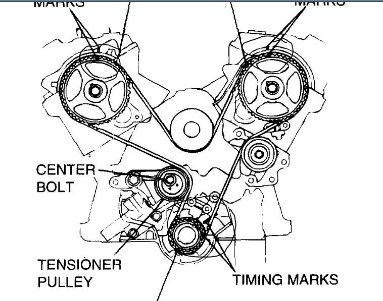

Car was running but leaking antifreeze from motor. Found that the water pump was bad. Replaced water pump, timing belt tdc, plugs, wires, battery and distributor cap and rotor. Now car will not start.

Sounds like the timing belt may not be on correctly.
How did you line up the marks? I attached a picture of the marks for you. Make sure they are lined up correctly.

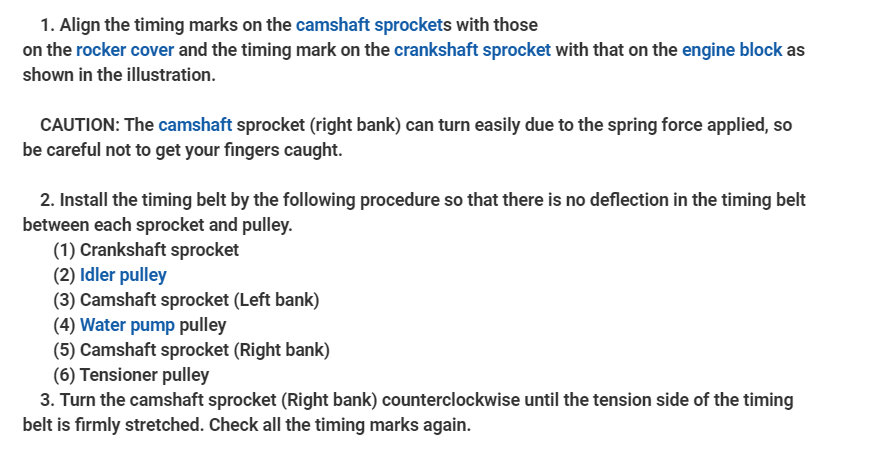

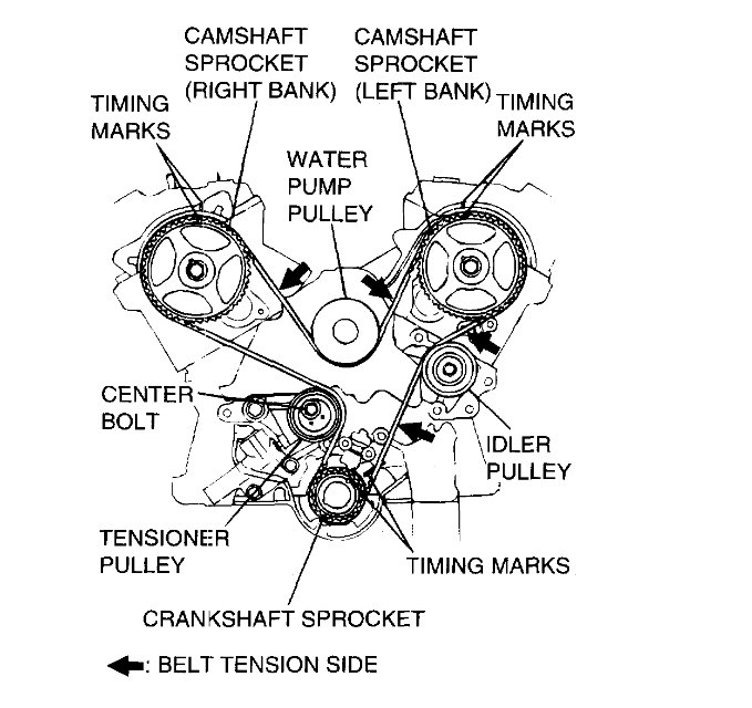

This sounds like your timing marks might be a tooth or two off. In the diagrams down below I have included how to align the timing marks on your vehicle properly. Please go through this guide and get back to us with what you are able to find out.

Thank you. I have done this about 5 times over and still the same problem

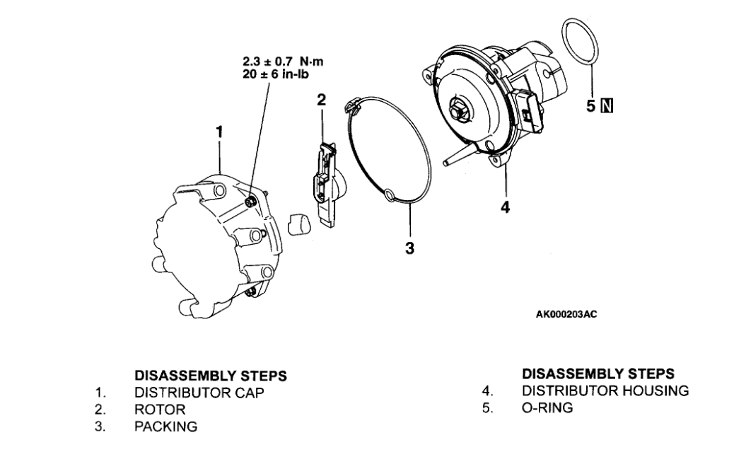

Another thing that you might want to double check is to ensure that the distributor cap isn't 180 degrees out and that the rotor is installed correctly. This would allow your vehicle to start and run, but it would run poorly and die. I have included a diagram of the distributor cap and rotor below. Please get back to us with what you are able to find out.

What happened when you replaced the fuel pump? How did the cap and rotor on your vehicle look? We are curious to see what' the problem is. Please get back to us and let us know.

I also replaced cap and rotor. I started getting fuel in the motor. Before I wasn’t.

Have you checked the cap and rotor for proper installation yet?
