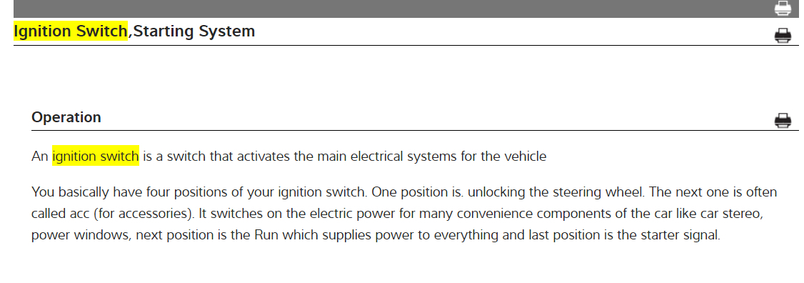

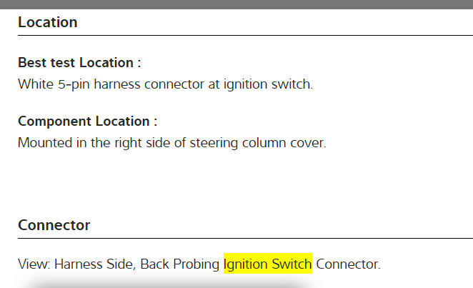

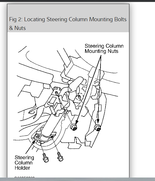

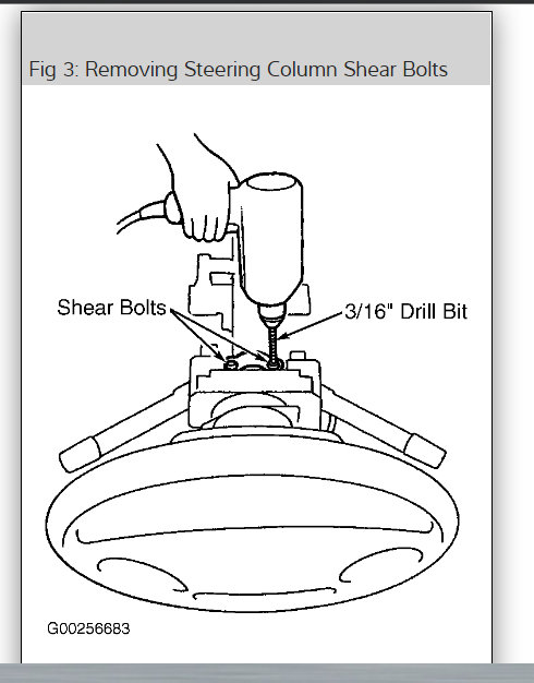

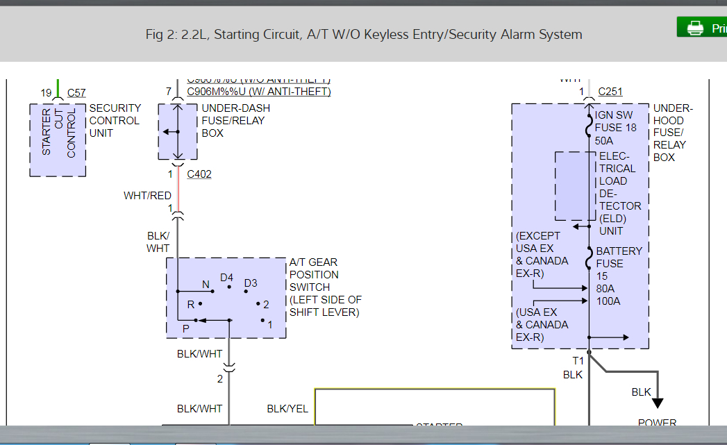

SCGRANTURISMO
  • 4,897 POSTS

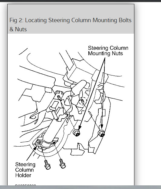

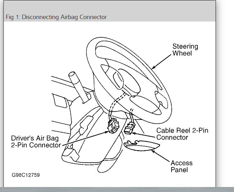

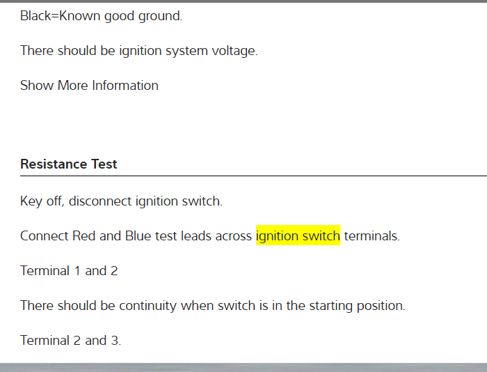

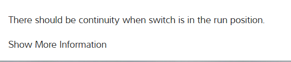

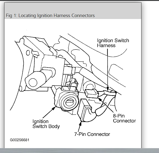

Hello again,

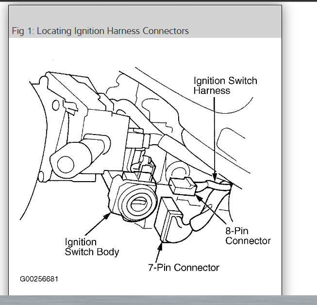

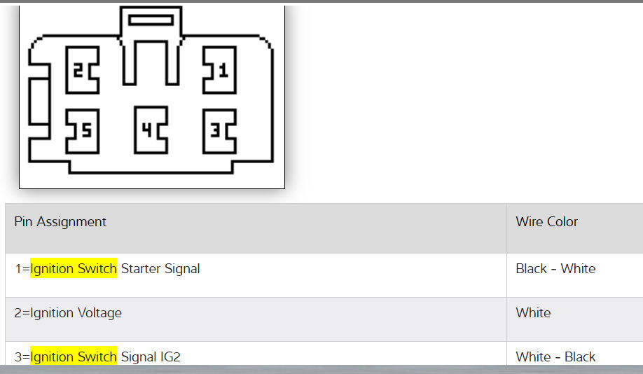

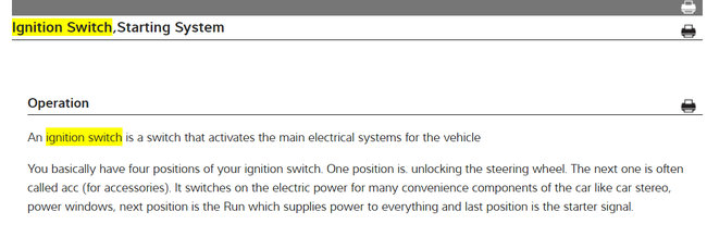

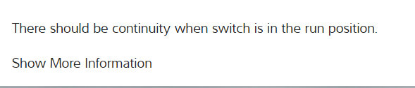

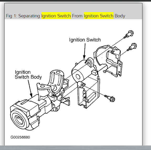

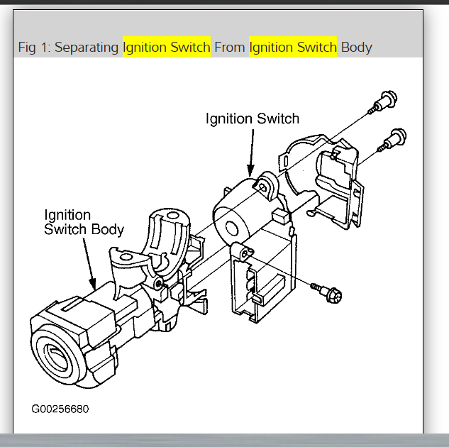

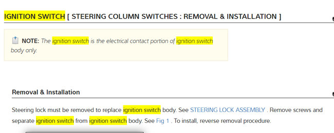

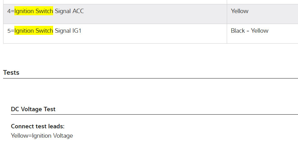

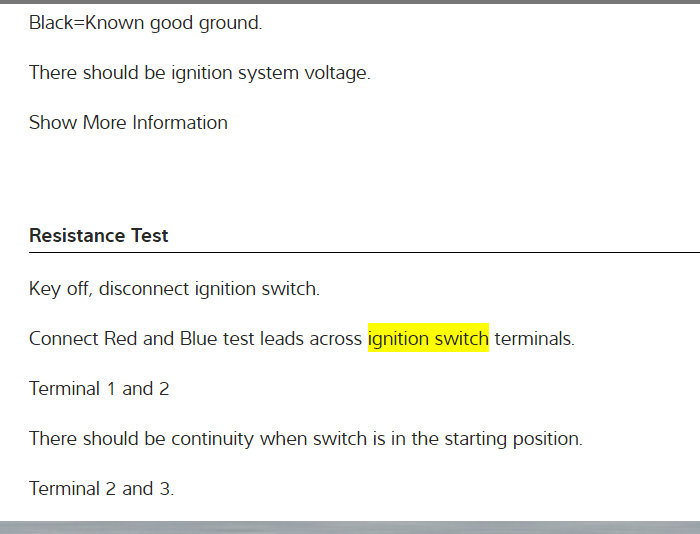

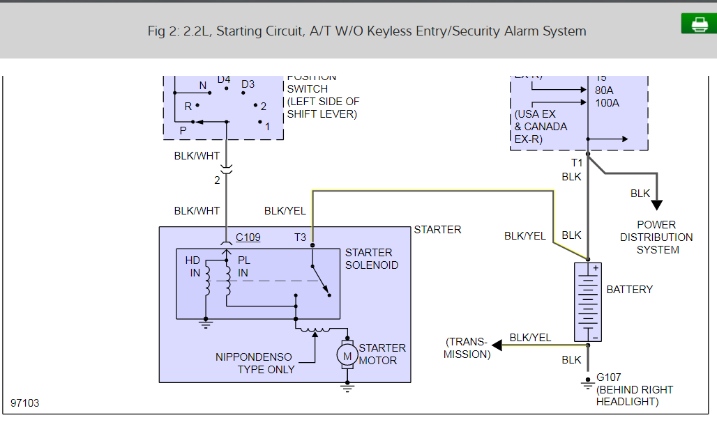

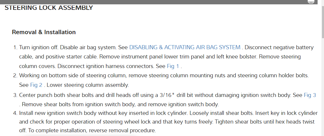

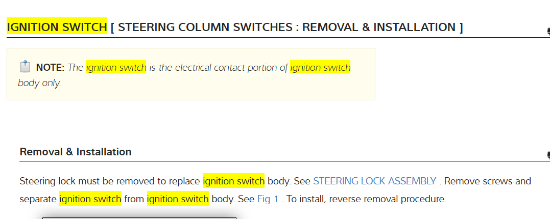

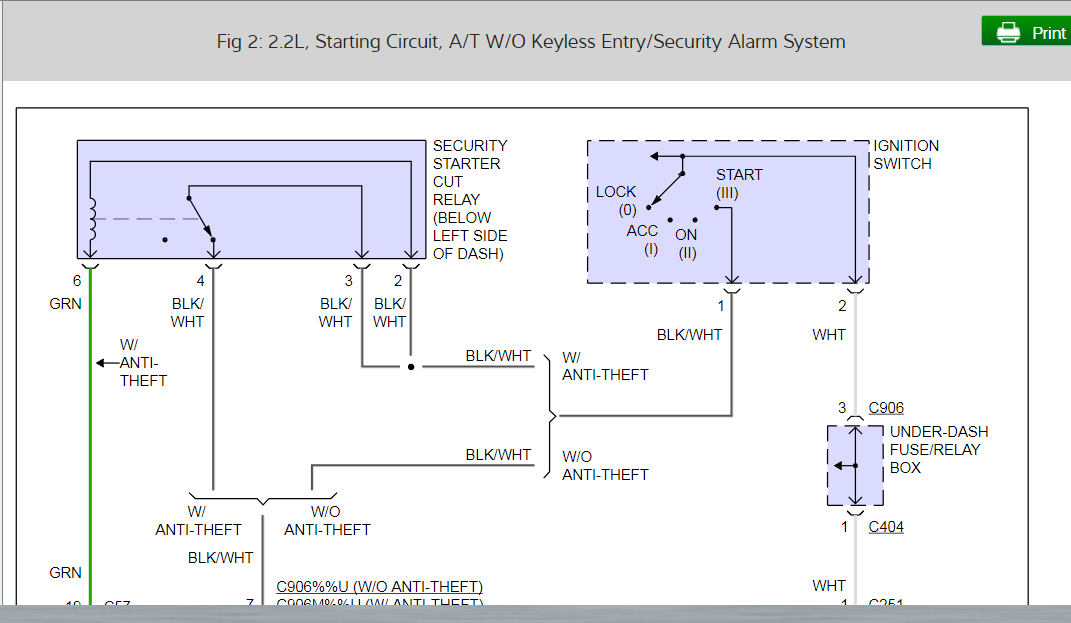

This could be a couple of things. It could be either your ignition switch or your neutral safety switch that is causing your intermittent no start condition. So let's start with the ignition switch. In the diagrams down below I have included the starting circuit wiring diagram and the diagnostic troubleshooting guide for the ignition switch in the diagrams down below. Please go through the guide and get back to us with what you are able to find out.
Thanks,
Alex
2CarPros
Friday, June 25th, 2021 AT 12:16 PM
6PAC-MAN
  • 5 POSTS
Well, I replaced the s/w a few yrs. Ago because of mech. Issue w/it. I keep going back to the fact the engine did start Always, but now > touching those battery cables together (off the battery), it won't crank at all! There Must be something (electrical?) That didn't reboot or charge up or? > Reconnecting the battery! The neutral s/w worked just fine also > trans. Rebuild, ----plus car Should start in Park, shouldn't it, even if neutral s/w Was bad. It always gets started in Park!
Randy

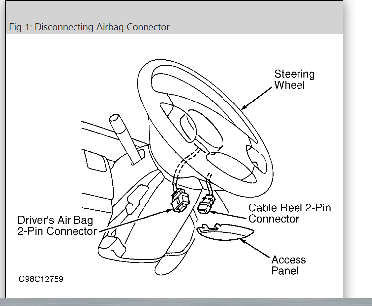

It sounds like the starter has gone bad but to be sure lets run down this guide
+1
6PAC-MAN
  • 5 POSTS
Okay, as soon as I read about the alarm system, that I thought is the culprit and it was! Now I want you guys to know I really appreciate your help in fixing this issue. But, I may still have the Speed Sensor problem. I won't know until I drive car a bit. Now, looking back from my first email where I mentioned what was listed to do; remove and replace battery cables, touching leads, the information about "alarm system". Should have been included in the statement! I was pretty sure (or at least hoping), it was something simple, since everything on car worked just fine, with exception of speed sensor and none crank at initial try Sometimes. So, with all that said, I again thank you all for your help and will get back in touch. Driving car around to see if speed sensor/speedometer/tachometer, is working full time or intermittently. Randy in Fla.
