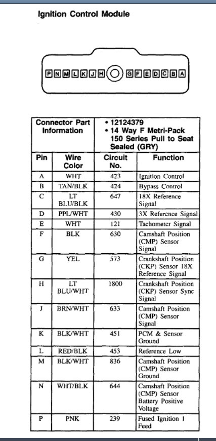

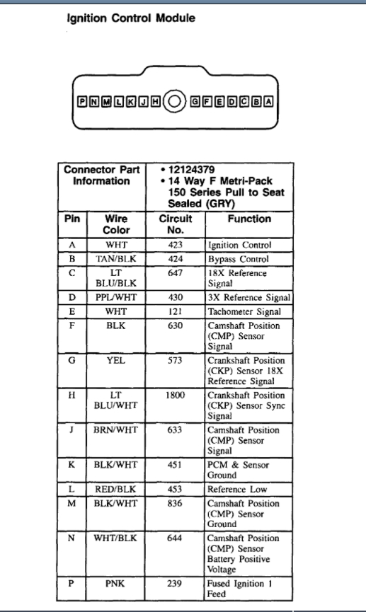

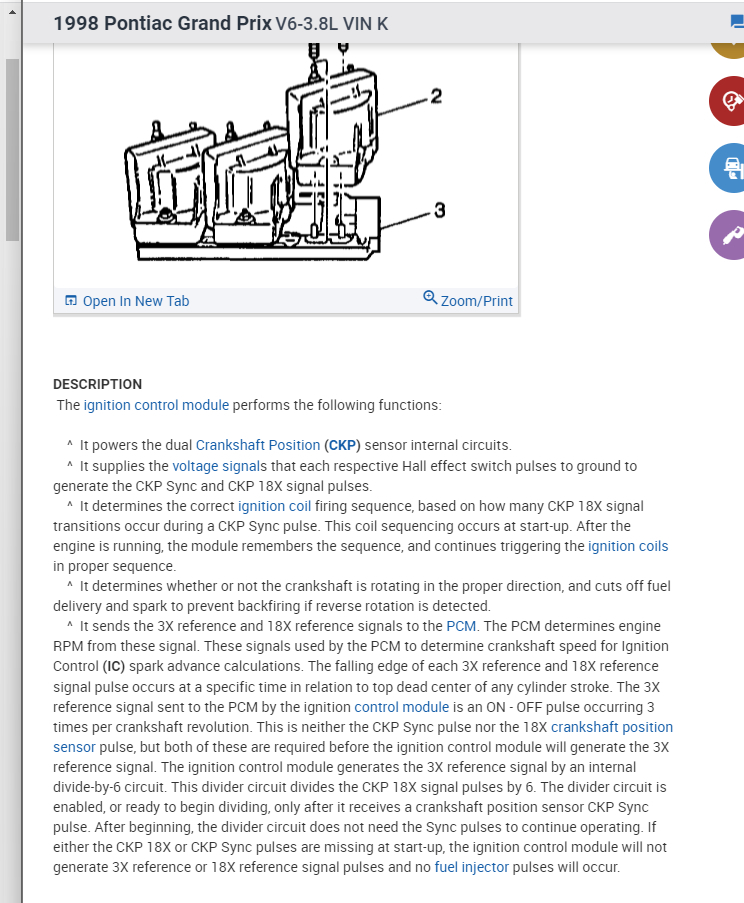

Just trying to clarify what you are looking for. When you say the ICM has power with the key off and not on, are you referring to the ignition control module?
I attached the info below on this ICM. The ICM would have to have power when the key is on or the vehicle will not start. Is that the issue you are having?
If you are talking about something different, let me know.
Then are you asking a second question on why the car chimes when you hook the battery up?
If so, then when you are hooking the battery back up, there are modules that are going to come back on line so that may be causing the chimes, but can you get a recording of these chimes so that we can see what it is doing?
This may be related to the ICM having power when the key is off.
To address that we need to check the power on each of the terminals with the key on and off.
I attached the connector view below so let us know what the voltage is on these and we can go from there. Thanks

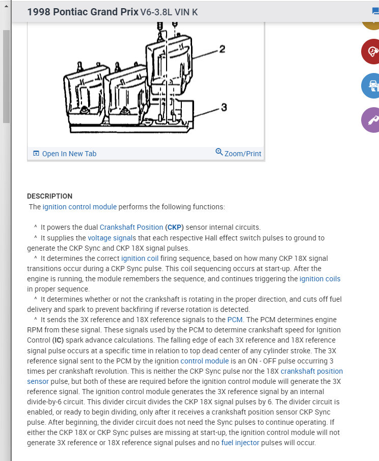

I just want to confirm that you did this testing with the ICM connector unplugged?
Most of these circuits are not going to produce voltage until the engine is turning.
These are called signal circuits so that means they send a signal when they are active.
So, if you have power and ground going to the ICM then we need to check these circuits when the engine is cranking, and I suspect you will get some voltage. However, you will need a labscope in order to determine if the signal is correct because the voltmeter will not be fast enough to show the proper voltage.
However, at least this will show that the ICM is getting the signals. Even if this is the case, I don't think that is the reason for the chime. If the chime happens when you hook the battery up and then stops then that is a module going through an initialization process and it completes when the chime stops.

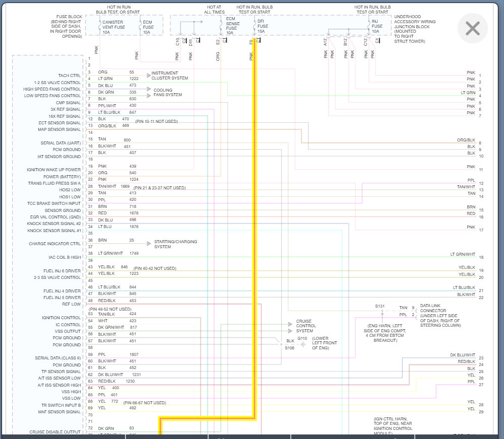

That is all good info. But my main problem is that I lose power to my ICM when the key is put in the run pos.
Wednesday, December 8th, 2021 AT 10:06 PM

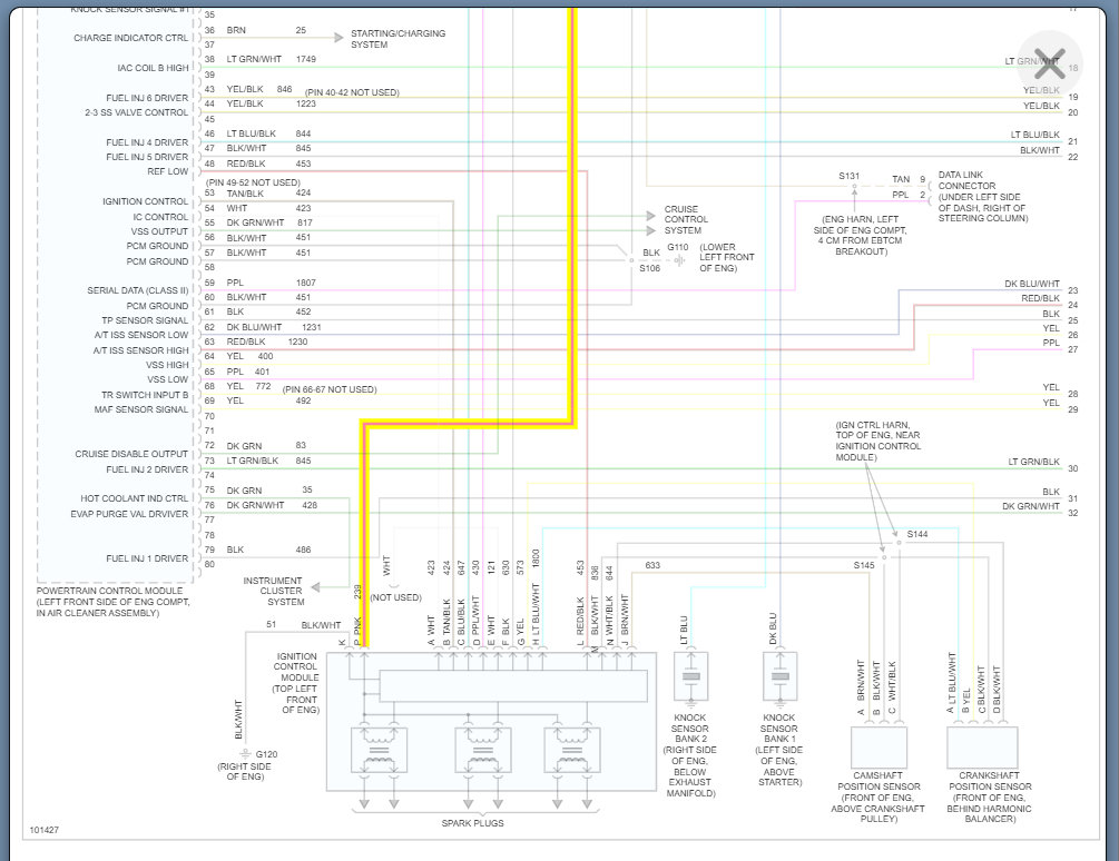

Okay, let me confirm what is happening when you say you are losing power because I think this means something different to me.
On pin P when you turn the key on, do you have voltage using a known good ground? Then do you have voltage in the on position on pin P when using K for a ground?
Pin P should have 12 volts when the key is in the on, start, or during the bulb test so let's start with this and then work from there.
I understand this may be duplicate info, but I am not sure I am understanding, and this is important or we are going to be going in the wrong direction. See the wiring diagram below that will help.
Thanks
Thursday, December 9th, 2021 AT 10:51 AM
RVMAN350
  • 7 POSTS

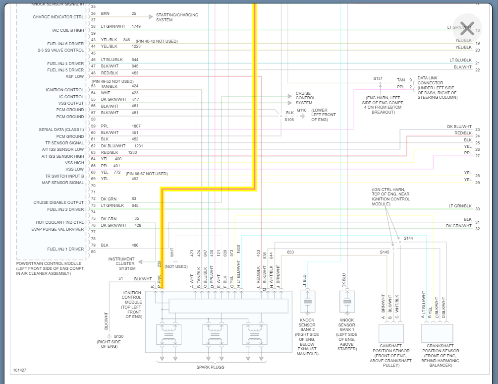

I have power on pin p when the key is off when I turn the key on, I lose power on pin p wtf it is completely backwards right? It is the same when I use pink, or I use battery ground.
Thursday, December 9th, 2021 AT 12:33 PM
That is correct. It is completely backwards which means we most likely have the issue on the fuse block. More than likely, it is shorted or has some other issue.
Basically, I would take that wiring diagram that I attached above and remove the fuse and check the same thing there. You should have 12 volts on the battery side of the fuse only when the key is on. If you have it when it is off, then that fuse box has an issue on the circuit board.
