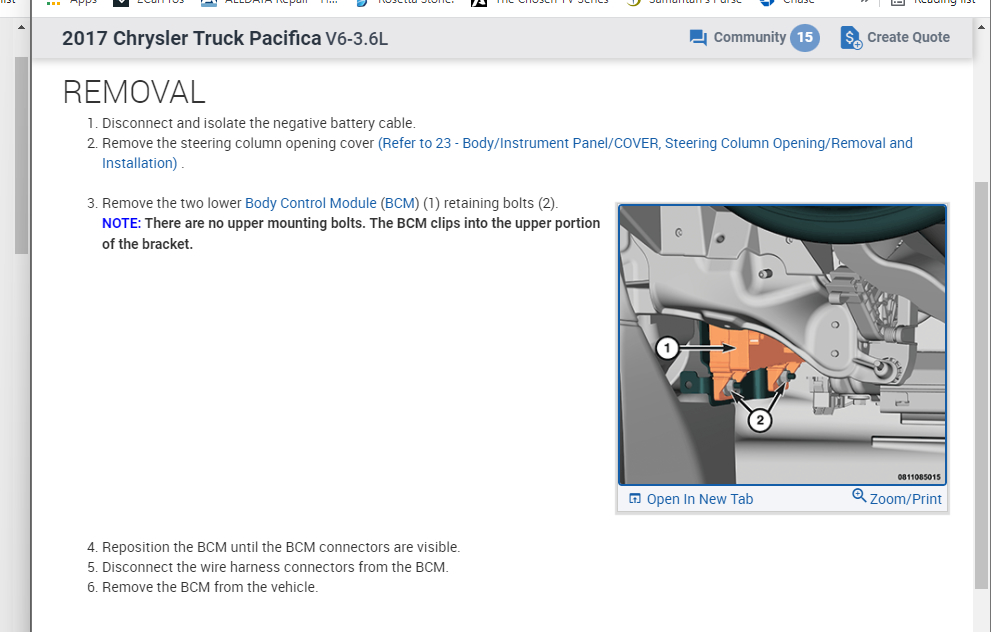

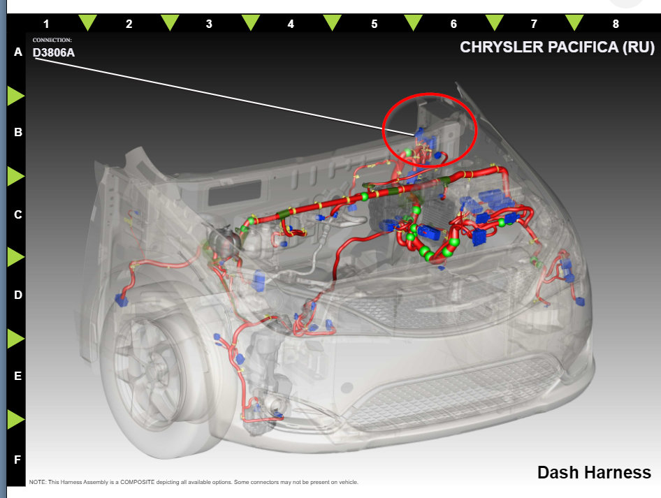

Where is located BCM inside car? Near Passenger legs, right site?
Monday, December 27th, 2021 AT 11:39 AM

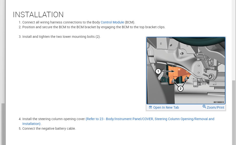

It is actually on the driver's side. I attached the info below on how to replace it and then the location view of the front end.
