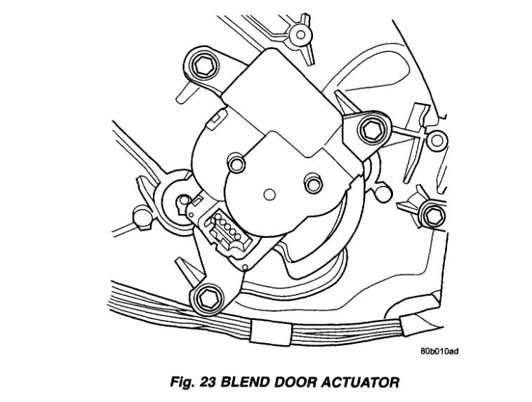

So I replaced the mode door and have no heat still. Maybe blend door?
Sunday, November 18th, 2018 AT 9:21 AM
Yes. The blend door motor is what controls the heat not the mode door.
Sunday, November 18th, 2018 AT 9:23 AM
BHENRY
  • 20 POSTS
Yes, I am aware. Can you give me very specific instructions on how to change it?
Sunday, November 18th, 2018 AT 9:27 AM
BHENRY
  • 20 POSTS
My dad is doing it but he will not even get off of the couch until I can tell him where it is located.
Sunday, November 18th, 2018 AT 9:32 AM
BHENRY
  • 20 POSTS
Please!
Sunday, November 18th, 2018 AT 9:37 AM

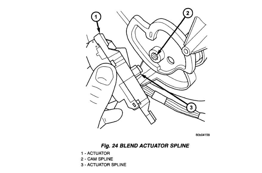

Sorry, traveling today.
Procedure below.
REMOVAL
NOTE: Prior to part replacement, re-calibration the HVAC actuator. Disconnecting negative battery cable for 60 seconds. This will automatically initiate the software calibration procedure.
1. Disconnect negative battery cable.
2. Remove the floor console.
3. Remove rear heat ducts.
4. Remove HVAC housing.
5. Disconnect the electrical connection.
Fig.23 Blend Door Actuator
6. Remove actuator retaining screws and pull actuator straight down. Note actuator shaft position for installation reference.
Fig.24 Blend Actuator Spline
