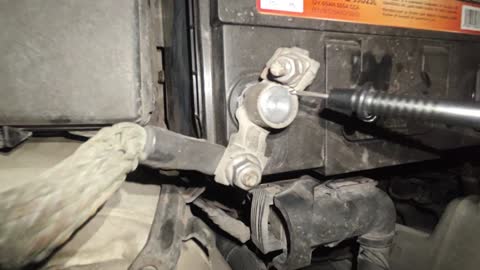

Hi

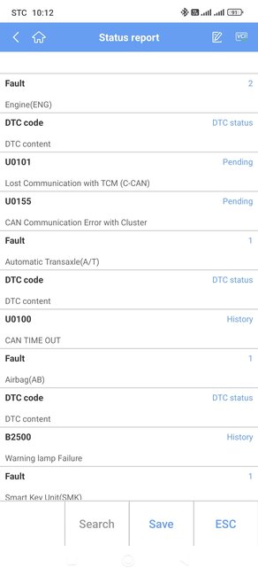

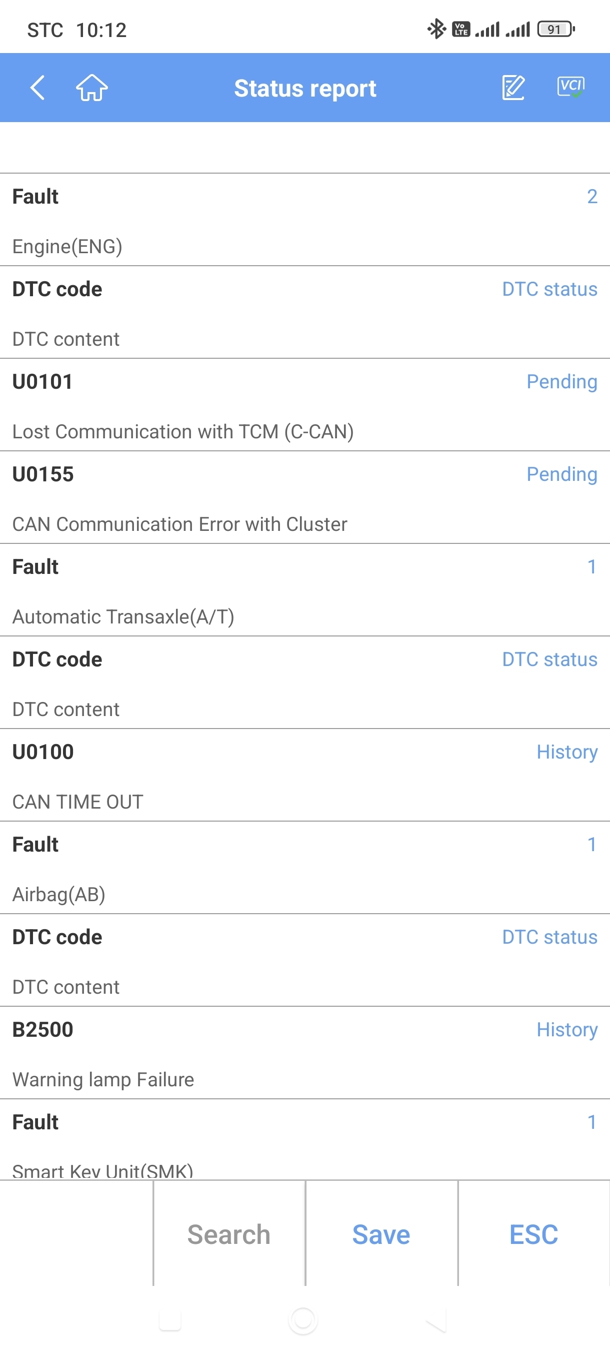

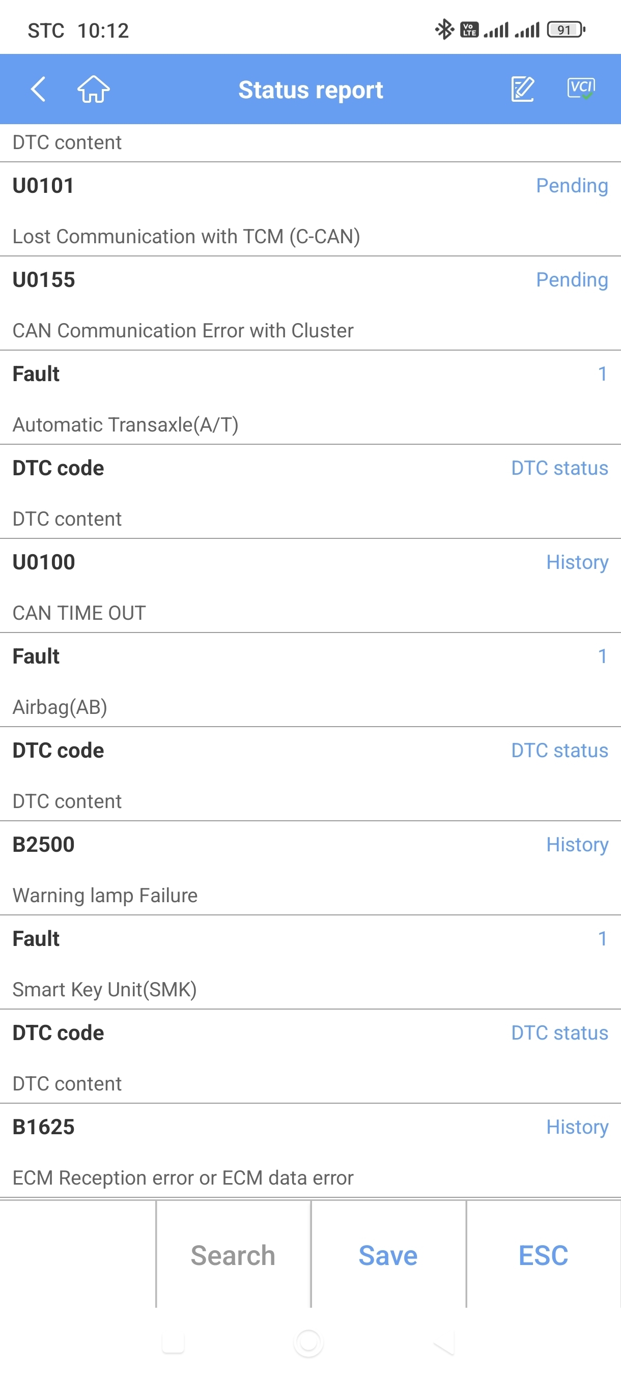

I have a 2014 Hyundai Veloster base model (non-turbo), last week I started to feel that the battery are dying till 2 days ago the battery completely failed. So, I went to a battery shop and bought a new battery. I used to put 60Ah normal acid filled battery, but since I installed new headlights (last month) that has an extra load and wired directly to the battery using a wiring harness I sought it's better to go for a higher capacity and that's what I did I bought a 70Ah EFB battery. From here the issues started first the guys who did the battery change for me disconnected the old battery while the car was on when I found out I quickly shut the car down and then he installed the new battery after that all are good the car are working fine no issues. Later I wanted to check the battery voltage with the headlights on using an OBD2 scanner (vGate) and the car are on when I connected it to the OBD2 port all hell broke loss the cluster started acting weird the temperature gauge went to zero as if the car are not running the rpm gauge same thing goes to zero the gear status desepere and some other lights turned on, after that I quickly removed the it and all went to normal (in the cluster) and immediately connected another OBD2 scanner (Autel AP200) nothing happened to the cluster as the other scanner but some codes appeared and it took a lot of time to extract the codes that usually takes less than a min the codes are:
U0100 (CAN TIMEOUT)
U0101 (Lost comm with TCM)
U0155 (Cluster comm error)
B2500 (Warning lamp glitch)
B1625 (ECM data error)
So, I cleared the codes and it took almost 5mins to do so and in the process the OBD2 scanner (Autel) disconnect and connect again in it's own (usual it doesn't do that). After that I did connect the vGate same issue so went back to the Autel and cleared the codes and after some googling I found that it might be an issue with the CAN-BUS and someone said to disconnect the battery to reset the memory of the ECM, TCM, and the cluster so I did that disconnected the battery and waited for 30mins while bleeding all the charges using the break pedal. After that I connected the battery and started the car and used the vGate same issue again so switched to the Autel and same scenario it took a lot of time to communicate with the modules and disconnect and connect a lot til I cleared the codes.
Now, some points I need to mention
All the issues started happening after the battery change.
The car works no problem.
The OBD2 scanner (vGate) used to work no problem in my car before the battery change and I tested it today on a friends car and it worked flawlessly.
The OBD2 scanner (Autel) takes a lot of time in the communication phase that it didn't do that before.
I don't know if what happened fried something I hope not but I don't know.
I tried all possible solutions I could find online that deals with disconnecting the battery and connecting it again with no luck.
I am not that much electricity good so I am in great need of help to figure out what's happening.
Looking forward for your reply and help and I am really sorry for the long text.

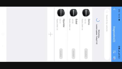

The issues only happens when connecting any OBD2 scanner, as I mentioned before I have tested 2 scanners the vGate and the Autel and I bought a third one ELM327 just to check, now the vGate and the ELM327 when connected to the OBD2 port the cluster starts acting weird and the same scenario as mentioned previously with the same codes.

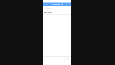

The autel works and I could clear the codes produced by connecting the vGate and the ELM327 but it takes ages to connect and after clearing the codes let's say I want to check the live data from the ECU for the engine it will try to connect to it takes 5 minutes and then gives a message that the device unable to communicate with the control unit and won't connect, sometimes it will connect and show like 10 live data points and in fact I know that there are more than that, sometimes it will connect and show the live data but nothing is moving (testing the throttle body voltage fully pressed pedal but no change in the voltage), sometimes it will connect and show all the live data 2 to 3 minutes and then disconnects on its own.

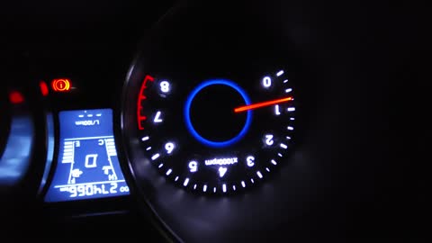

Also, 2 things I noticed and I don't know if it's even related, the first when loading the car with any electrical load let's say lowering the windows or using the high beams or opening the sunroof or ac etc, the rpm drops and you feel a vibration in the car then the rpm stabilizes, it happens all the time even if you did it consecutively like lowering the windows and keep pressing the button the rpm drops and a vibration as soon as you remove the load it goes back the normal. The second thing, I noticed that yesterday I have an led bulbs in the fog lights, the car was off but the ignition on when I blow the horns the led in the fog lights slightly dims if I removed the load ie not blowing the horns the led will have the full brightens plus if I moved the steering wheel to the right or left same thing the led bulbs will dim.

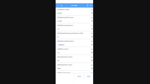

The videos are for the Autel interface showing what happens when connecting a scanner it could be a little bit lengthy but it shows the problem plus another video for the electrical issue, also this time a new code showed c1616 can bus off as history code in the EPS, it's visible in one of the videos. Thank you : )

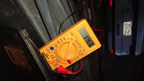

Hello, welcome back and thank you for the detailed message and videos yes, that is strange action on the car and scanners, I am wondering if the alternator is throwing AC voltage, with the engine running switch your voltmeter to AC and then rev the engine to see if you got any measurement, you should have 0. Here is a guide to help.
Also, check to make sure the ground from the battery to the engine and chassis is in good shape. Please go over this guide and get back to us.

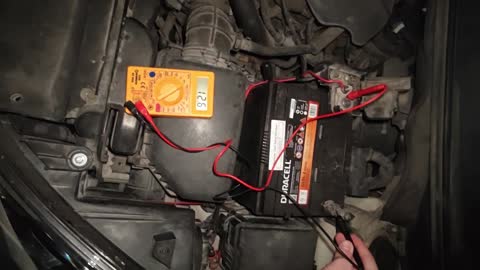

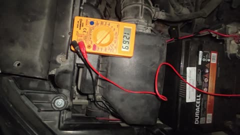

1 - Battery Voltage Check
The battery voltage while the car are cold and parked for almost 6 hours is 12.6v.

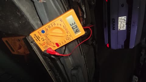

2 - AC Voltage Check
Now I don't know if my multimeter are bad (because it's very cheap) or not but what I was getting at 200v while the car are off is 26.3v and while the car are running and rpm at almost 1500 is 30.5v I know this doesn't make sense and I might need to buy a new one and re do the test because you mentioned that it should be 0 and this number seems to high.

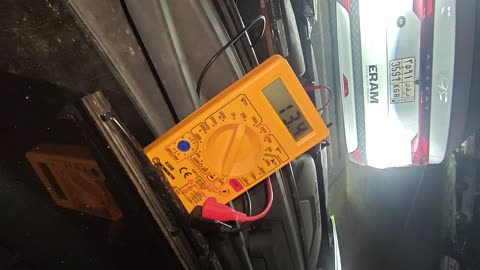

3 - Full Load Voltage
I did a full load test, low beams, high beams, hazard lights, windows, rear window defroster, and AC on full blast the voltage was 13.4 to 13.5v.

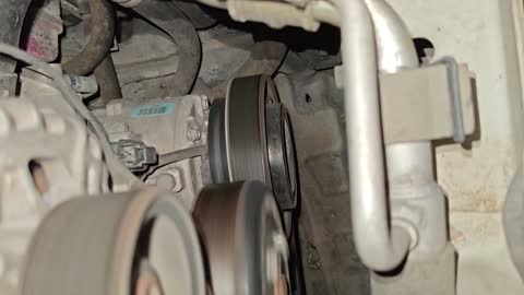

1 - AC Compressor Pulley/Clutch
When the AC is on I was looking at the clutch it seems it stops and lags 1 to 2 times in it's place and then spins (video will help) now I don't know if that's related or if that's the norm.

Yep, you have found the problem, it should have 0 AC voltage, so the alternator has a bad diode, I would get a replacement unit and install it. That should fix the issue. Thanks for the video and images, they help. Ken

I need to confirm some points before I go with a new alternator. When connecting the multimeter to the battery while the engine is off at 200v AC it shows about 26.3 now the alternator are off so how I am getting that number I don't know so I think it's either a bad multimeter because it's a cheap one or something else worng here. So, I will order a new multimeter in the next couple of days and update you with the findings.

Yep, that starter as bad as well, the voltmeter must bad bad as well because you should have 0 AC voltage. At anytime, so when you start the engine it sounds like it is out of oil?
