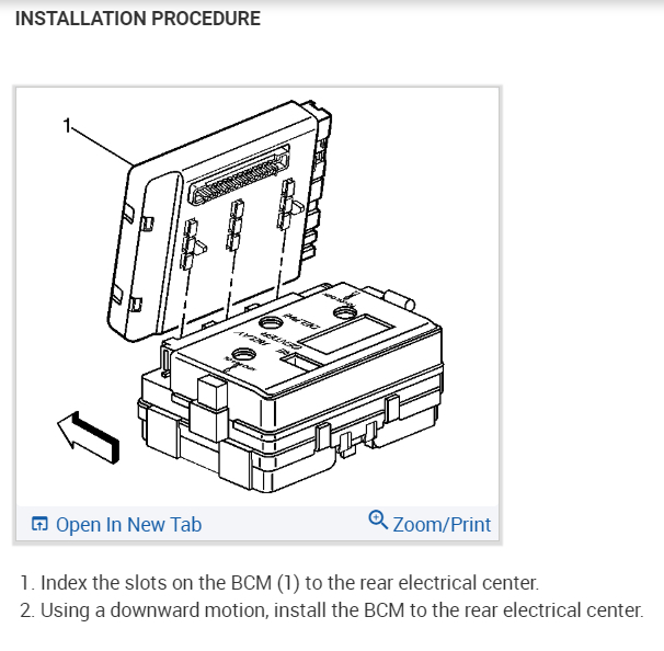

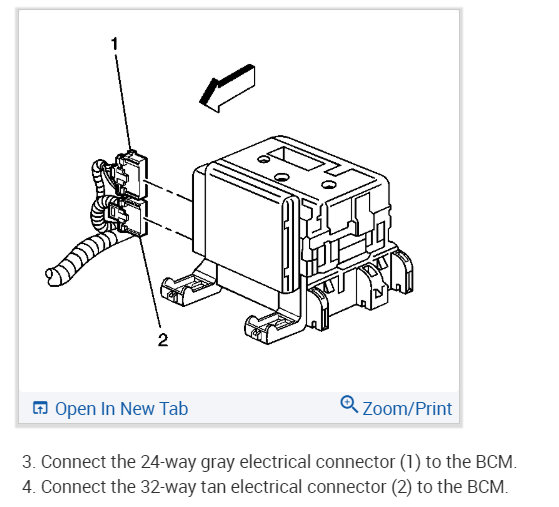

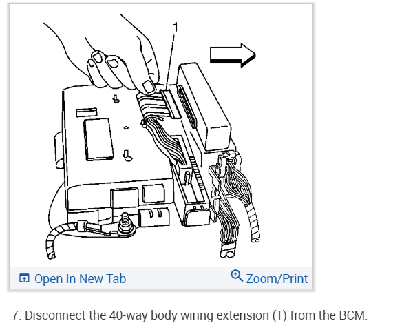

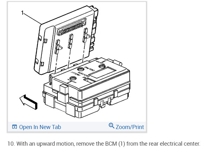

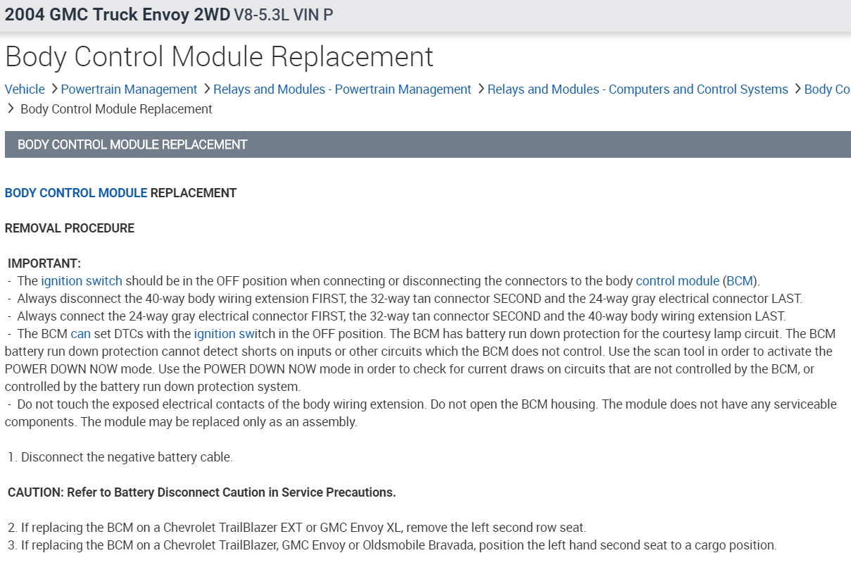

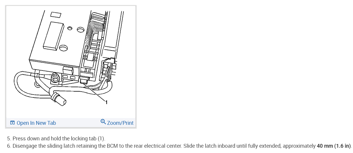

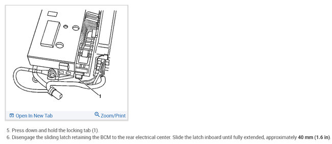

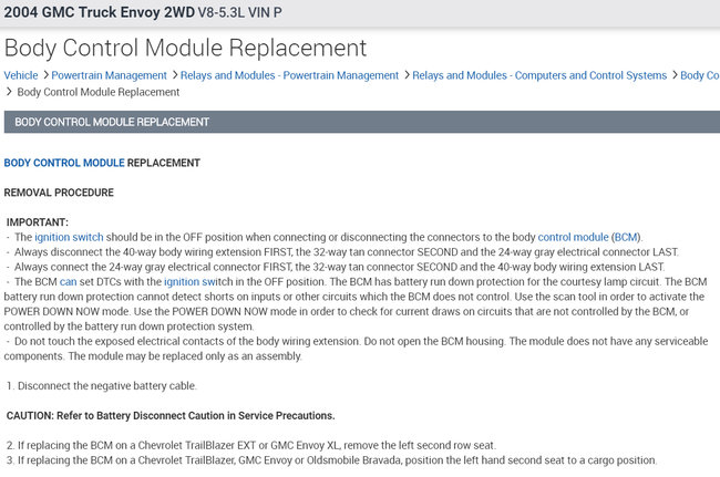

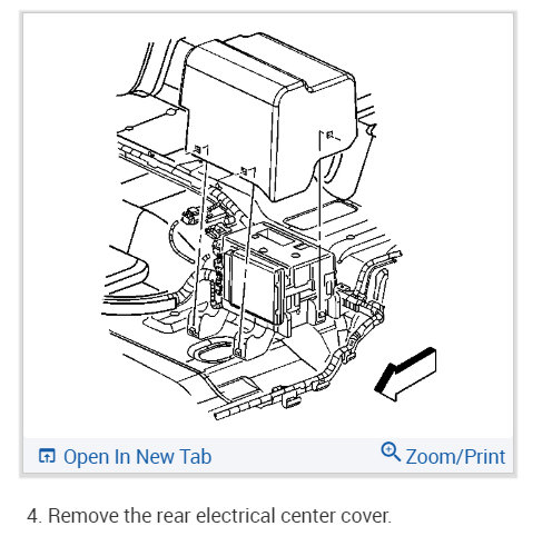

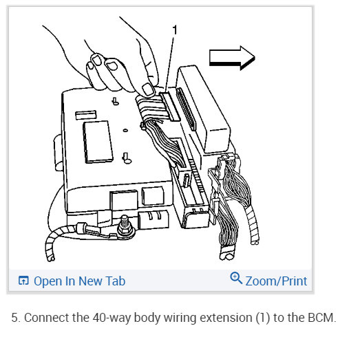

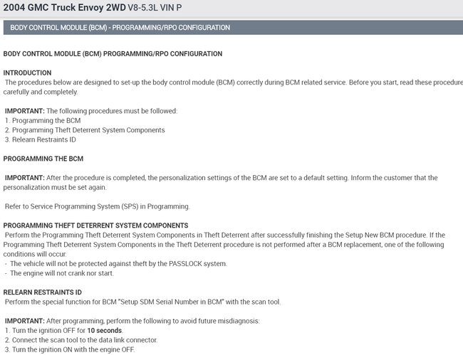

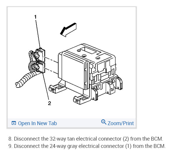

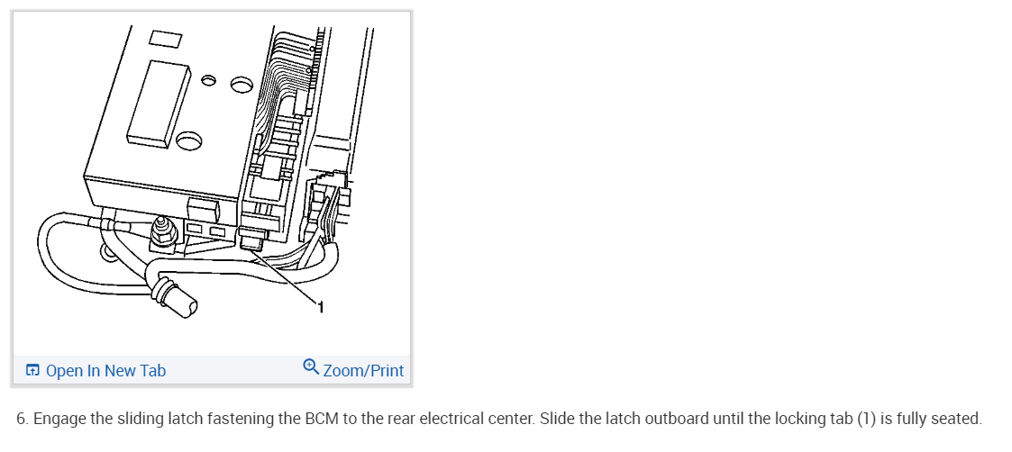

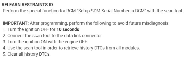

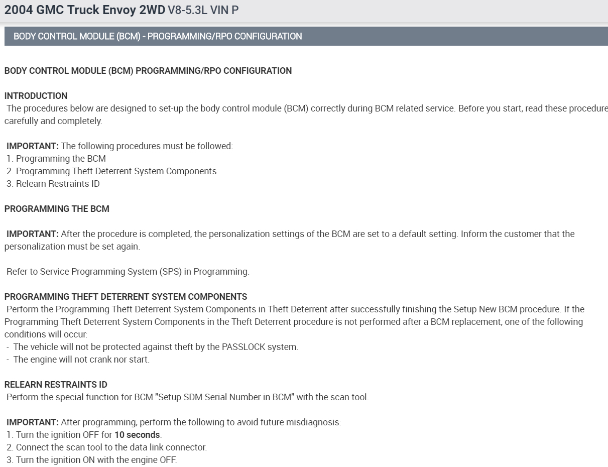

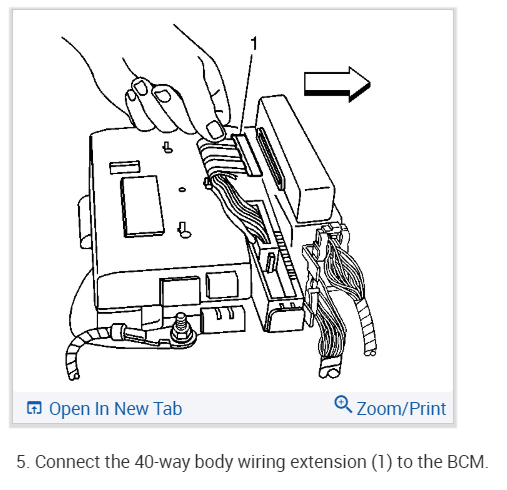

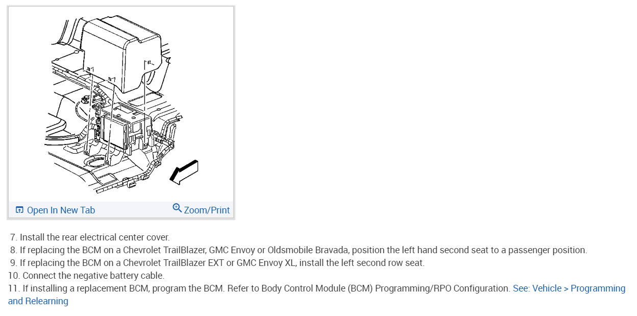

If I can jump in here is sounds like the BCM is bad but to be sure lets do a CAN scan which you can get a scanner from Amazon for about $50.00. here is a video to show you how:
https://youtu.be/InIlnsjOVFA
You don't need a subscription for the ones on Amazon and this will be handy in the future as well. Here is how you can change the BCM out in the diagrams below. Please let us know what you find. We are interested to see what it is.
