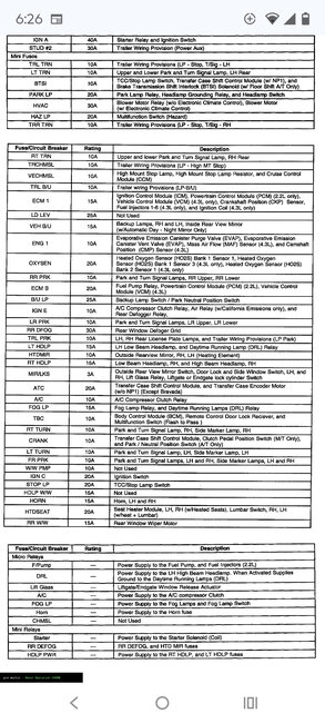

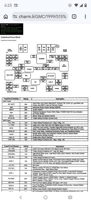

Now left side driver dash fuses are without power - 3,9,17,21,22,23

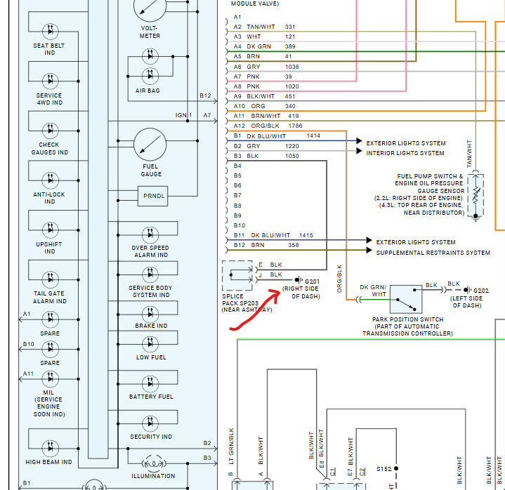

Replaced ignition switch , still no power to fuse 3 , 9 ,17 ,21 ,22 ,23

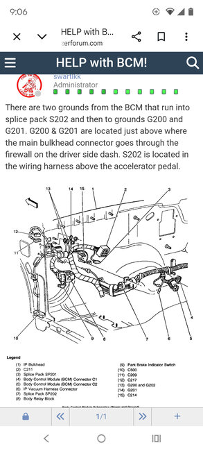

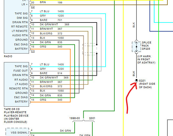

I cannot locate ground g201 , I've literally searched for hours .. I do not want to pull the entire dash apart , just hoping to find it , without knowing exactly where it is
I've removed basically everything underneath the dash except for the AC evaporator / ductwork
I was trying to find a short today - I saw where somebody put a test light between the positive cable and the battery , and if it lights up that means I have a short somewhere .. well it lit up and stayed lit after removing every single fuse under the hood and in the dash , which either means wherever the short is the circuit is not controlled by a fuse , or my test light is lighting up for some other reason .. again with positive cable disconnected and test light making a circuit between battery and said cable
I'm at my wit's end with this thing .. thanks for any and all ideas would be helpful

Seems that pulling and replacing the TBC fuse worked for about a day , then troubles would show again
Replacing with a new fuse daily made it work for the better part of a week , but now has no effect .. the only thing I can think of is that pulling the fuse was resetting part of the BCM somehow
