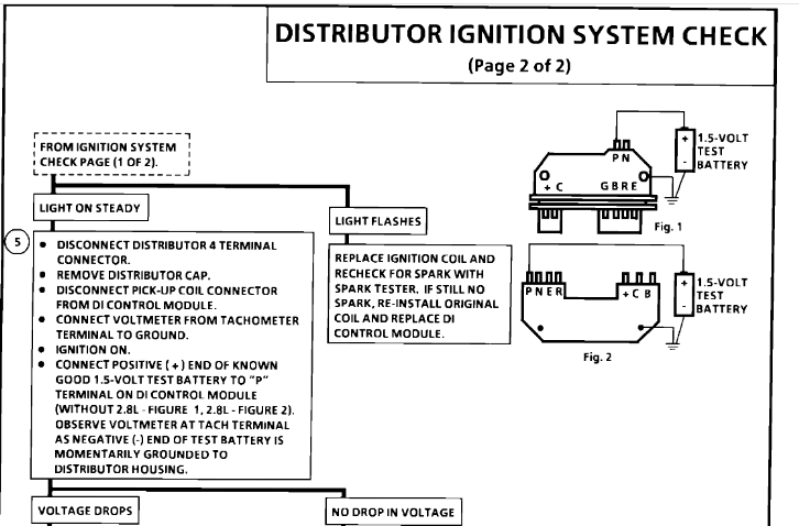

So, I got the truck from my uncle. It sat for a long time, probably 10 years or less, and I changed the ICM, distributor, spark plugs and the thing on the back of the distributor and i still have no spark. I don’t have any power to the radio or dash and stuff, and I cannot figure out what the problem may be. We tested the spark plug wires with a voltmeter and they were good. So, can anybody give me suggestions or answers that may solve this problem?

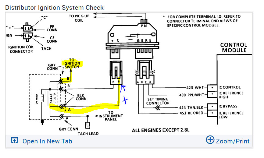

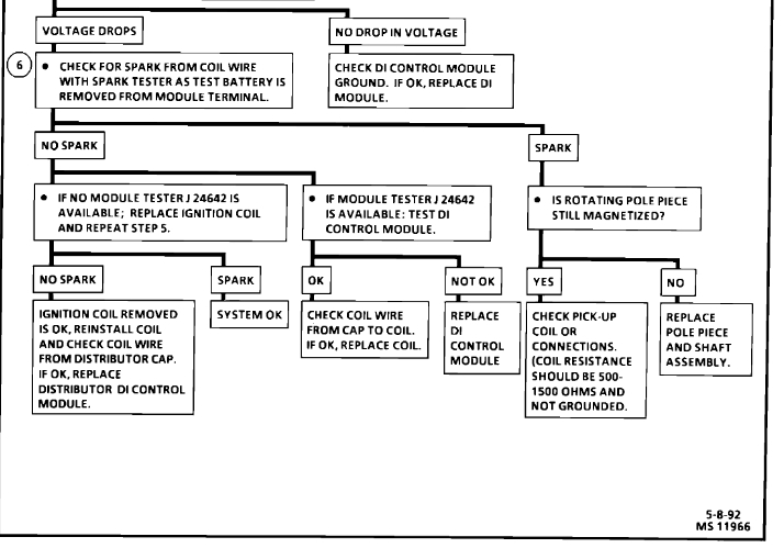

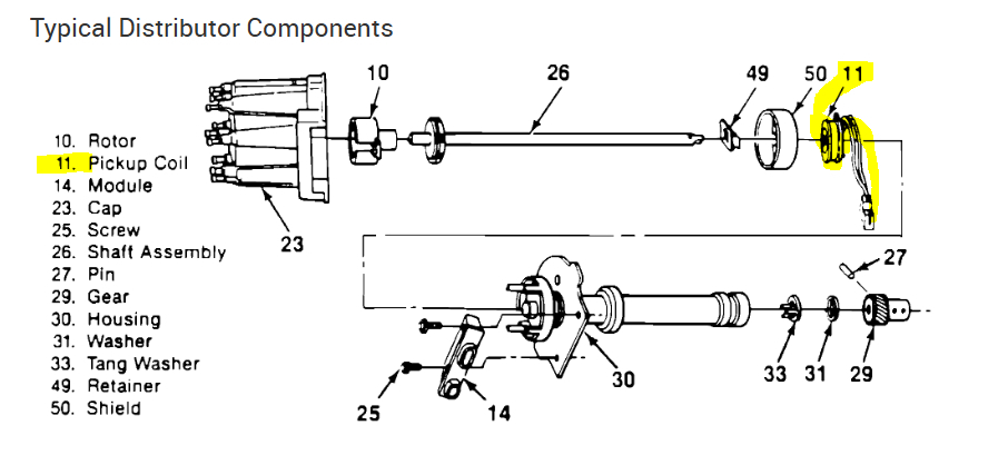

There should be power to the ICM when the key is turned on. See pics below. Check for power. Also, I realize the distributor has been replaced. Did it include a new pick-up coil?
If so, remove the distributor cap and have a helper crank the engine. Confirm the distributor is turning.
See pics below. Note: There are diagnostics included in the pics. Let me know if you are comfortable performing them.

As far as what I referred to, the easiest thing is to remove the distributor cap and have someone crank the engine to see if the rotor turns. Also, the pick-up coil is internal to the distributor, so I suspect it has a new one in it, but anything is possible.
See if the rotor turns and let me know what you find.

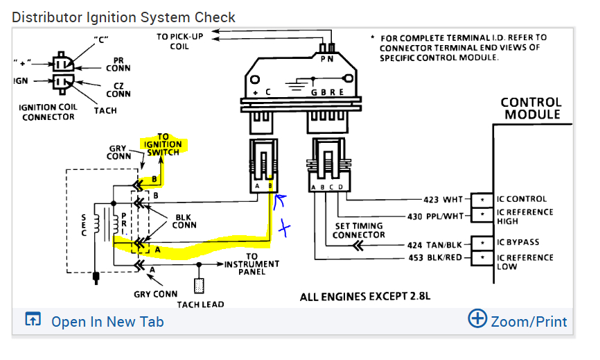

Also, the ICM is shown in the pic 1 above. Locate the C on the ICM two-pin connector. The wire that goes to the "C" on the module should have battery voltage when the key is in the run position. Let me know if you are comfortable performing this.
