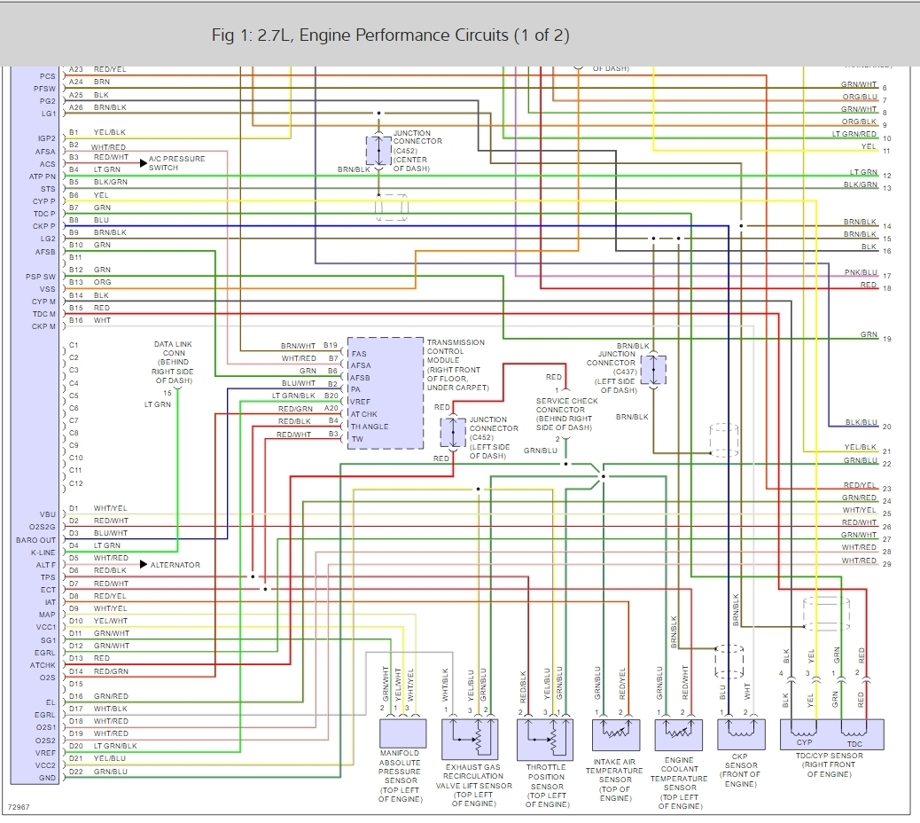

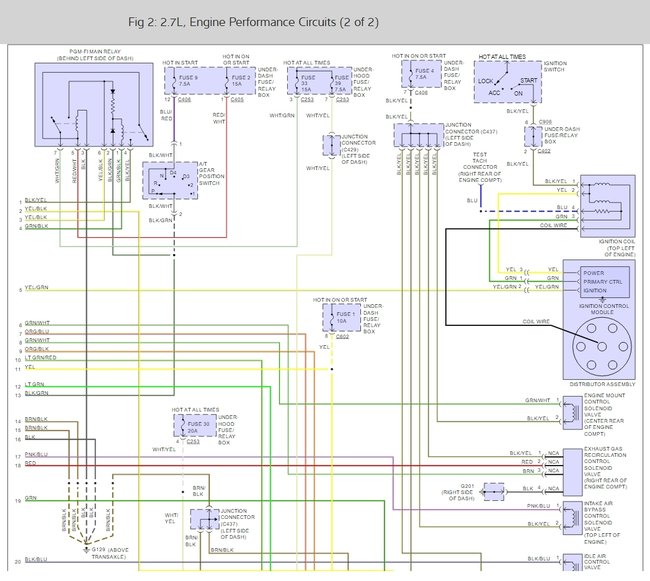

My car has problems starting in the morning. I discovered that there is no power going into the IAC valve from the car. I use a test bulb to check for power. Please can someone tell me what to do? The iac valve is in good shape.
Saturday, December 3rd, 2016 AT 9:30 PM
KEN L
  • MASTER CERTIFIED MECHANIC
  • 55,488 POSTS
Hey HASSAN,

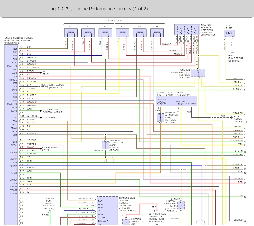

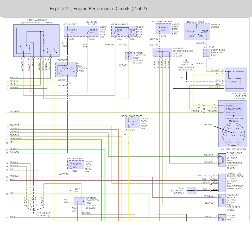

There could be a break in the wiring, here is a guides so you can follow and find the problem.
I see that there is a resistor block which the power the injectors which feed the IAC valve. Check that first.
Please run some tests and get back to us so we can continue helping you.
