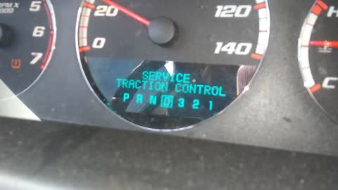

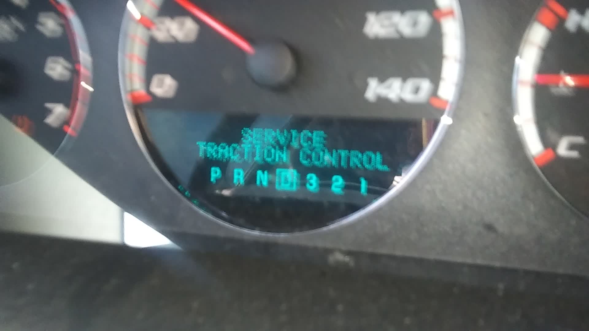

When I am driving my sedan door locks unlock and lock. Car seems to be going in and out of park to on my instrument cluster while driving.
What do you think can cause this?
I attached a video below

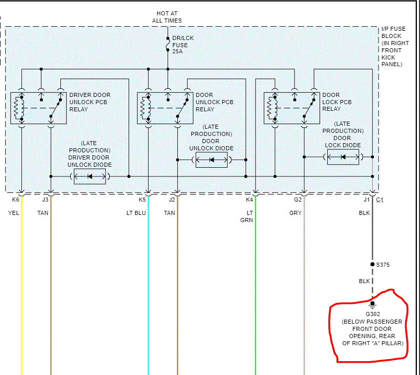

I watched the video and noted that the shift indicator would briefly jump to P when the locks were actuated. When you shift the car out of Park the doors automatically lock. There is a sensor in your shifter assembly which detects when the shifter has moved from park and then this locks your doors. On the other hand, the automatic door locks are controlled by the body control module which could be failing as well.
There is a door lock relay, but it is part of a printed circuit board and not replaceable.
Before we jump the gun and start checking or replacing everything, lets start by checking for a weak ground. If you look at the pic I attached, it shows where the ground for the circuit is located. Check that first.
Let me know what you find.

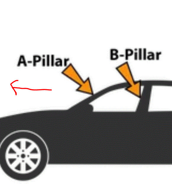

Which one is A pillar?
Sunday, April 26th, 2020 AT 5:45 PM
  • 110,192 POSTS
I attached a pic below to help. The arrow I added points to the front of the vehicle.
Let me know if this helps.

Ground came back good.

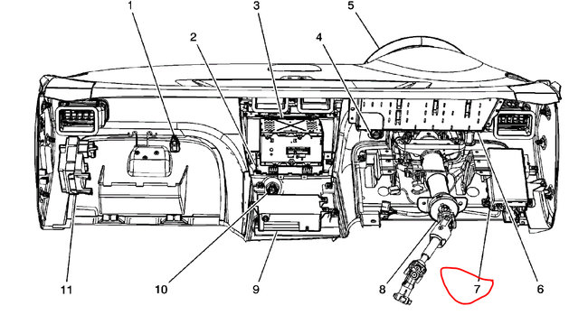

Can you check the body control in both vehicle and see if they have the same part number?
I attached a pic of location. The only concern is reprogramming. This will need done if replaced.

The BCM didn't fix it.
