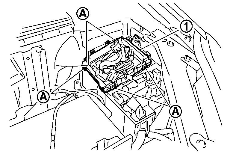

Well I'm glad to hear they found the problem. However, that is a lot of money. I know the IPDM has no serviceable parts. It has to be replaced as a unit. If you want to try and find one cheaper, I can give you the directions for removal and replacement. Let me know. It really isn't that hard to do. Actually, here are the directions. The attached pics correlate with the directions.
2009 Nissan-Datsun Truck Rogue 4WD L4-2.5L (QR25DE)
Removal and Installation
Vehicle Power and Ground Distribution Power Distribution Module Service and Repair Removal and Replacement Removal and Installation
REMOVAL AND INSTALLATION
IPDM E/R (INTELLIGENT POWER DISTRIBUTION MODULE ENGINE ROOM)
CAUTION:
IPDM E/R integrated relays are not serviceable parts, and must not be removed from the unit.
REMOVAL
1. Remove air duct (inlet). Refer to See: Air Cleaner Housing > Removal and Replacement > Exploded View.
2. Remove battery. Refer to See: Battery > Removal and Replacement > Exploded View.
Pic 1
3. Remove IPDM E/R (1) while pushing and opening pawls (A).
4. Disconnect connectors from IPDM E/R.

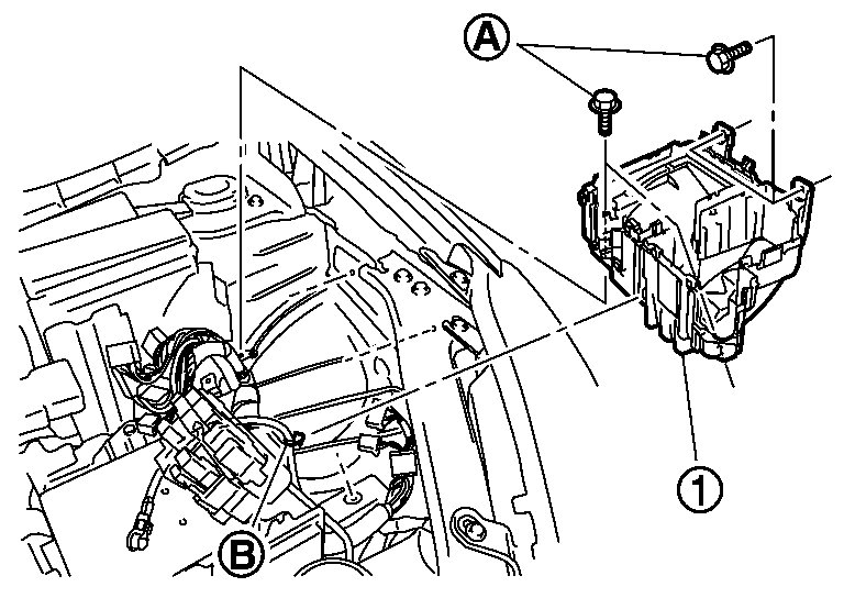

5. Remove fuse and fusible link block cover.
Pic 2
6. Unlock all pawls (A) of IPDM E/R bracket, and remove IPDM E/R bracket (1).
7. Unlock pawls of IPDM E/R cover A, harness cover A and harness cover B, remove them.
8. Disconnect connectors connected to fuse and fusible link block upper side, and remove fuse and fusible link block.

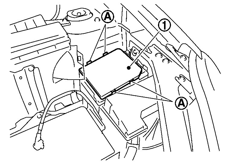

Pic 3
9. Remove IPDM E/R cover B mounting bolts (A) and battery cable fixed clip (B), and remove IPDM E/R cover B (1).
INSTALLATION
Install in the reverse order of removal.
