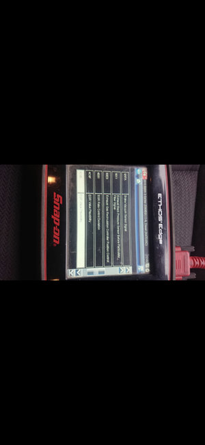

Had car on diagnostics machine which says EGR fault, had EGR off and cleaned, but car won’t start? Any help please?

Hi, thanks for replying. The car was starting fine but when cold it was going into like a limp mode. I had no power then I would have a burst of power and engine management light came on. After diagnostic check it came up EGR but mine is an electronic EGR valve. So was advised to clean it first and to see if that was the problem. After it was cleaned it wouldn’t start for a good hour. Eventually started and now engine management light has gone off? Confused, lol!!

However, can you get a little bit clearer picture of the codes because when I zoom in on it, it is blurry.

Yes, it wouldn’t start after been cleaned about an hour afterwards it started up. Engine management light stayed on for about 30 miles then went off. No lights or anything on dash anymore. Codes are 4afa…4011….40e9….4b81….4c9f.

Okay. So, if there are no lights and the vehicle is running properly then the cleaning may have taken care of it. These codes are most likely stored codes which just means the issue that caused them to come on is no longer present. These codes will eventually be cleared out of the memory, but they are not hurting anything by staying in there.
