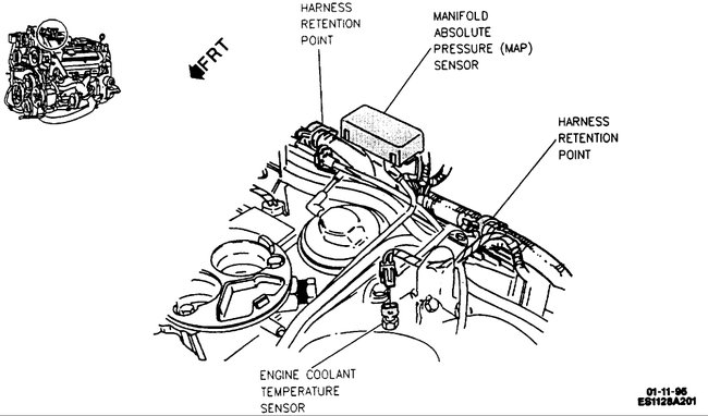

Where is the temperature sensor located?
Jan 18, 2018 at 4:10 PM
STEVE W.
  • CAR REPAIR CONTRIBUTOR
  • 15,167 POSTS
It is on the top of the engine near the upper radiator hose outlet at the transmission end of the engine. What is the issue you are having that is telling you it may be a problem?
