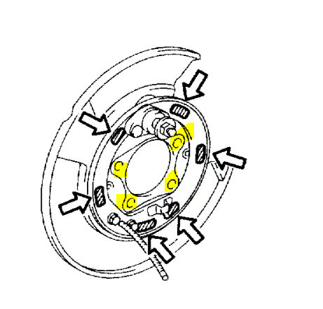

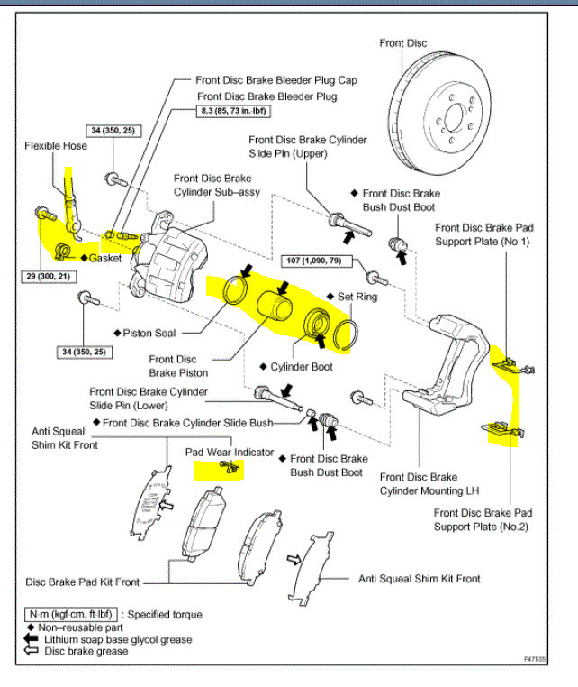

I attached a pic specific to your vehicle below. Everything needs to be removed except what I highlighted.
Let me know if I can help or if you have other questions.

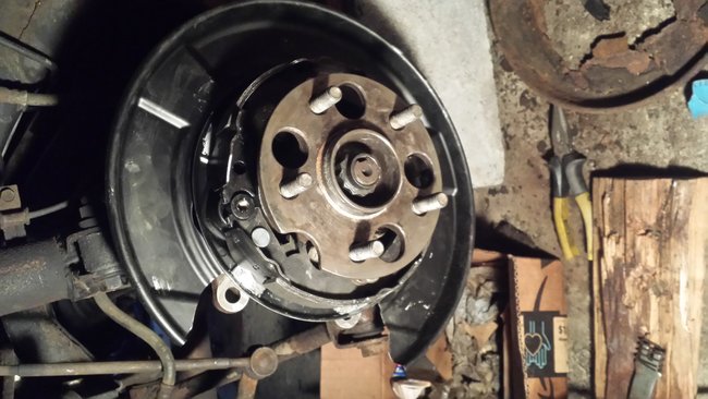

Thanks for your reply. But as Caradiodoc mentioned. I am referring to the rear backing plate. I know that I have to remove the parking brake assembly. But do I have to take off the wheel hub also to replace the rusted backing plate? See image of wheel hub and rusted off portion of plate. Thanks.

Anyway, yes the hub needs to be removed because it is actually mounted with the same bolts that hold the hub on. See pic 1.

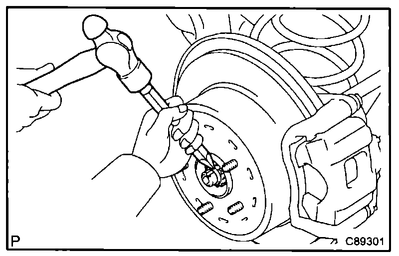

1. REMOVE REAR WHEEL
2. SEPARATE SPEED SENSOR REAR LH
pic 2

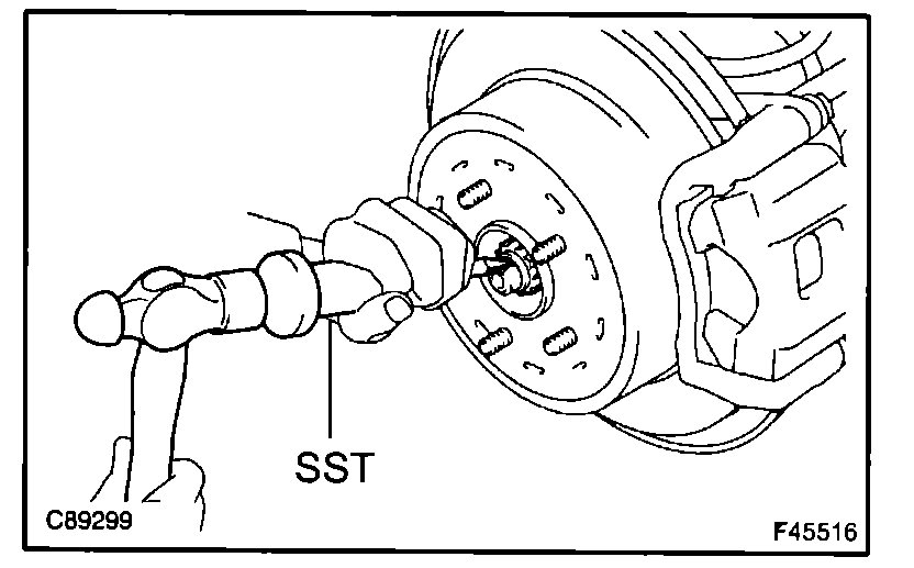

3. REMOVE REAR AXLE SHAFT LH NUT
(a)Using SST and a hammer, unstake the staked part of the axle hub LH nut. SST 09930-00010
NOTICE: Loosen the staked part of the nut completely, otherwise the screw of the drive shaft may be damaged.
(b)While applying the brakes, remove the lock axle hub LH nut.

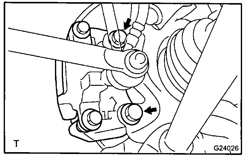

4. SEPARATE REAR DISC BRAKE CALIPER ASSY LH
(a)Remove the bolt, and separate the flexible hose from the shock absorber.
(b)Remove the 2 bolts and separate rear disc brake caliper assy.
NOTICE: Use a string or other device to keep the brake caliper from hanging down.

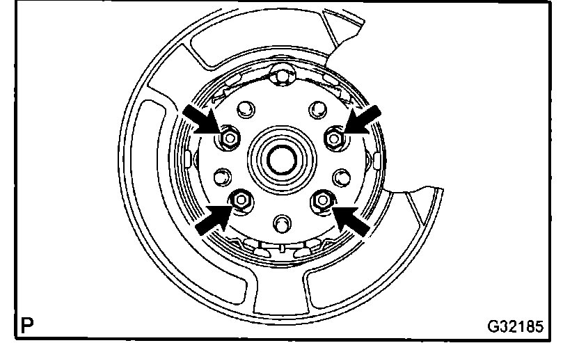

5. REMOVE REAR DISC
pic 4

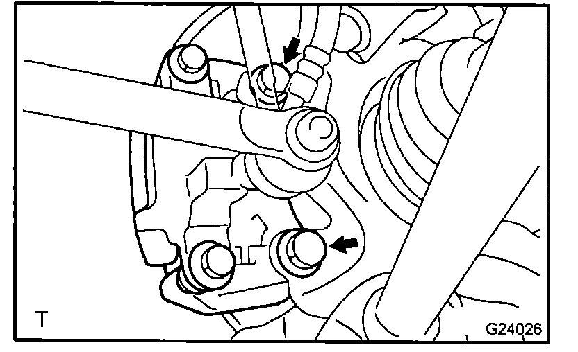

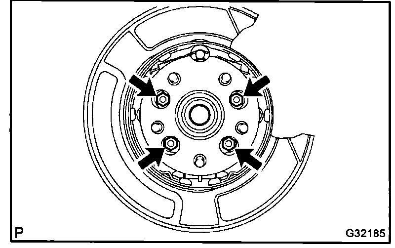

6. REMOVE REAR AXLE HUB & BEARING ASSY LH
(a)Remove the 4 bolts and the rear axle hub & bearing assy LH.
Pic 5

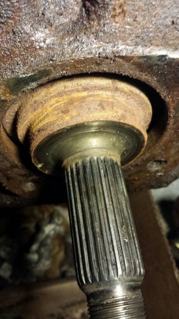

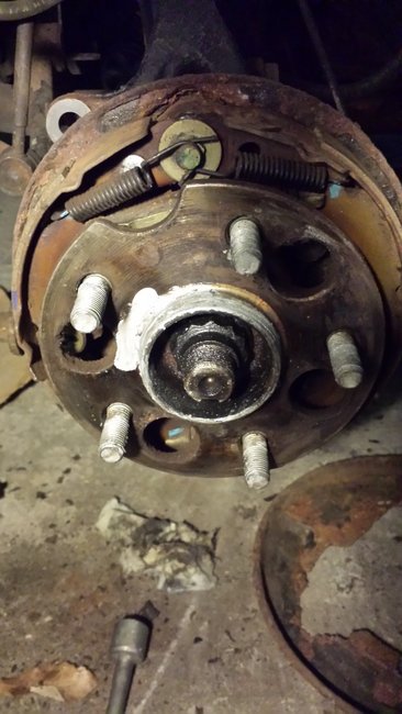

Hi Joe,

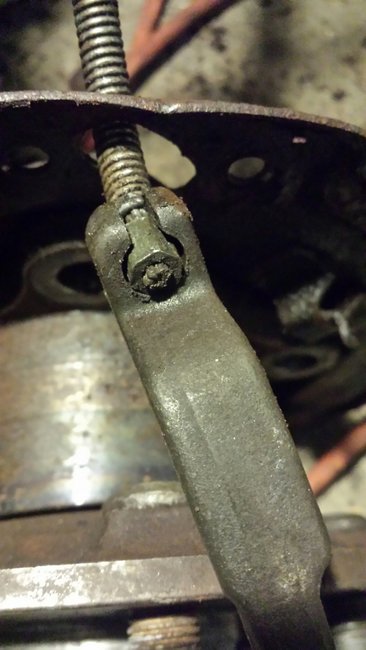

Hope you are having a Happy New Year. I am back with other questions. Please take a look at the attach pictures. After I cleaned up the rust on the spindle, do I apply bearing grease to the gear portion? (Picture 1) Second question, what tool do I have to use to get the parking brake cable from the attach brake hardware in order to run it through the new backing plate? (Picture 2).
Thanks,
tego

I use a large side cutter for electrical work. Squeeze the jaws between the loops of the spring, then use it to slide that spring back away from the parking brake lever. Squeeze tighter to hold that spring to the cable. That will provide plenty of slack to allow the cable to be tilted out of the lever.

TEGO
  • 9 POSTS
Hi Joe,
Thank you, that was so easy (lol). I had to laugh at myself for the fact that I did not think that the spring could move.

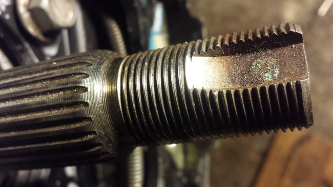

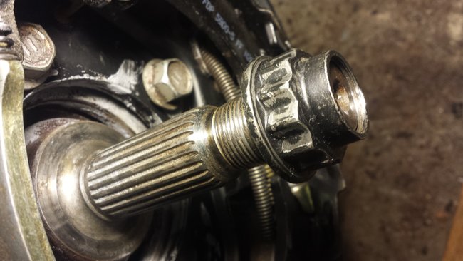

Joe,

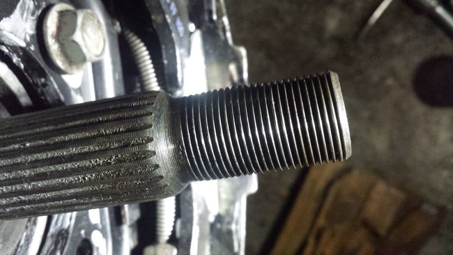

I was doing very well (see attached), now I am stuck and the new nut is not tightening far enough. I think I messed up some of the thread. Yes, I knew you told me to unstake the nut before removing it but I forgot to. Is there a way I can easily repair the spindle thread?
Tego
Monday, January 18th, 2021 AT 10:35 AM
  • 110,192 POSTS
Is it the spindle or the nut which is bad? I can't tell by the pic. As far as repairs, it really is based on how bad the damage is. I know there are thread cleaner sets that function as taps that will repair a damaged thread, but if they are too badly damaged, it won't help.
Can you get a close up of the damage so I can better see it?
Monday, January 18th, 2021 AT 7:09 PM
TEGO
  • 9 POSTS
I believe the spindle thread got messed up when I tried to tighten the nut using socket and wrench. Because it got stuck at the point where the cut out starts on the spindle. I took it off and tried hand tighten it but that's as far as it will go. I think it needs to go another 2 inches to be flush with the bearing hub. I hope I explained it good enough so you can understand it. The picture shows the spindle on both sides and with the nut up to cut out.
Thanks,
Tego
Tuesday, January 19th, 2021 AT 8:15 PM
  • 110,192 POSTS
The threads on the axle look really good. Are you sure the nut isn't bad?
Wednesday, January 20th, 2021 AT 4:29 PM
TEGO
  • 9 POSTS
I bought a new nut (M22 x 1.5mm Dorman Spindle Lock Nut Kit 615-224) and that one is not going on at all. Unless it is not the right size. What do you think?
Thanks for your help.
Tego
Wednesday, January 20th, 2021 AT 9:50 PM
  • 110,192 POSTS
If it is the wrong one, it won't work. Are they sure at the parts store that they gave you the right one? Can you make a video showing what is happening with both? If I was there, it would be much easier, but chances are we are a thousand miles apart. LOL
On the axle, inspect the starter threads to make sure they weren't damaged.
Let me know. In the worst case, we will need to replace the axle. I will help you through that and they aren't that expensive.
Also, I looked at your pics again and everything looks good. I'm not sure what is causing the problem. Ask the parts store to pull an axle for your vehicle and then compare the axle nut they sold you and the one on the new axle.
