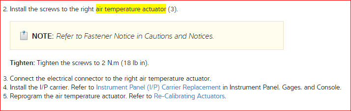

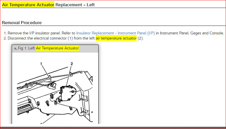

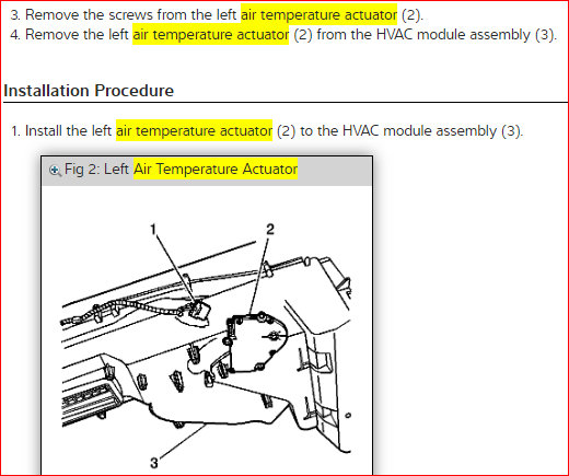

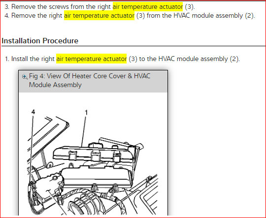

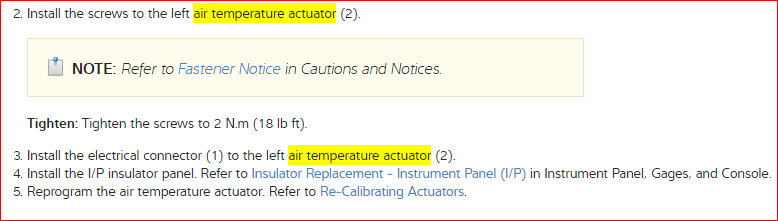

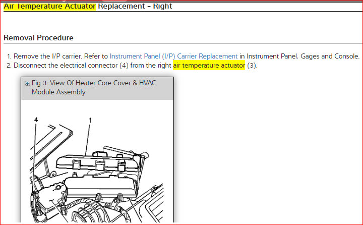

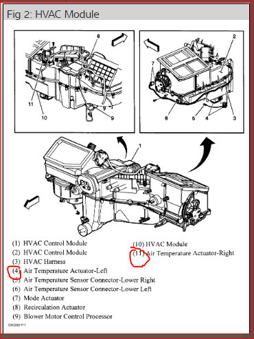

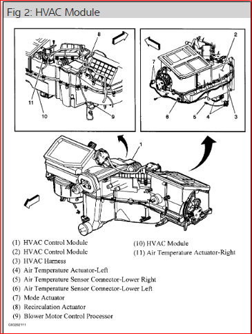

Hi, I am trying to find out where the right temperature door actuator and left are located. And if this parts are the same ones for both sides? Please help.
Sep 28, 2018 at 12:32 PM
DANNY L
  • CAR REPAIR CONTRIBUTOR
  • 5,648 POSTS
Hello, I am Danny.
I have attached step-by-step pictures as a how-to replace the actuators and their locations. I have also attached a tutorial showing what is involved. The actuators are the same part for both sides. Hope this helps and thanks for using 2Carpros.

Hi, I have one more question. Are the two temperature blend door are on the top of the dash? Or is the passenger one located on the black bottom box?
Sep 29, 2018 at 11:07 AM
DANNY L
  • 5,648 POSTS
Hello again.
I have attached the picture again. #4 and #11 in the picture are the actuators. Hope this helps and ask any questions if needed.Thanks again for using 2Carpros.
