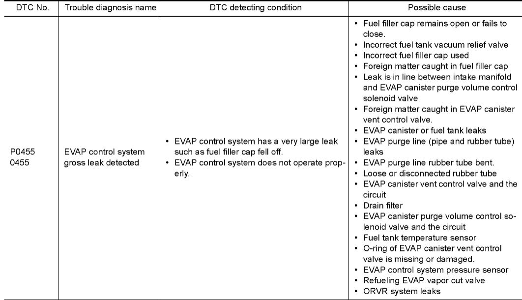

P0455 refers to a very large leak (fuel filler cap fell off etc, ) in EVAP system between the fuel tank and EVAP canister purge volume control solenoid valve.
P0457 also relates to a vacuum leak in the evaporative emission system.
It could be just as simple as the gas cap loose.

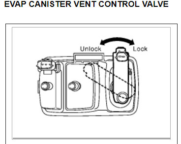

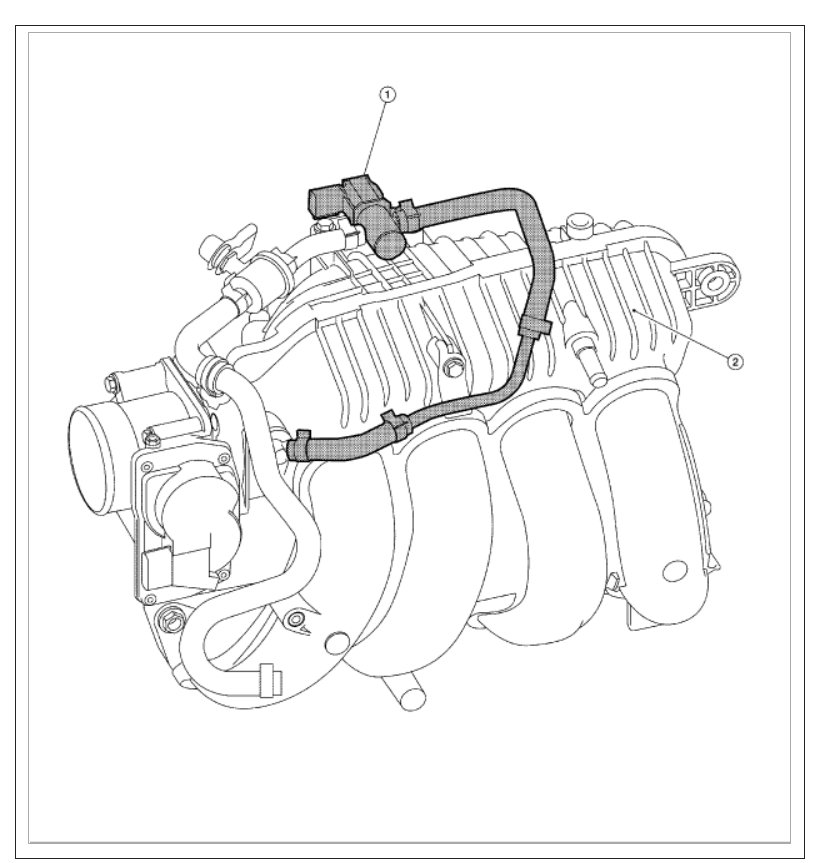

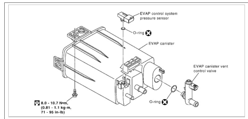

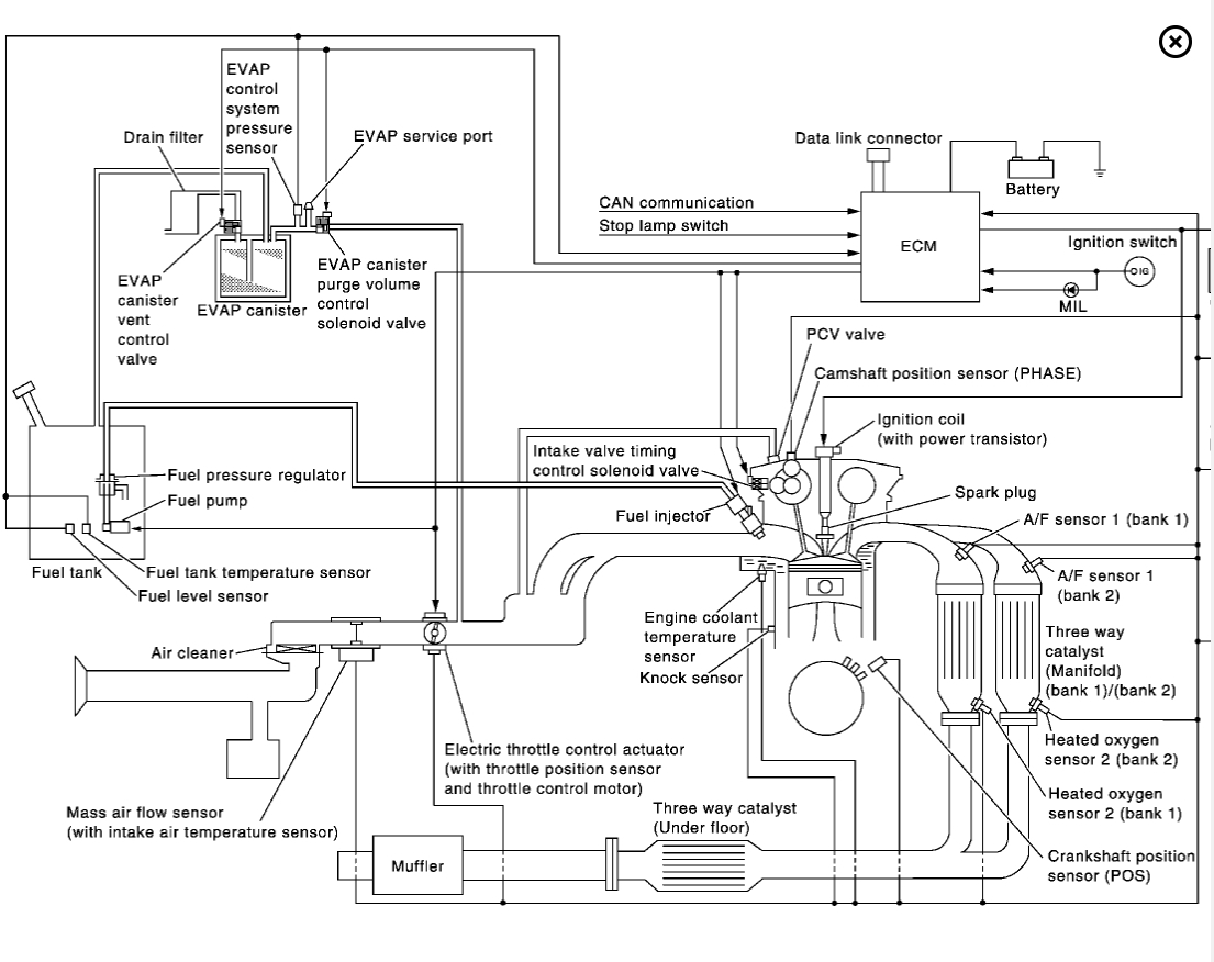

Here is the system lay out so you can start inspecting hoses and checking the EVAP valve. Check the gas cap like PATENTED_REPAIR_PRO suggested and then all hoses, if everything looks good I would suspect the charcoal canister. Check out the diagrams (below). Please let us know what you find. We are interested to see what it is.

The code criteria for the P0457 on that car basically says the EVAP test saw a large change in the in tank pressure within thirty seconds of the system reading a change in fuel level. The most common cause = bad fuel cap or rusted/damaged filler neck that does not allow the EVAP system to even start to pull a vacuum on the system.

The code that came back was P0447. I cleared the code and it came back immediately. So yesterday I got the car back and I removed the solenoid. It felt like it came out funny. Checked the hoses. Blew into the solenoid, it was open like it should be. I reinstalled solenoid and blew back into the hose. I heard it in the tank, then the air came back out. It felt like there was an issue maybe with the o-ring on the solenoid. I cleared the code and went on a ten mile test drive, no light. What is the paint can style smoker? How much are they? Hopefully this is fixed. Thanks so much for all the help, I appreciate it very much.
