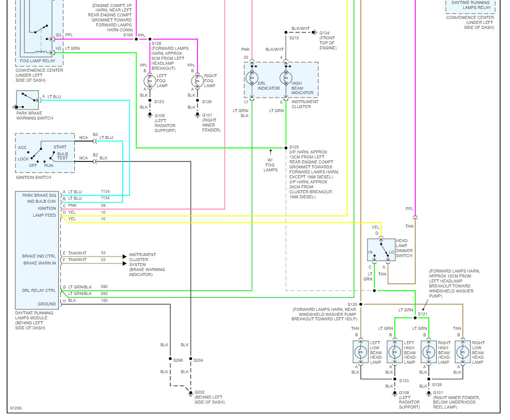

High beam headlights not working.
Wednesday, May 24th, 2023 AT 10:21 AM
KEN L
MASTER CERTIFIED MECHANIC
55,322 POSTS

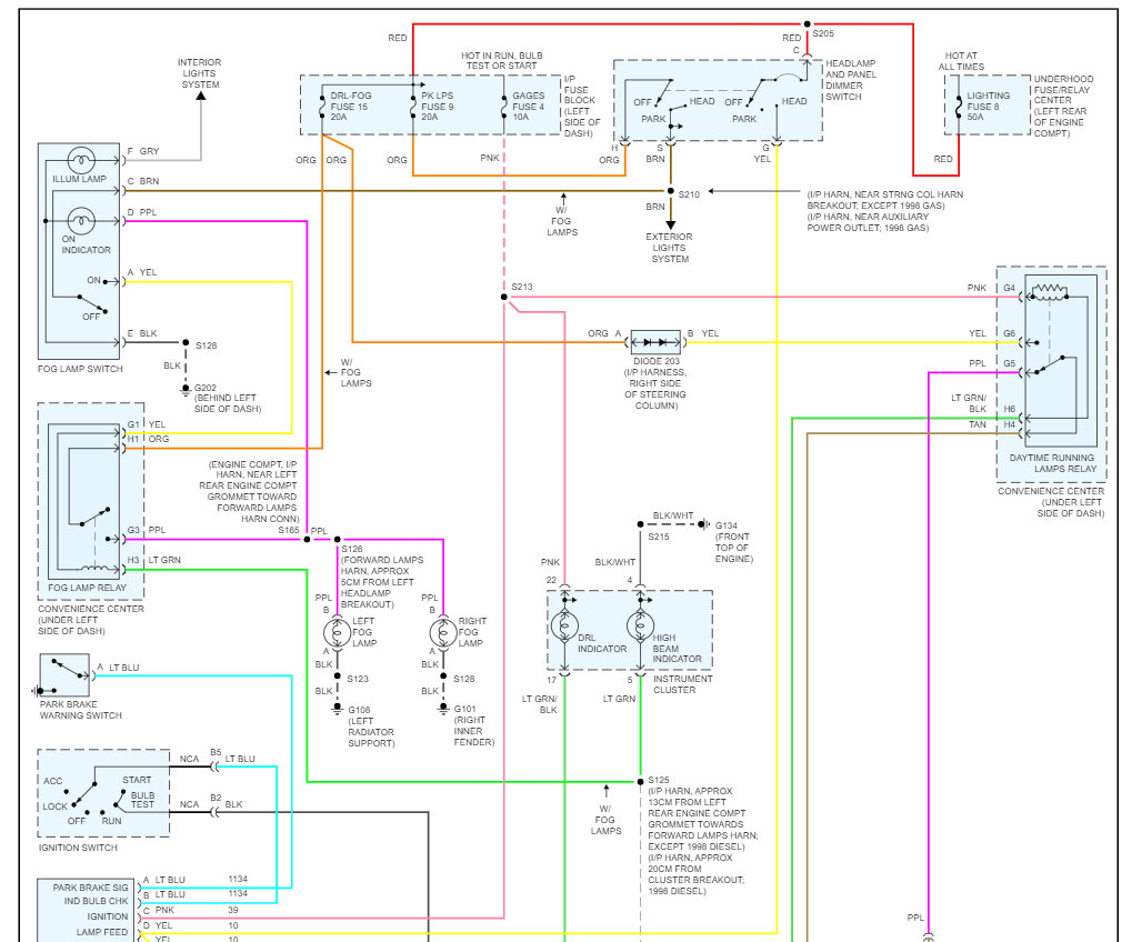

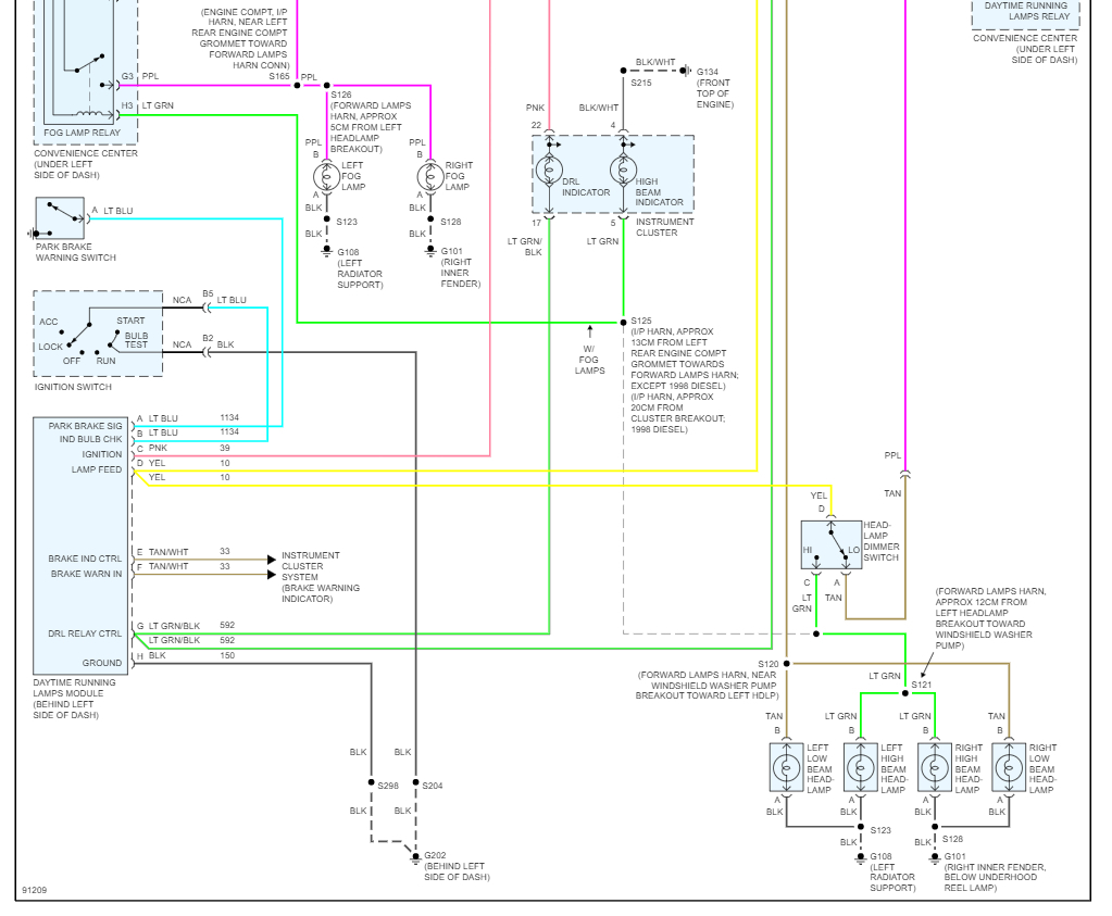

Yes, it could be the DRL module here are the headlight wiring diagrams and a guide to help you check for power so you can see where you lose power from.
