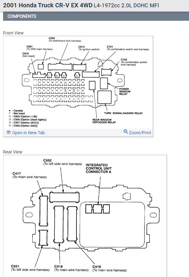

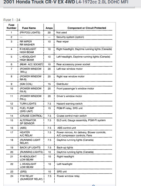

First check the fuse. Check the fuse box that is located on the left side of the steering wheel, under the dash. Should be number 11, 20A fuse.
