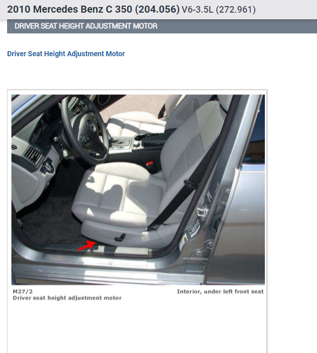

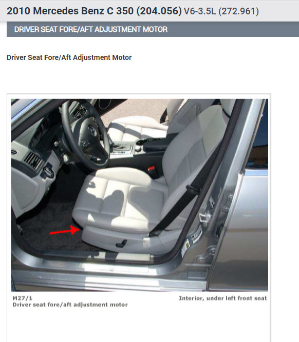

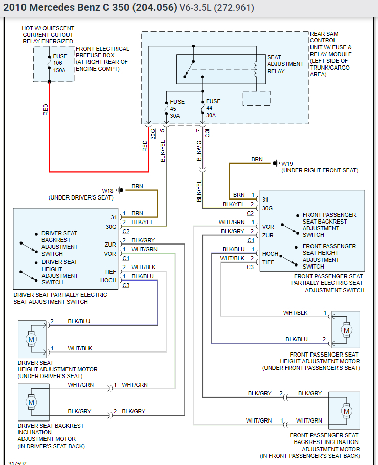

The drivers seat is stuck. Doesn't move forward or backwards, up, down, nothing. What could be the problem?
Here is the VIN: WDDHF8HB7AA138562

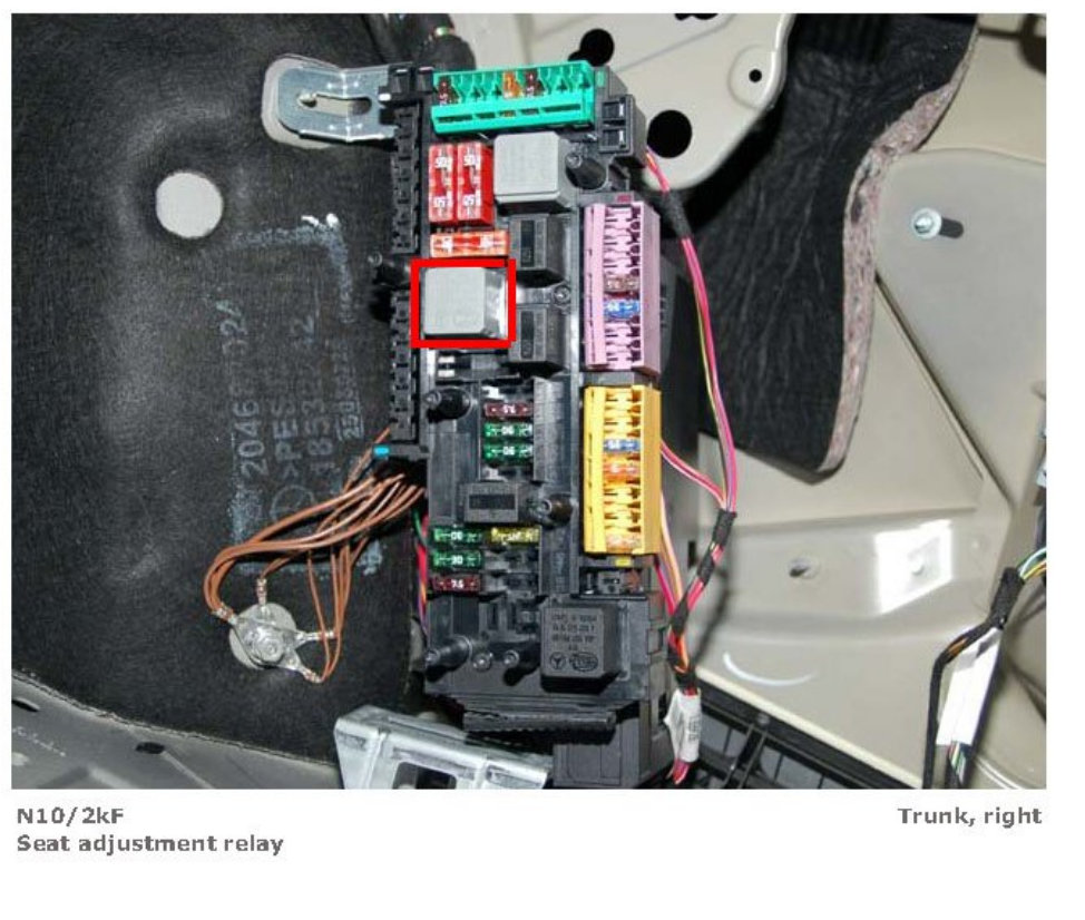

You could have a bad motor, switch or relay.

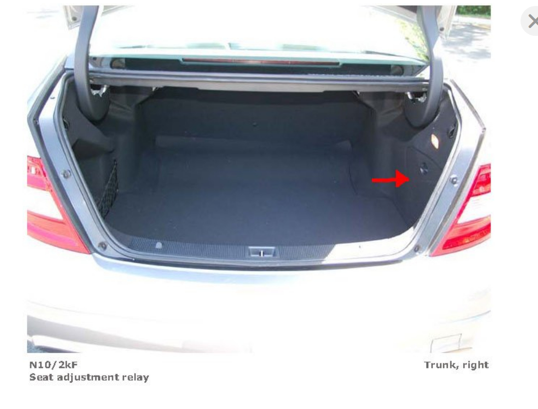

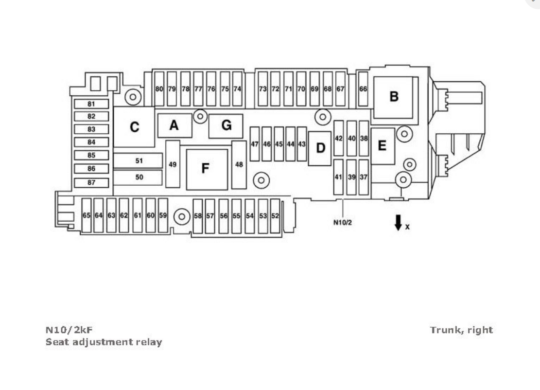

First check the relay. It is located in the trunk in side the right hand side panel (see pictures below).
Inspect the relay for any corrosion or burn pin(s).
You can also test the relay.
If the relay is good then you will have to check to see if you are getting power to the switch and check the motor. But start with the relay.
Let me know what you find.

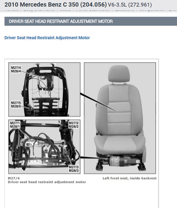

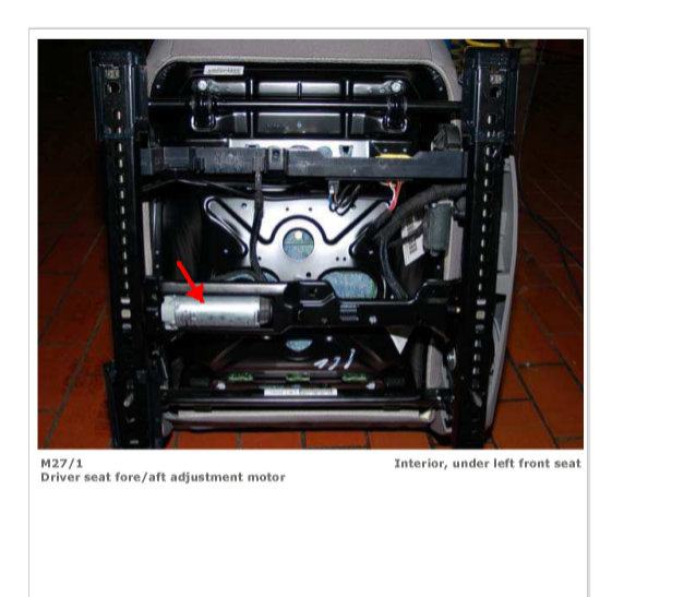

SQM
  • 6,383 POSTS

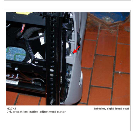

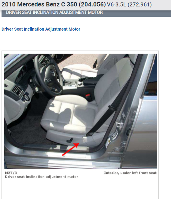

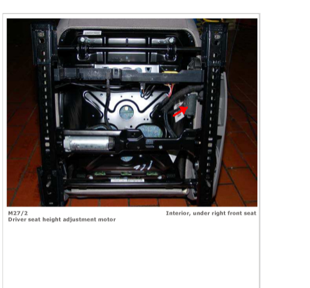

This car has motor control module as few motors for the seat.
I have attached the location for each of those.
Let me know if you have any questions.

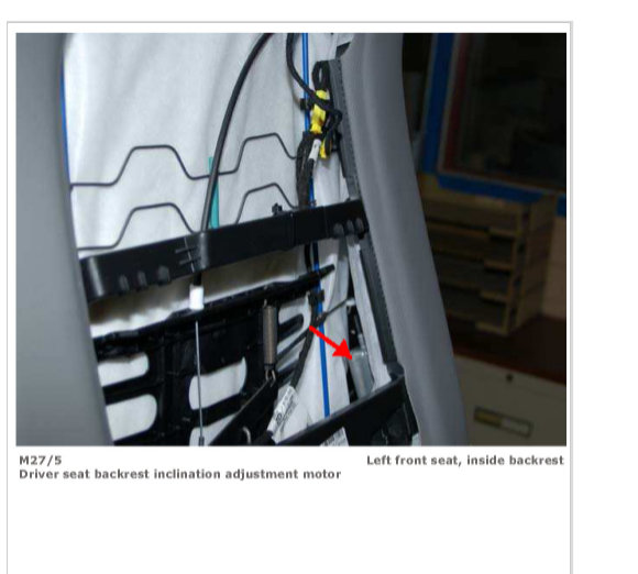

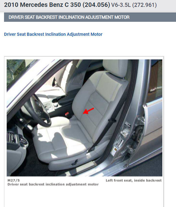

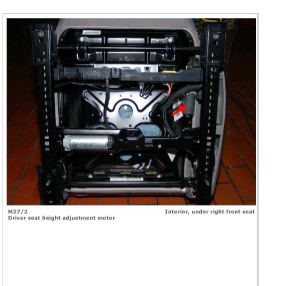

SQM
  • 6,383 POSTS
There are 4 motors for the driver seat. I have attached the pictures for each ones location.
Since none are functional it is likely the relay.
The relay is located in the trunk (see picture below).
Saturday, September 18th, 2021 AT 1:24 PM
IMAGING
  • 151 POSTS
The fuse was checked and has power, replaced the relay and still nothing. What else could it be if not the 4 motors like you said. The last resort will be to check the motors for power. What do you think is the best solution?
Monday, September 20th, 2021 AT 10:51 AM
SQM
  • 6,383 POSTS

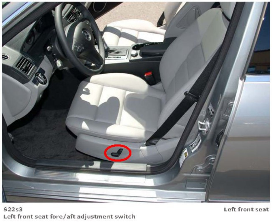

Check the switch to see if it is getting power.
Monday, September 20th, 2021 AT 11:05 AM

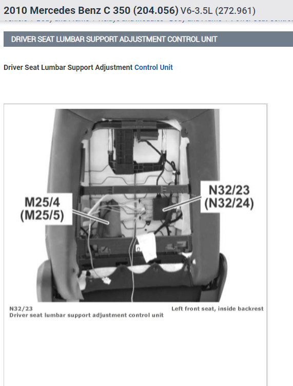

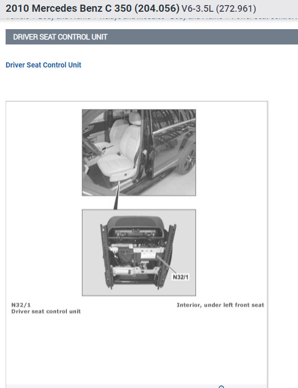

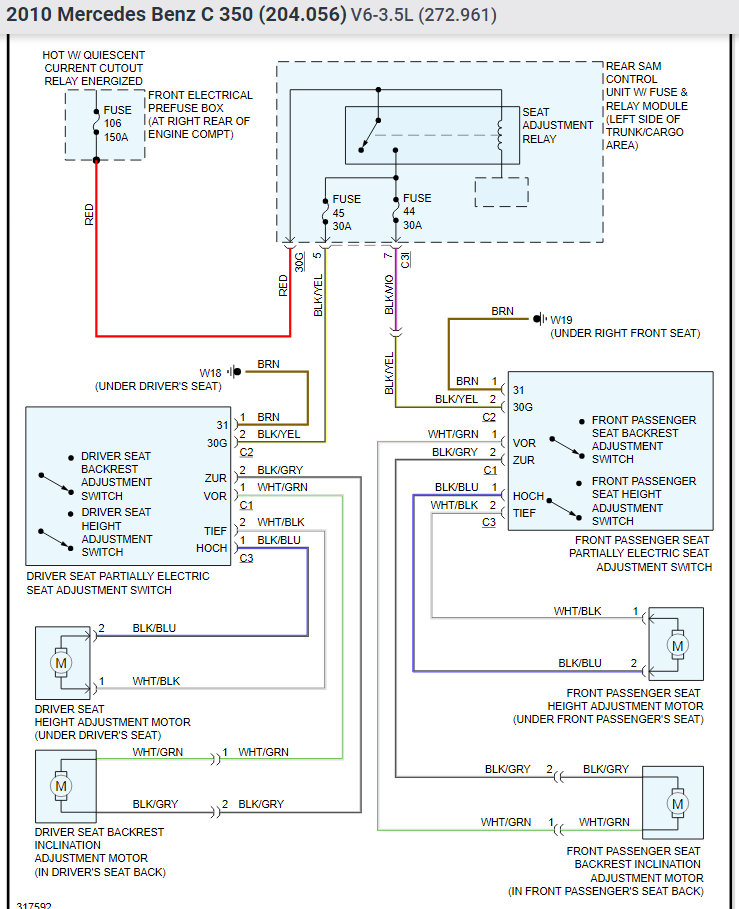

SQM
  • 6,383 POSTS

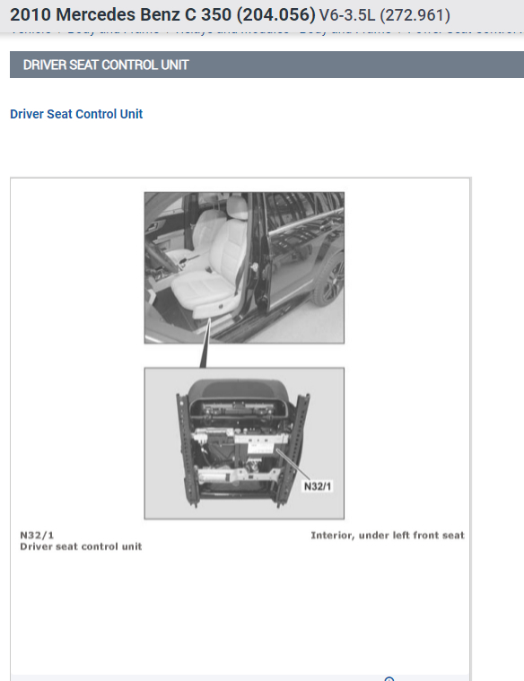

Then the next item to check would be the control module for the motors. They are located inside the seat as well. If you look at one of the answer to the top that has the motor locations also have module location.
Monday, September 20th, 2021 AT 11:47 AM
IMAGING
  • 151 POSTS
Which one if the pics you sent shows the control module?
Monday, September 20th, 2021 AT 1:13 PM
SQM
  • 6,383 POSTS
See below please.
Monday, September 20th, 2021 AT 1:15 PM
IMAGING
  • 151 POSTS
So just replace the control module? How can you test it to see if it's working?
