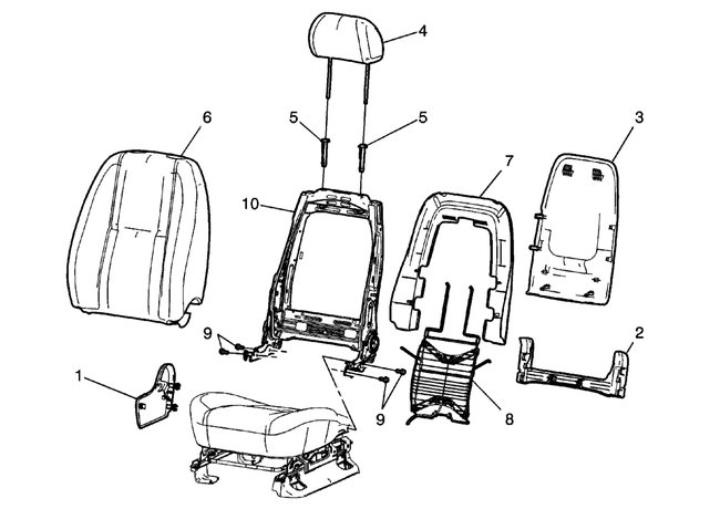

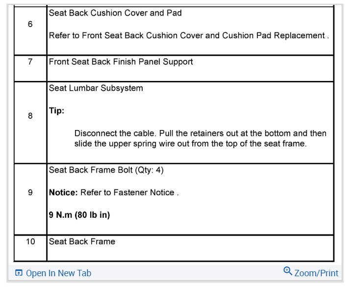

It seems every other function of seat works. When trying to apply more or less lumbar, nothing happens and lumbar just makes a motor working sound. It will move up and down but just not inflate.
Any ideas? How hard of a fix? Are there airbags in the seat which make it tricky to work on? It's a new truck for me.

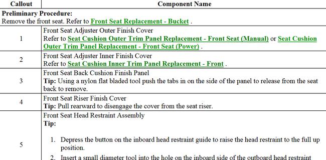

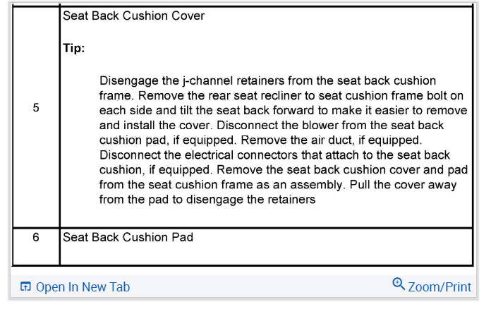

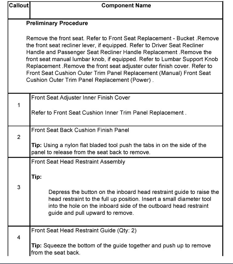

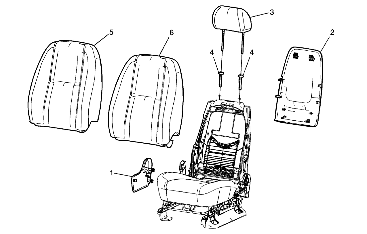

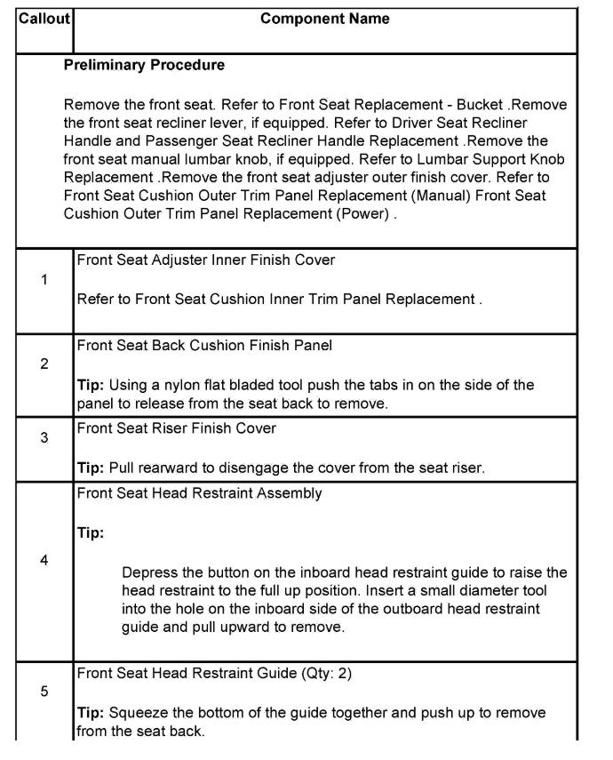

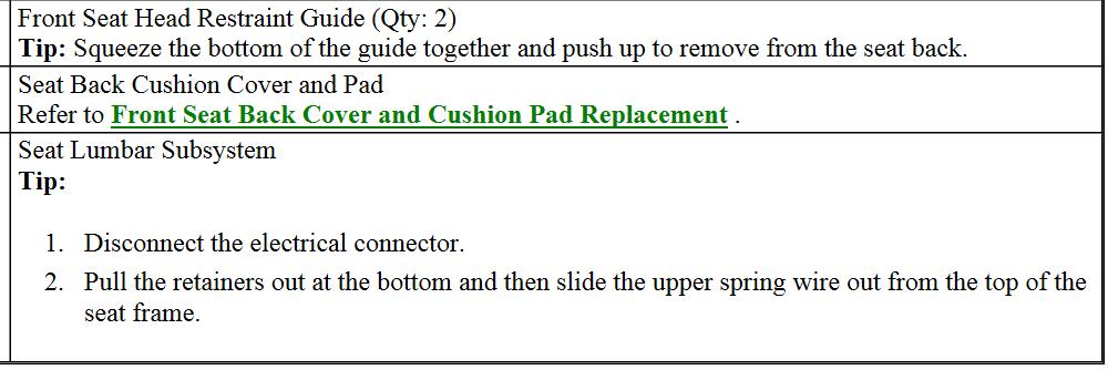

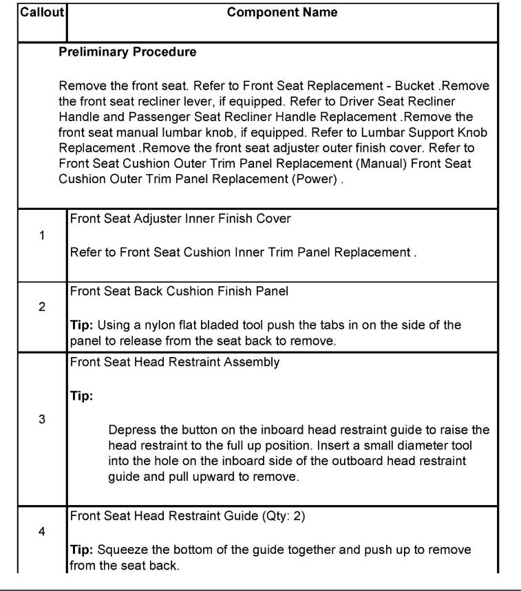

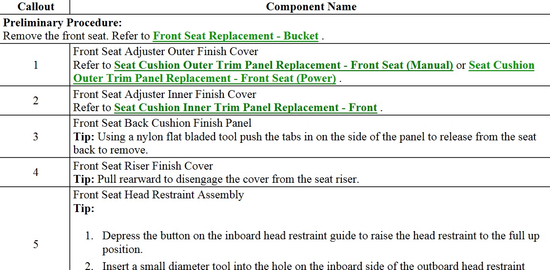

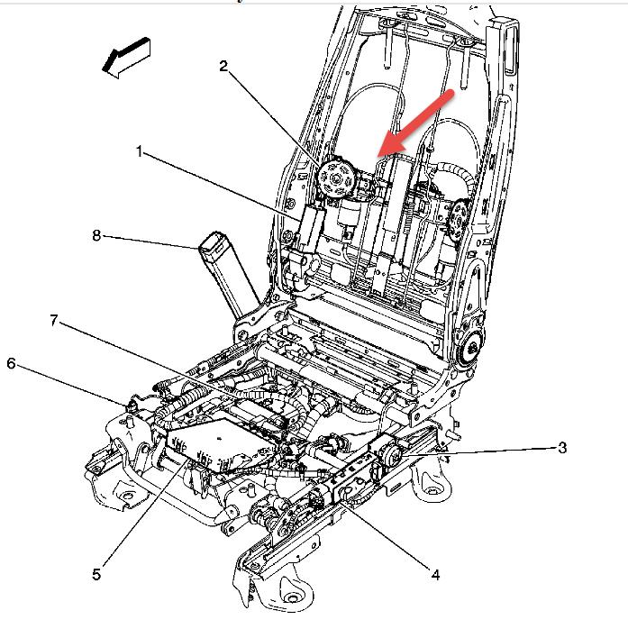

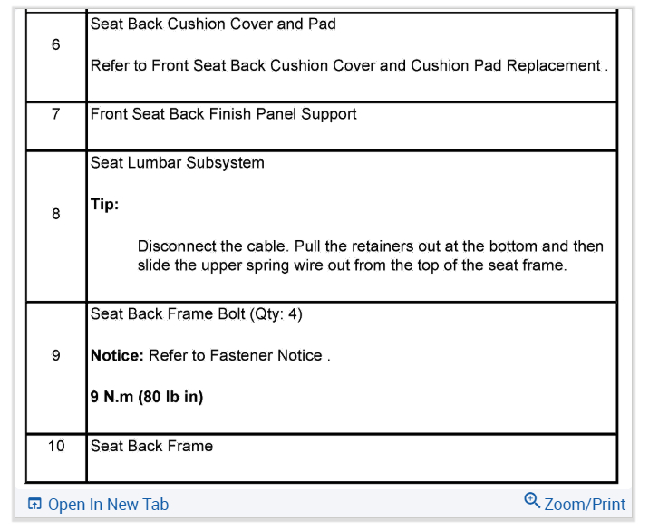

Here is the repair manual, I found more info in the diagrams below.
https://www.2carpros.com/manuals/manuals.php
