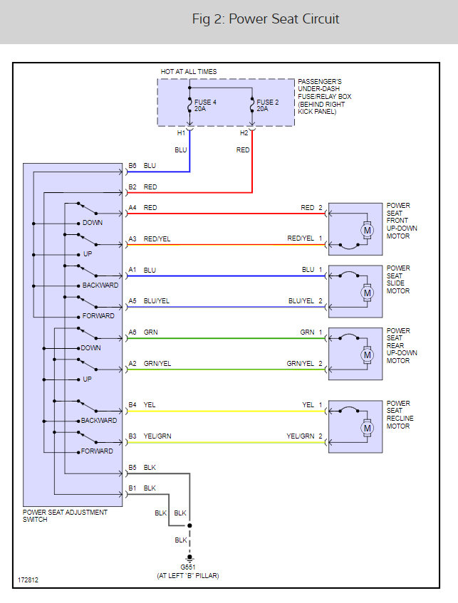

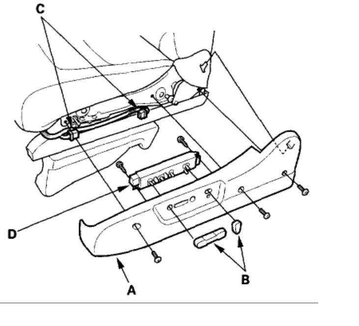

Driver seat does not move forward and back, also does not move up and down at front end. I checked motor one by one by give direct twelve volts all three working good. I check trackaldo. I got second button switching assembly but have same response. Headrest means back of seat is working and up and down is working at rear end. But does not work on front end up and down and does not work forward and back. Waiting for your response. Thanks

Strip motors from seat and check slide mechanism and tilt lever, if the motors work it will be a mechanical problem with the seat.
Nov 12, 2017 at 10:24 PM
MAHMOOD1
I give power direct to motor after installation of seat. It moves forward and back good.
Nov 12, 2017 at 10:26 PM
  • CAR REPAIR CONTRIBUTOR
  • 54,189 POSTS

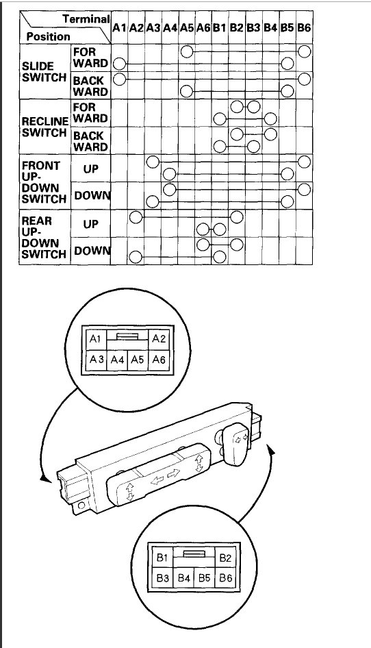

It sounds like a switch or a fuse problem. Here is a guide to show you how the power and wiring goes along with a copy guides to show you what to do.
and
Check to see where you loose power.

Test the switch terminals for the forward and backward movement. Use a multi-meter to check for 12 volts at the terminals. If it has 12 volts, the switch is bad and needs to be replaced.
