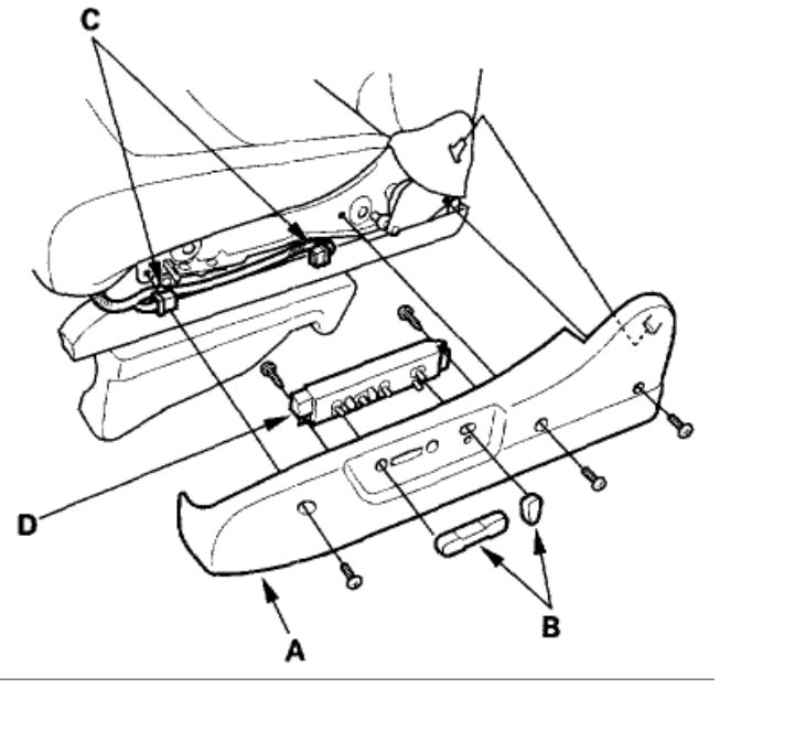

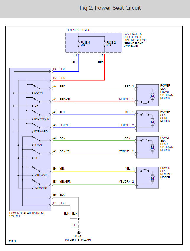

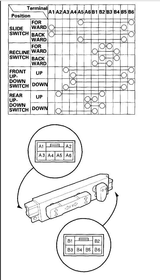

Driver seat does not move forward and back, also does not move up and down at front end. I checked motor one by one by give direct twelve volts all three working good. I check trackaldo. I got second button switching assembly but have same response. Headrest means back of seat is working and up and down is working at rear end. But does not work on front end up and down and does not work forward and back. Waiting for your response. Thanks

Strip motors from seat and check slide mechanism and tilt lever, if the motors work it will be a mechanical problem with the seat.

I give power direct to motor after installation of seat. It moves forward and back good.

It sounds like a switch or a fuse problem. Here is a guide to show you how the power and wiring goes along with a copy guides to show you what to do.
and
Check to see where you loose power.
Wednesday, November 15th, 2017 AT 6:11 PM

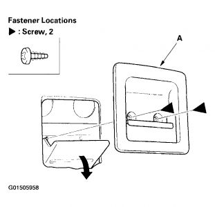

When I pull the release lever for the 3rd row, it will no longer fold flat into the floor. (The seat back still folds down, but the bottom will not flip over into the floor)
It feels like there is no resistance - maybe a cable is broken/unattached? This happened suddenly and with no indication anything unusual had occurred.
Will this be expensive to fix? Rough guesstimate on cost? Does ithave to go to a Honda dealer or could another mechanic do it? Is this a difficult repair - anything I could do myself?

Hi bellabuggy,
Most probably the latch is stuck and not releasing from the strikers.
Remove the recliner Lever trim to see if any cable is detached.
