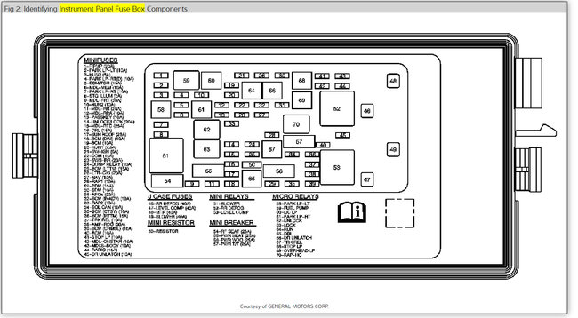

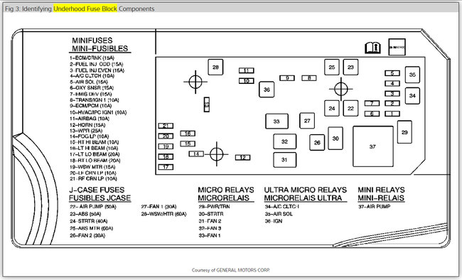

We need to test the STGILLUM #8 fuse in the interior fuse panel. here is a guide to help with the fuse locations below:

thanks for the video. it is suppose to light up on both sides please replace the fuse lets see what happens.

I replaced the fuse, no luck...

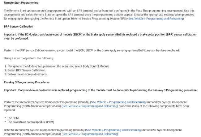

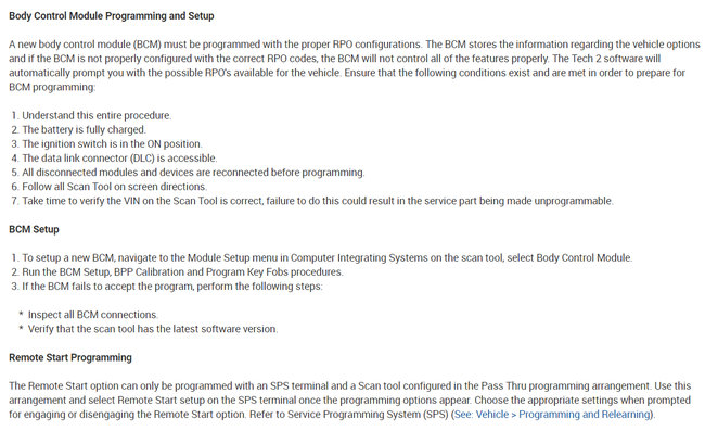

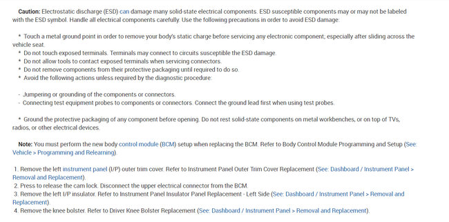

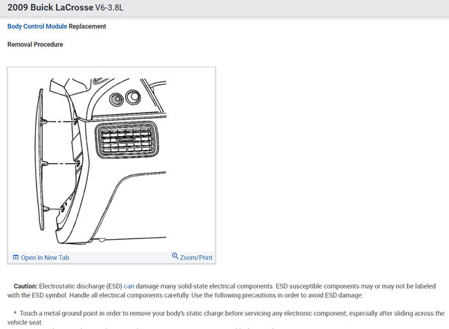

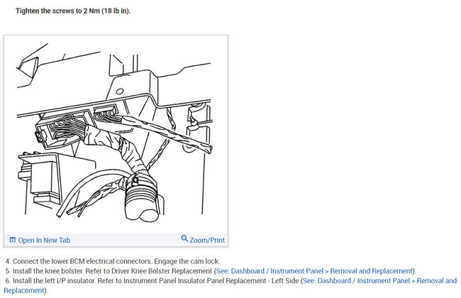

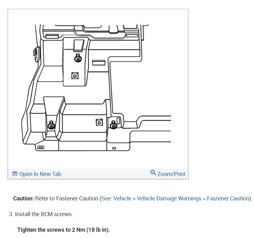

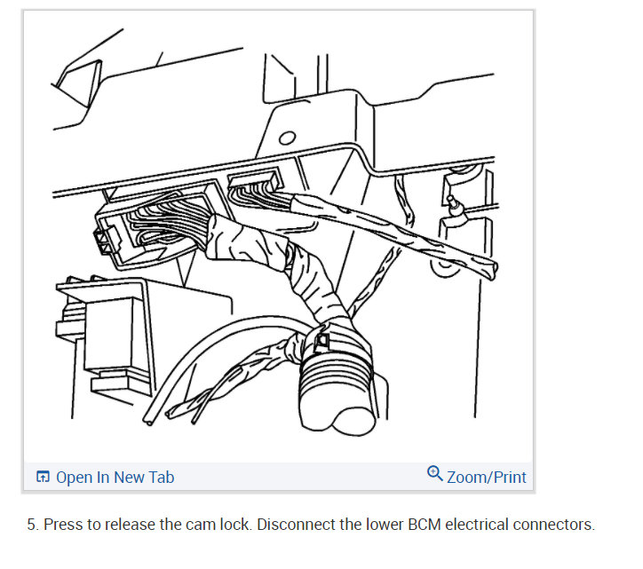

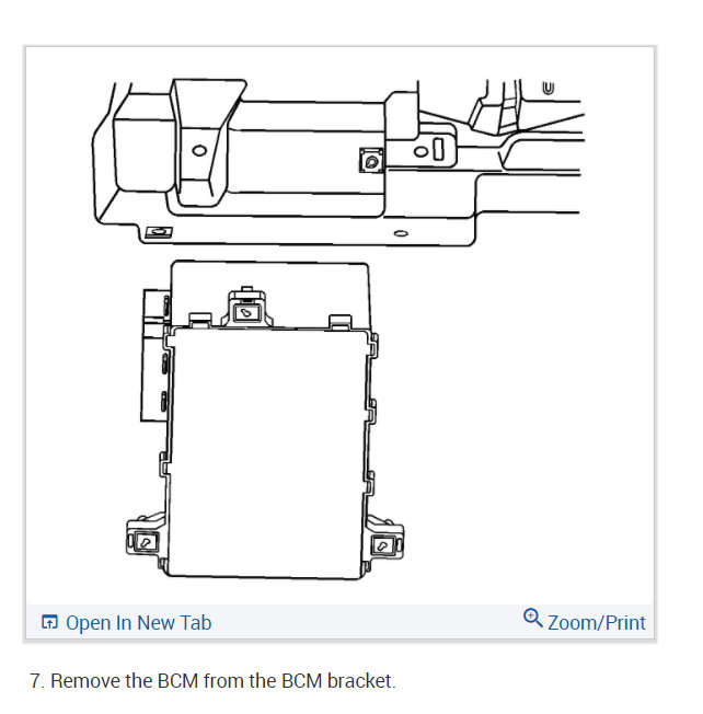

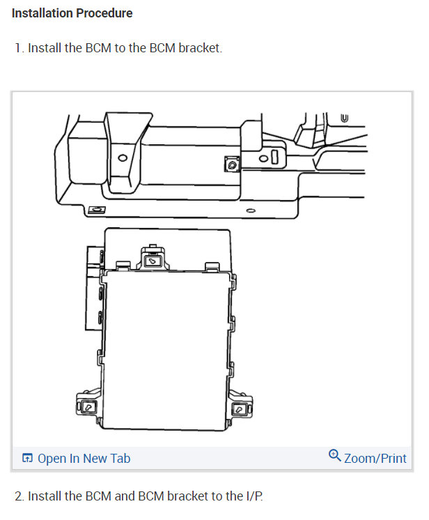

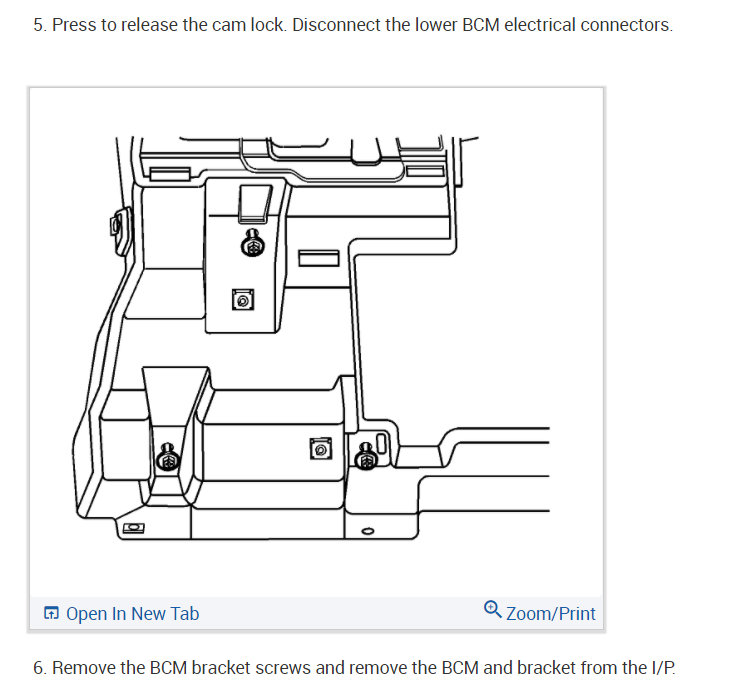

Okay, it looks like the BCM is going out. to be sure lets do a CAN scan which is the future of automotive repair. you can get a CAN scanner from Amazon for about $50.00. here is a video to show you how:
https://youtu.be/InIlnsjOVFA
Here is how you can replace the BCM. Check out the diagrams (below). Please let us know what happens.

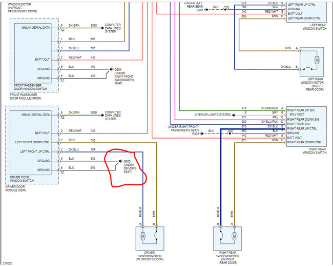

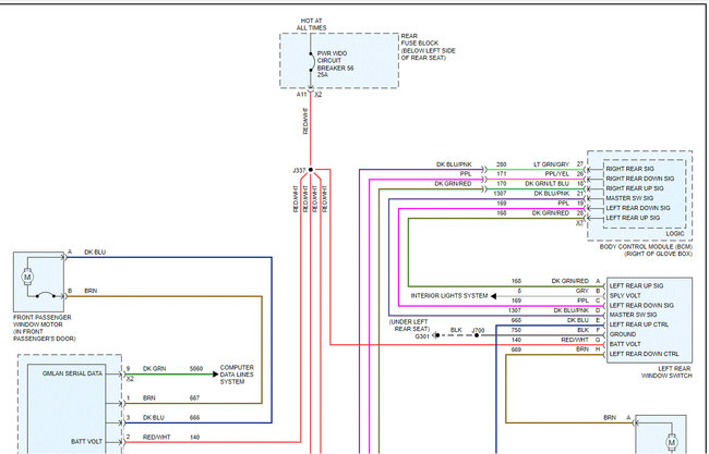

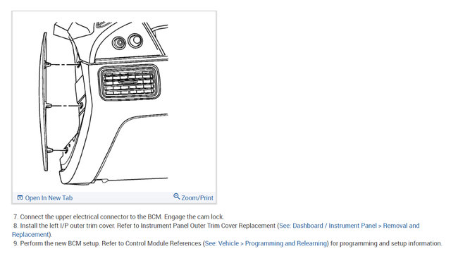

I attached the wiring schematic for the power windows so I could get a good look at the driver's switch. Here is what I want you to try:
First, I need you to check the ground for the door module. If you look at pic 2 below, I circled it and its location. Confirm there is continuity to ground via the two black wires.

I wasn't able to locate the ground wires unfortunately, too many blocking my view. I will try again tomorrow.
