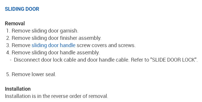

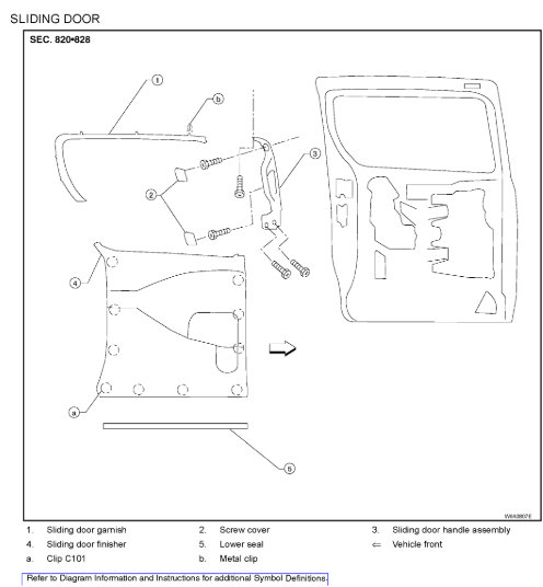

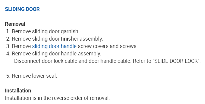

Hello, how do you remove the passenger side sliding door panels? The door is locked and won’t open from inside or outside.
Thursday, April 30th, 2020 AT 10:08 AM
DANNY L
MECHANIC
5,648 POSTS
Hello, I'm Danny.
Here is a basic tutorial showing what is involved for interior door panel removal:
https://www.2carpros.com/articles/door-panel-removal
I've attached 2 pictures below for the sliding door panel removal for your Quest.Hope this helps and thanks for using 2CarPros.
