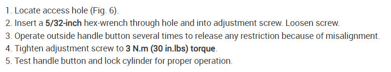

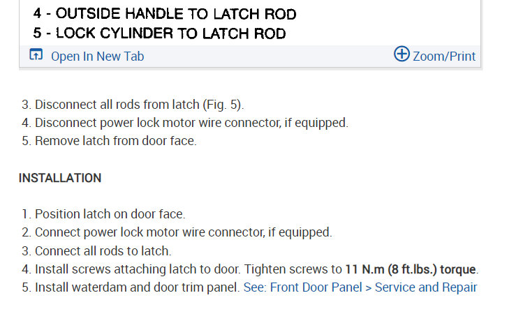

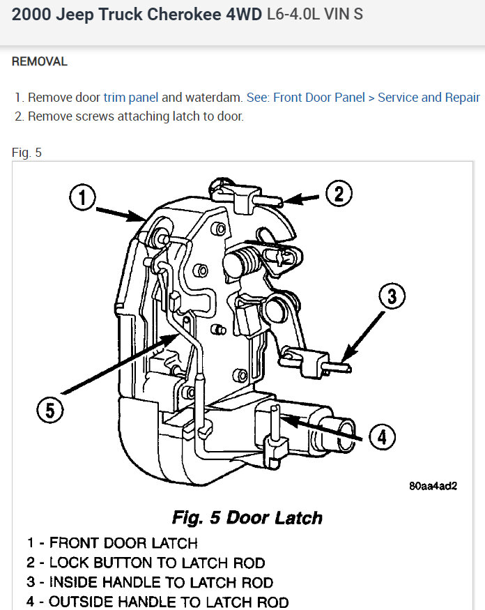

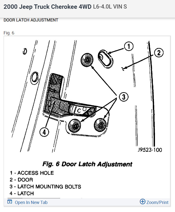

How did you send the message? I didn't receive one. Anyway, I am here, this problem can happen when the door latch becomes worn out or needs adjustment. Usually, it is the front driver's door but to be sure start the car and leave it in park, then step outside the car and shut the door. While the doors are shut grasp the door and without trying to open the door and pull outward to see if you can get a reaction from the locks, this will be the door the latch is bad on. Here is how to replace the latch. Also, there is a chance the right front door lock switch module has gone bad. You might want to disconnect it to see if the action stops. Check out the images (below). Please upload pictures or videos in your response to the problem so we can see what's going on.
