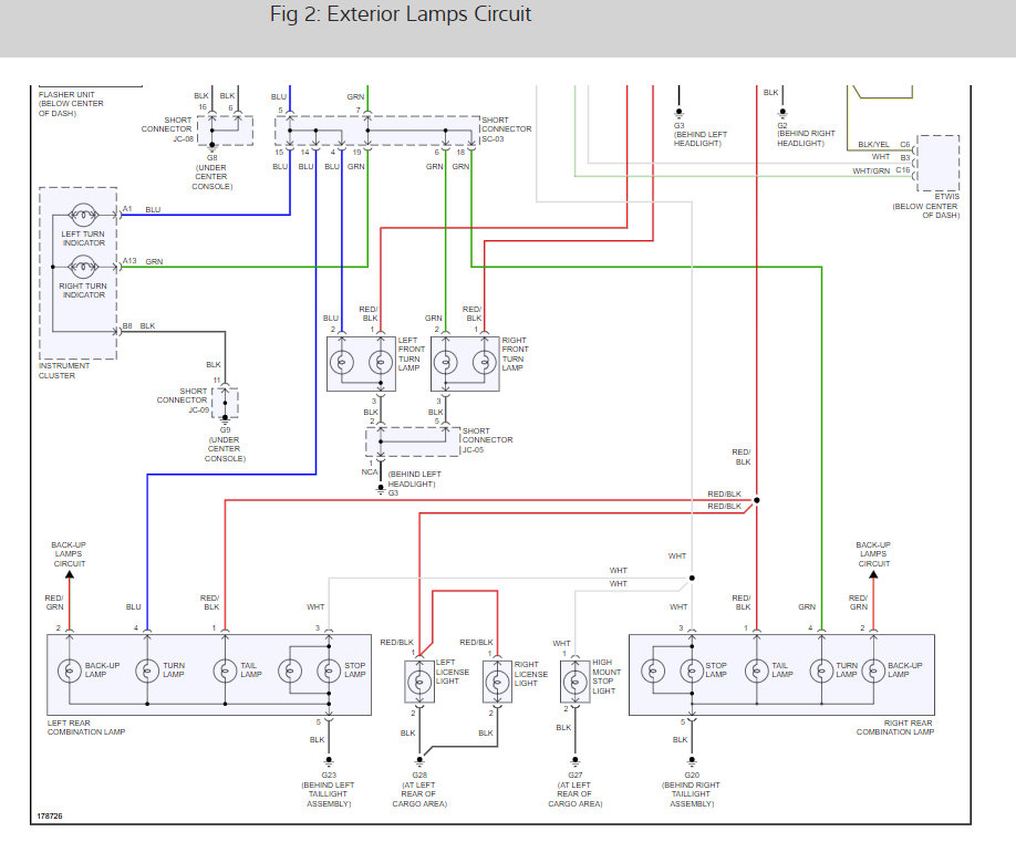

parking lights stay on
2003 KIA SEDONA
119,000 MILES
MATTANDCHRISANN
The door a jar light and dinger is on as wells as my parking lights are always on. I sprayed the door latches and still the door light and dinger are still on.
Also I do believe my airbag clock spring is bad because I also don't have power to my windows.

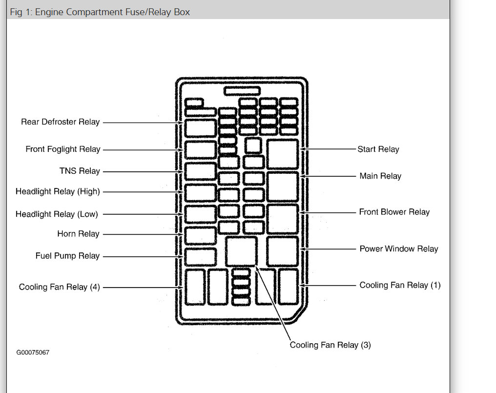

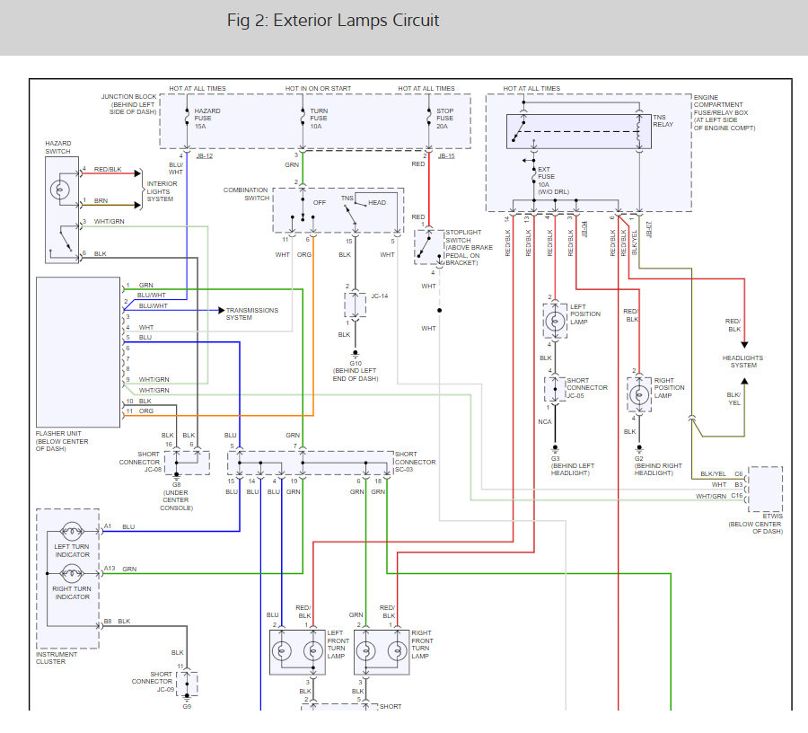

These problems are not related. we will handle the parking light issue on this thread. you will need to start a new thread for the door ajar problem. It sounds like the TNS relay is stuck on and needs to be replaced. To be sure here is a guide so you can test the relay with the relay location along with the wiring diagrams so you can see how the system works:
Check out the diagrams (below). Please run this test and get back to us.
