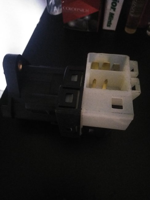

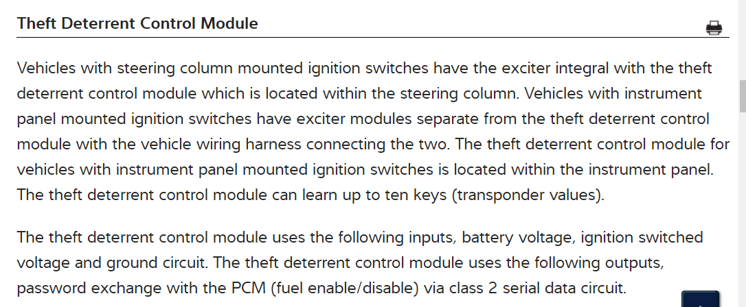

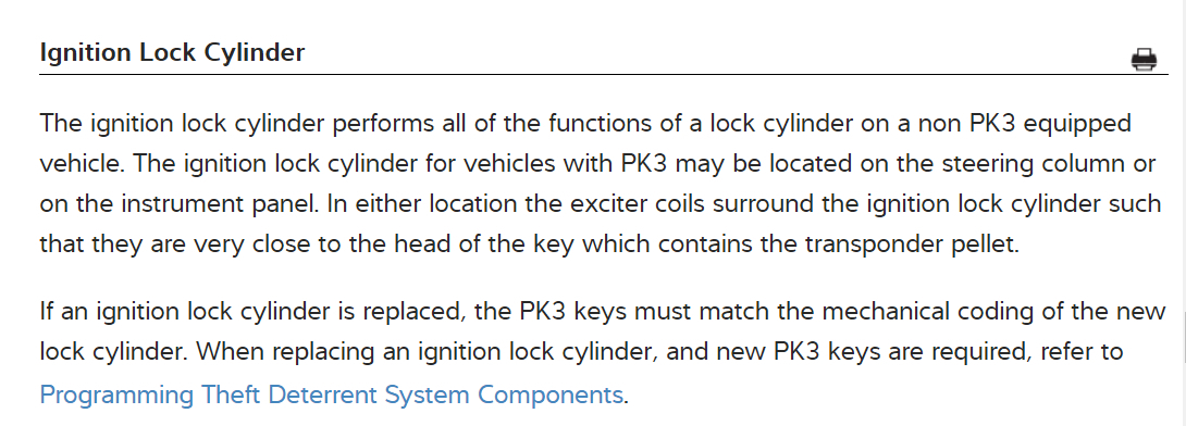

All lights come on fuel pump comes on battery good. I replaced the ignition housing but not the switch the key actually goes in. But still nothing. Please help, desperate, Donna.
Friday, May 24th, 2019 AT 2:09 PM
20 Replies
SCGRANTURISMO
  • 4,897 POSTS

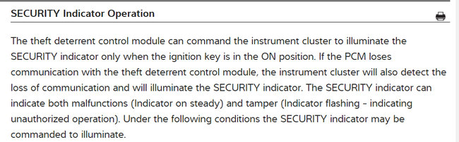

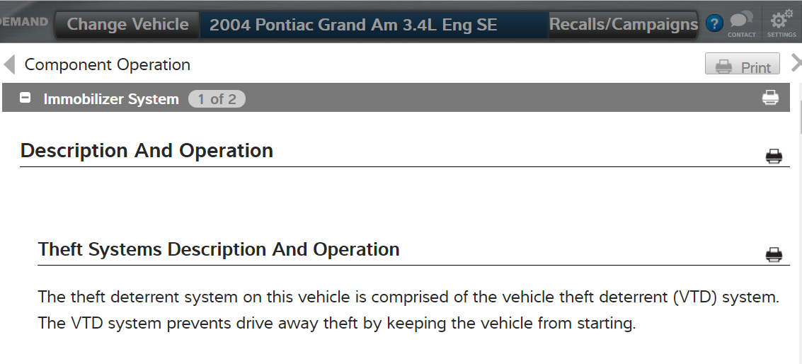

Is your security light blinking?
Thanks,
Alex
2CarPros
Saturday, May 25th, 2019 AT 3:15 AM
DONNAWOODLEE
  • 42 POSTS
No, it's not blinking just stays on.
Saturday, May 25th, 2019 AT 7:37 AM

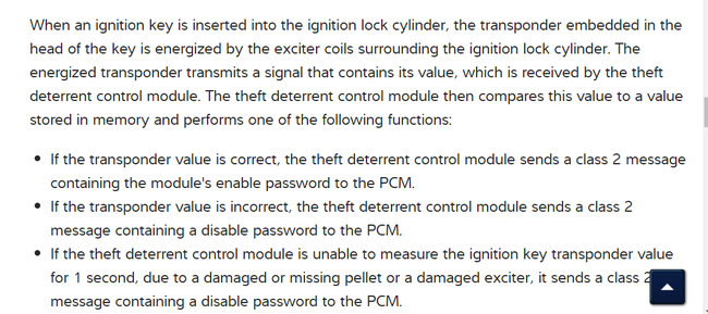

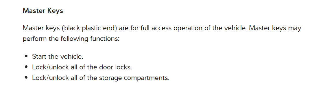

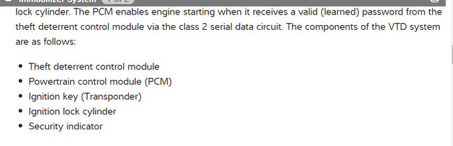

SCGRANTURISMO
  • 4,897 POSTS

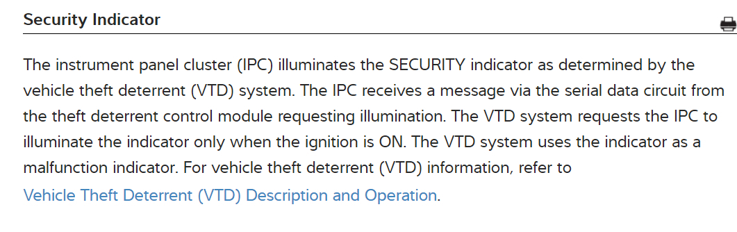

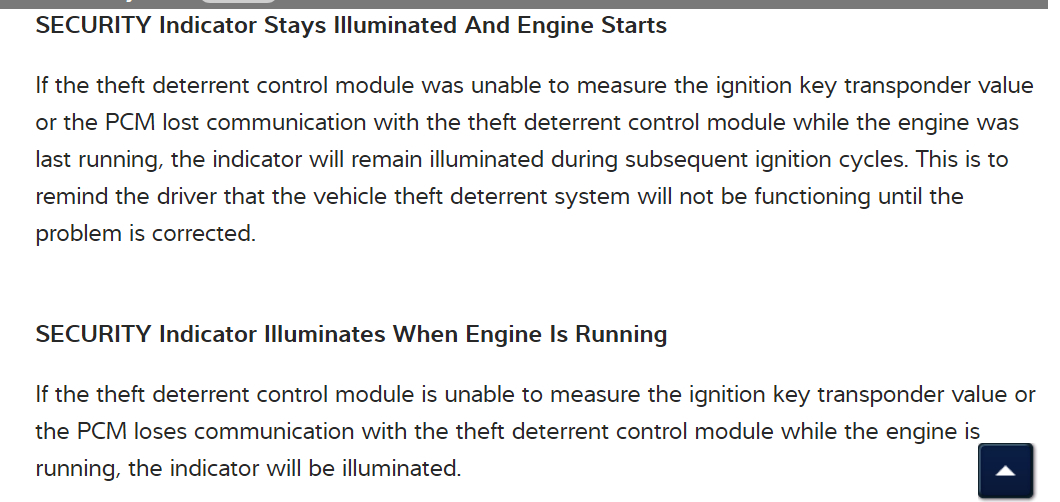

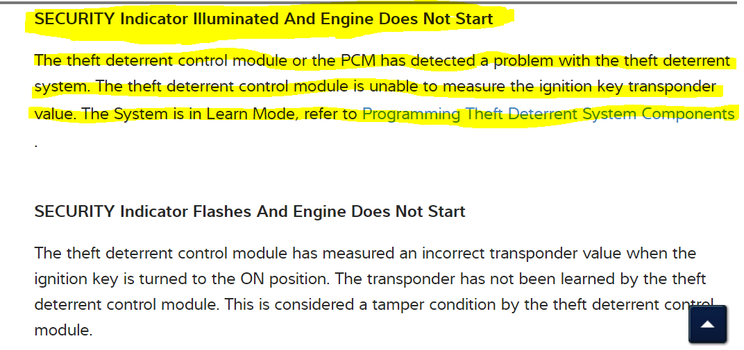

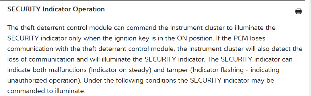

Hello again,

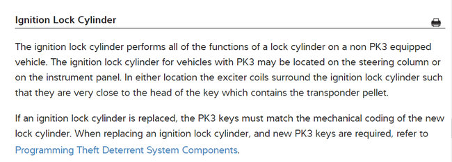

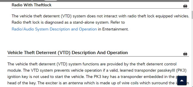

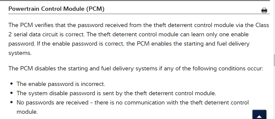

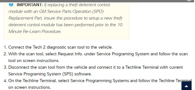

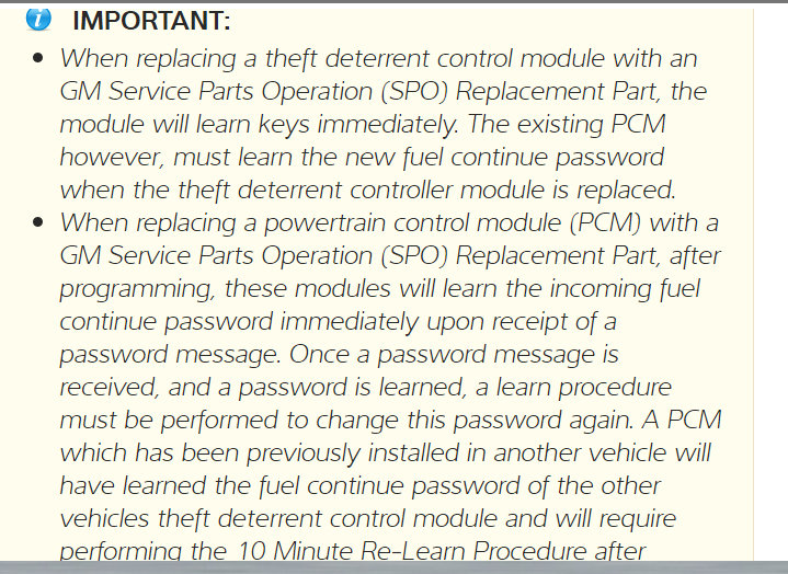

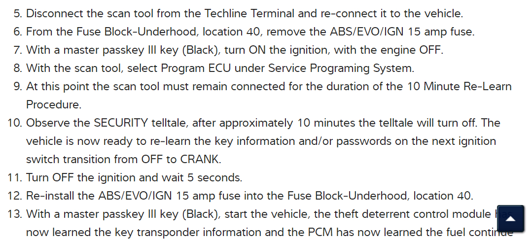

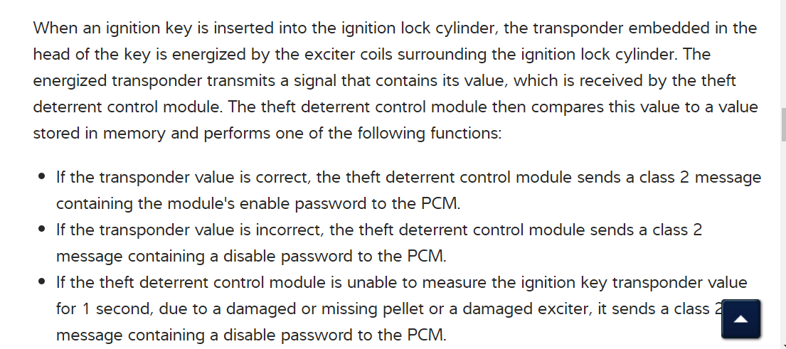

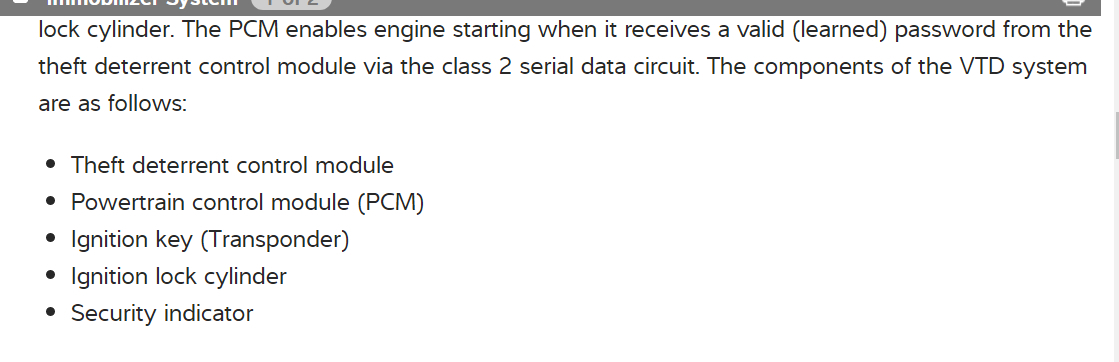

Okay, when your security indicator is illuminated and your vehicle isn't starting that means that a fault has been detected and the system is in learn mode. I have included your vehicle's system operation and how to reprogram it in the diagrams down below. Please go through these guides and get back to us with what you are able to find out.
Thanks,
Alex
2CarPros
Saturday, May 25th, 2019 AT 11:15 AM

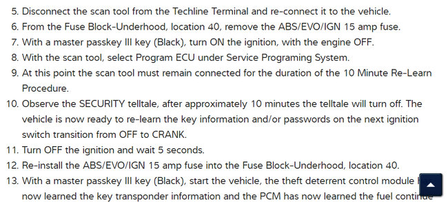

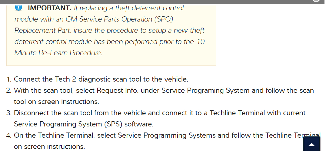

SCGRANTURISMO
  • 4,897 POSTS

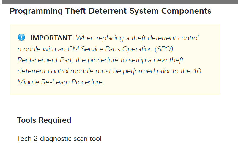

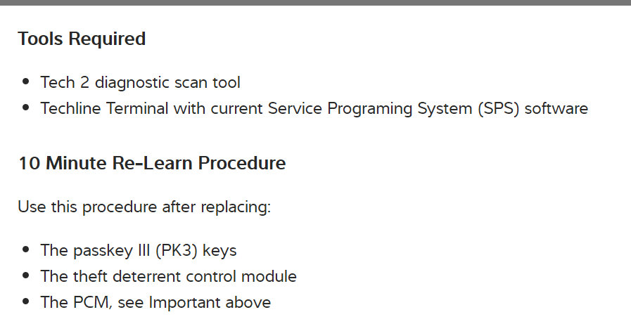

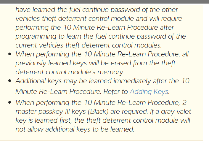

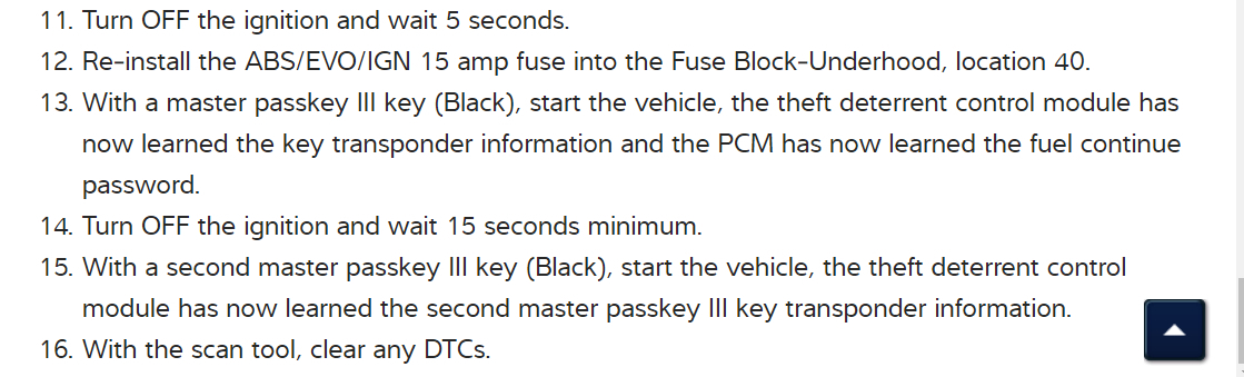

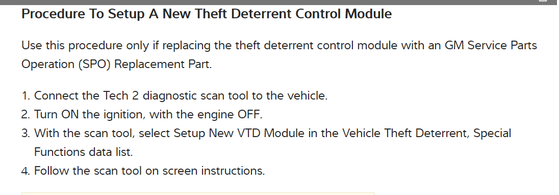

Hello again, read the section that I highlighted for you in yellow. This is what your vehicle is doing. It refers you to "Programming Theft Deterrent System Components", so if you continue down 2 more diagrams, it describes step by step instructions on how to fix your vehicle. It will require the use of a Tech 2 Scan Tool. I believe you can pick one up on Ebay for around $150.00 to $325.00.
Thanks,
Alex
2CarPros
Okay, did you
Saturday, May 25th, 2019 AT 4:48 PM

I don't have that kind of money for a scan tool though.

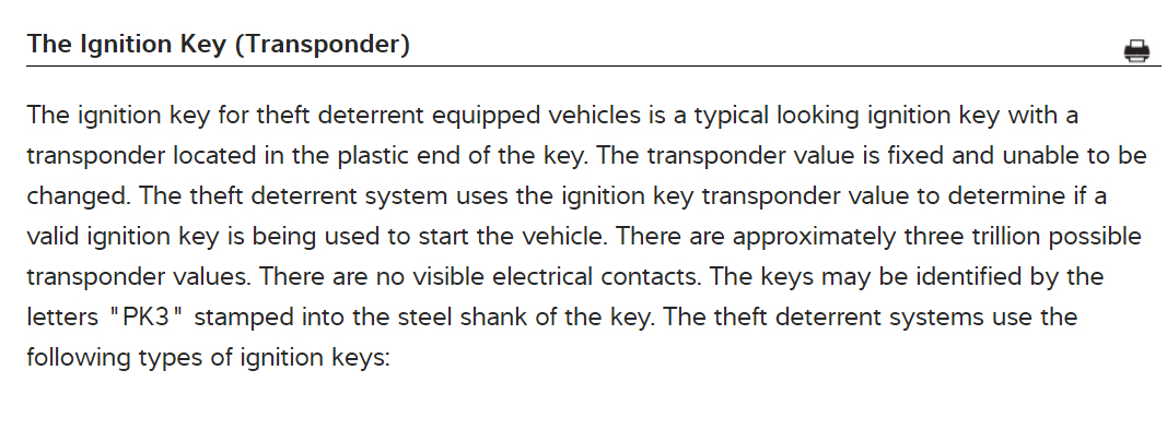

SCGRANTURISMO
  • 4,897 POSTS
Hello again,

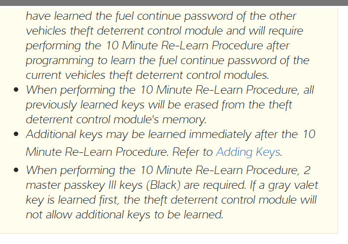

Usually the only place to get your key, or in this case, the new component that you installed, programmed to match up with the PCM is either the dealership or at a locksmith's. This is done intentionally to keep people from going around with a bunch of blank keys and programming them so that they can steal cars. This is an anti theft system after all. Please let us know what you decide to do.
Thanks,
Alex
2CarPros
Saturday, May 25th, 2019 AT 9:51 PM

SCGRANTURISMO
  • 4,897 POSTS
Hello again,
As I have previously sent you the description of the Vehicle Theft Deterrent (VTD) system operation for your vehicle, the components of the VTD, and directions on how and why the components are programmed with each other, I would refer you back to them. I am sorry, there is no magic bullet that I can offer you to fix this problem. I really wish there was, I would love to tell you if there was, but there isn't. Sorry.
Thanks,
Alex
2CarPros

Okay, when I put new part on everything remained the same as with old part so I took off and put old back on because there was no change at all so therefore I don't think that was the issue. So I'm needing to know what else nay be the problem? I'm sending picture of part I replaced and removed and put old one back on.
