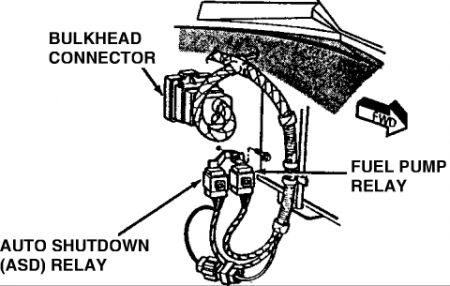

You might also check the ASD and fuel pressure relay. They may be getting hot. They do have a lot of miles on them. I have attached the checks or you could just replace them.
https://www.2carpros.com/forum/automotive_pictures/248015_Fuel_relay_1.jpg
NOTES:
The following operations/tests apply to these relays only: Automatic Shutdown (ASD) and Fuel Pump.
The relay terminal numbers can be found on the bottom of the relay:
Terminal number 30 is connected to battery voltage and can be switched or B + (hot) at all times. Terminal number 87A is connected (a circuit is formed) to terminal 30 in the de-energized (normally OFF) position.
Terminal number 87 is connected (a circuit is formed) to terminal 30 in the energized (ON) position. Terminal number 87 then supplies battery voltage to the component being operated.
Terminal number 86 is connected to a switched (+) power source.
Terminal number 85 is grounded by the Engine Controller.
PROCEDURE
Remove relay before testing.
Using an ohmmeter, perform a resistance test between terminals 85 and 86. Resistance value (ohms) should be 75 ±5 ohms for resistor equipped relays.
Connect the ohmmeter between terminals number 87A and 30. Continuity should be present at this time.
Connect the ohmmeter between terminals number 87 and 30. Continuity should not be present at this time.
Use a set of jumper wires (16 gauge or smaller). Connect one jumper wire between terminal number 85 (on the relay) to the ground side (-) of a 12 Volt power source.
Attach the other jumper wire to the positive side (+) of a 12V power source. Do not connect this jumper wire to relay at this time. CAUTION: Do not allow the ohmmeter to contact terminals 85 or 86 during these tests. Damage to ohmmeter may result.
Attach the other jumper wire (12V +) to terminal number 86. This will activate the relay. Continuity should now be present between terminals number 87 and 30. Continuity should not be present between terminals number 87A and 30.
Disconnect jumper wires from relay and 12 Volt power source.
If continuity or resistance tests did not pass, replace relay.

1. THERE ARE KNOW DTC CODE
2. REPLACE AUTO SHUTDOWN
3. REPLACE FUEL PUMP RELAY
4. REPLACE FUEL PRESSURE REGULATOR
5. MECH STATED THAT BULKHEAD CONNECTOR CAN NOT BE REPLACE
6. PICK UP VAN ON FRIDAY NIGHT AND ENGINE STALL ON SAT 30MIN LATER RUNNING LIKE A NEW CAR
THIS IS WHAT MY MECH THANKS
NOT A FUEL PROBLEM MECH SAID HE THANKS IF IT WERE COMPUTER WE WOULD LOSE BOTH FUEL AND SPARK MECH STATED IT WOULD NOT DIE ON HIM BUT WOULD NOT START ONE MORNING. STILL HAD FUEL PRESSURE

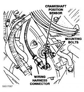

Was the crank sensor checked
also the coil was famous for it failures
