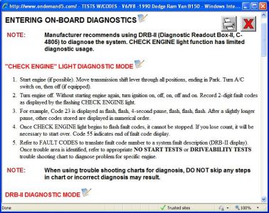

https://www.2carpros.com/forum/automotive_pictures/416332_1990_dodge_van_code_retrival_1.jpg
When you say it will crank but not turn over do you mean the starter will turn the engine over but the engine won't start?Also i need to know what model van you have and what size engine you have.Also i posted how to get any trouble code's your van might have if you could please see if you have any and if you do what the code number's are.

So did you check spark and have none when it doesn't start?Also have you checked to see what fuel pressure is when it doesn't start?Have you checked for code's?I posted how to check for them. Let me know.
