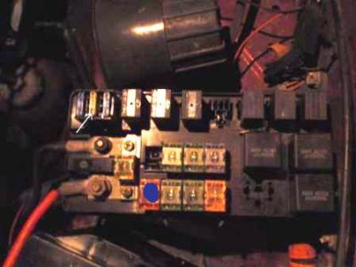

https://www.2carpros.com/forum/automotive_pictures/485513_fuse_Box_3.jpg

I'm glad that's over, your radio should have an in-line fuse you may want to check for under the dash, or you may have to pull the radio out.

Yeah and thanks for your help. The yellow fuse with the arrow by it keeps blowing and the horn and radio are out. I'll try replaceing the horn relay and see if that fixes the blown fuse problem

Most likely the horn has shorted it is no good, remember I told you what that circuit goes to, your air-conditioning pump your horn and one more thing I can't remember. Don't forget to give me a vote.

So replace the horn itself? Or the relay?

I will try to make it simple for you, disconnect the horn and if the fuse does not blow it is the horn, if the fuse continued to blow, reconnect the horn and disconnect the AC compressor, it the fuse does not blow then it is the A/C compressor. Let me know what you find out.

I'm such a moron ! Fact! Where is the $#%$& HORN?

The horn is located underneath the right front bumper
