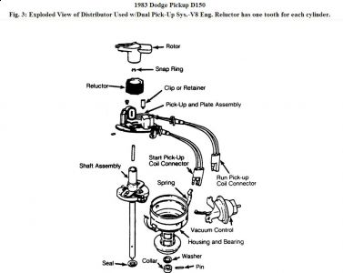

only thing I havnt replaced is the distributor pickup becuase i'm not sure how to get it out of there. I removed two screws from plate but something else that I cant see is still holding it down. I also have not replaced starter relay just because.

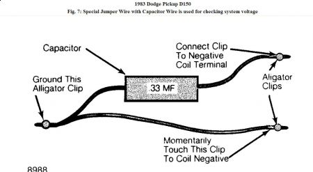

These would be among the possible causes if "no spark". What muddies this up is so many parts were replaced. If you run into a bad part out of the box, you may have a new source for a no start.]

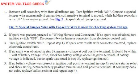

No spark at the coil. I have voltage on the coils + terminal though?
+5

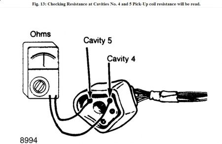

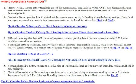

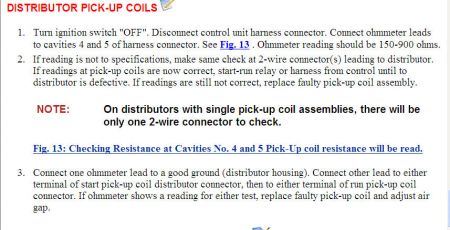

Here are some test procedures that may help.
https://www.2carpros.com/forum/automotive_pictures/30961_d150_1.jpg
https://www.2carpros.com/forum/automotive_pictures/30961_d1507_1.jpg
https://www.2carpros.com/forum/automotive_pictures/30961_d1501_1.jpg
+4
Monday, October 26th, 2009 AT 5:15 AM

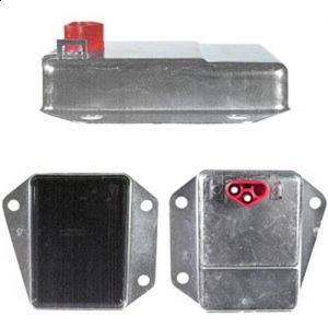

Hey I was just about to perform all of the recommended steps and noticed something on the fire wall very rusty with a hole in it. Turns out it is a voltage regulator?
https://www.2carpros.com/forum/automotive_pictures/426004_vr733_2.jpg
Could this have anything to do with the no spark issue?

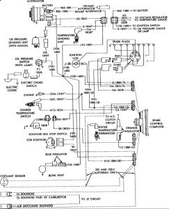

Maybe.
https://www.2carpros.com/forum/automotive_pictures/30961_d150_2.jpg
+16
Monday, October 26th, 2009 AT 2:23 PM
RALPH0470
  • 8 POSTS
Thank you for the wiring diagram. Is there any way you can provide a larger image. I tried to resize but it is very blury and I cant make anything out.
If this is not an option please provide the source and I'll try to retreive it.
Thanks again,
Ralph

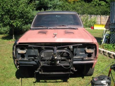

https://www.2carpros.com/forum/automotive_pictures/30961_30961_truck1_1_1.jpg
COOL Hood Ornament!
Been a long time..LOL
Snow is coming, gotta that plow on her soon....
