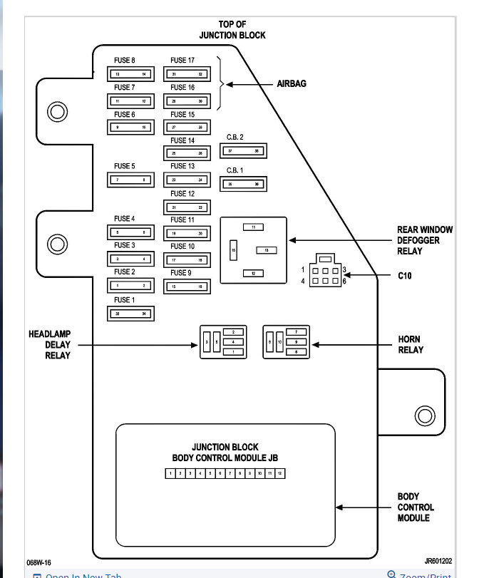

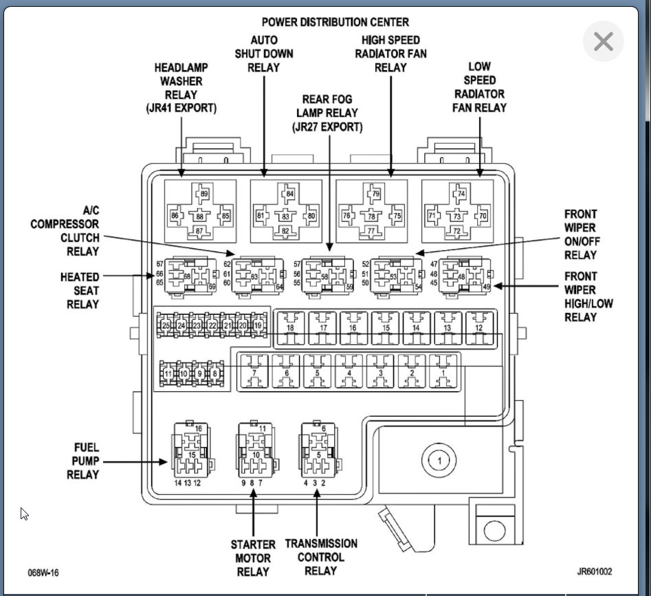

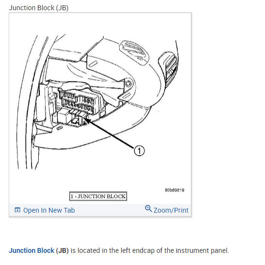

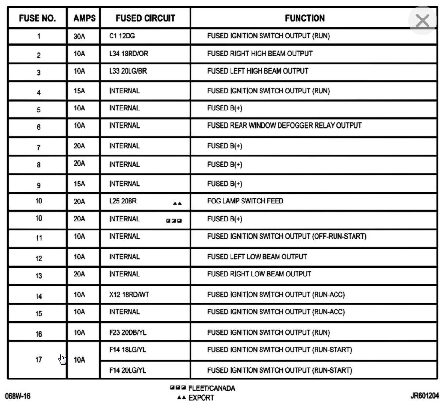

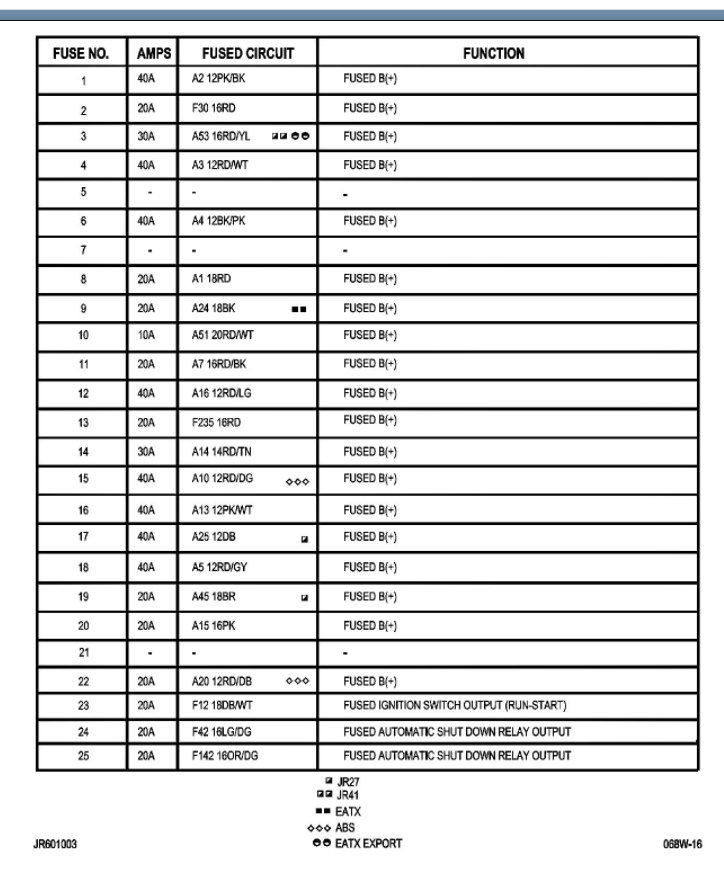

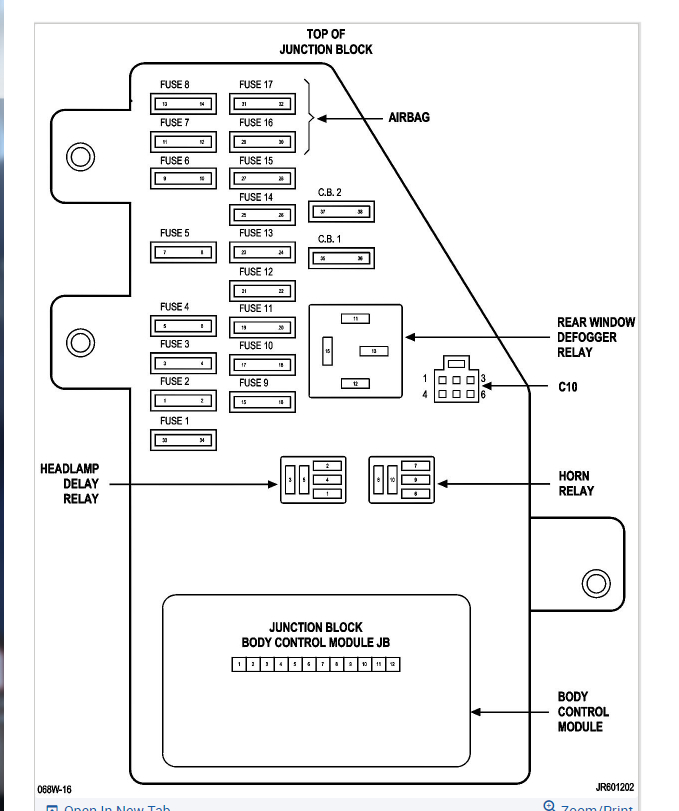

Where the fuses are and what do they power?

I am attaching the info you requested below.
Here is a guide that will help with testing and replacing fuses if you need this as well:
Below is the diagrams of the fuses boxes. Thanks
